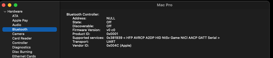

Bluetooth is pooched as well. This cMP has the updated BT4LE and Wifi card from a later iMac that was working fine in 11.5 beta 3 and 12.0 beta 1 but is now MIA.
Cannot be switched on. WiFi and Ethernet are working OK.
Sytem Infomation Hardware Bluetooth shows this:

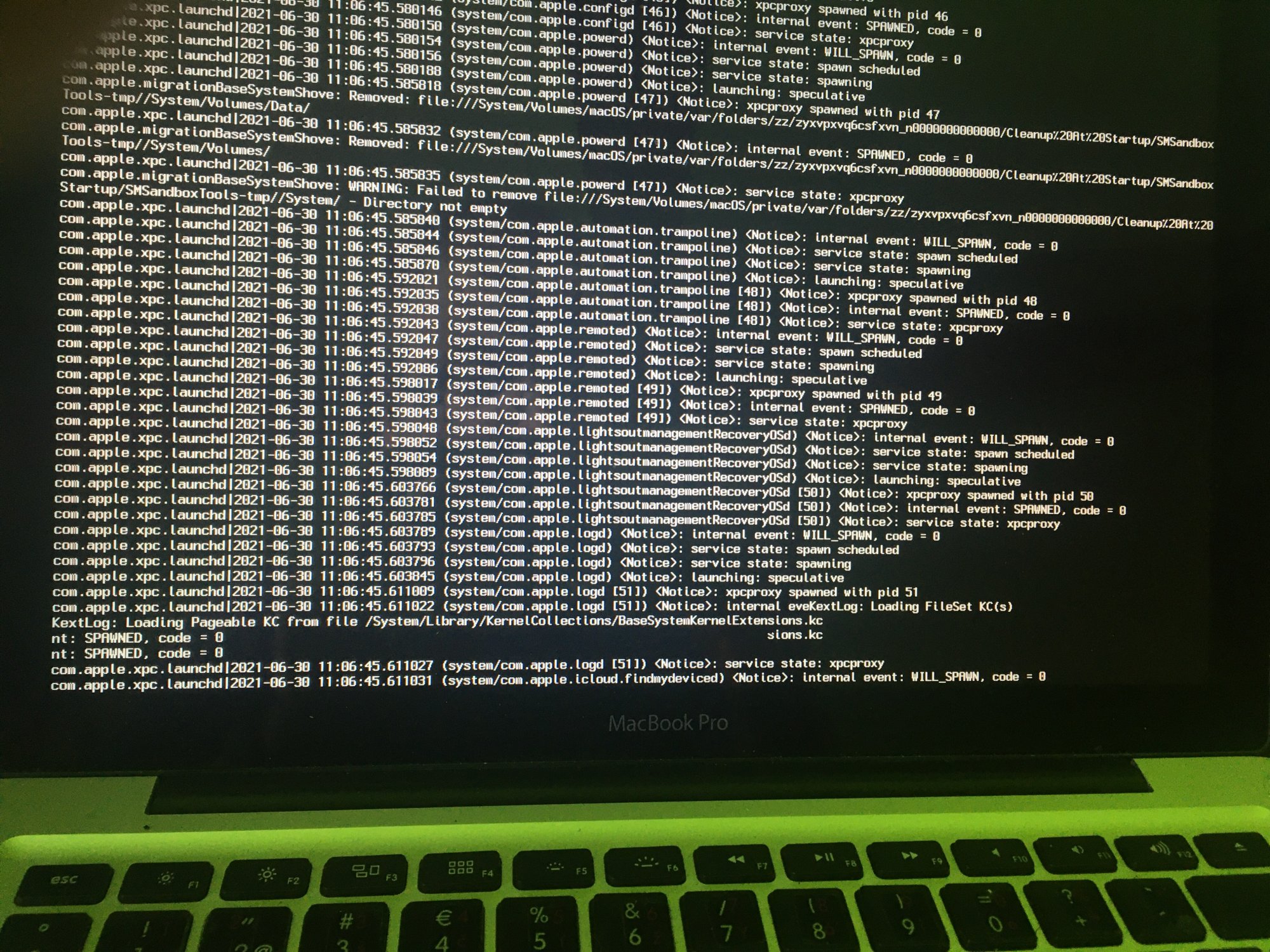

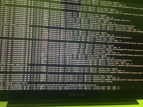

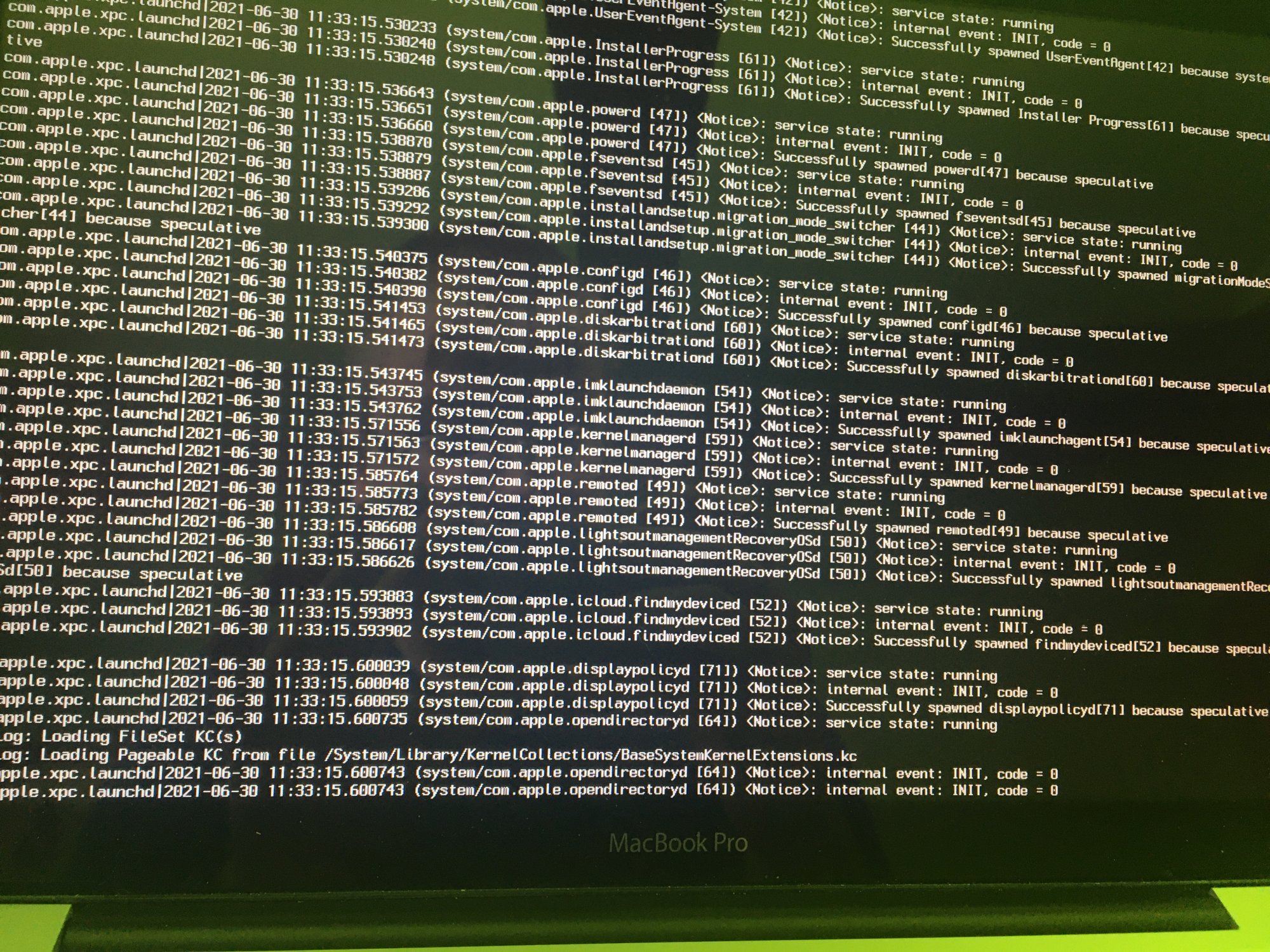

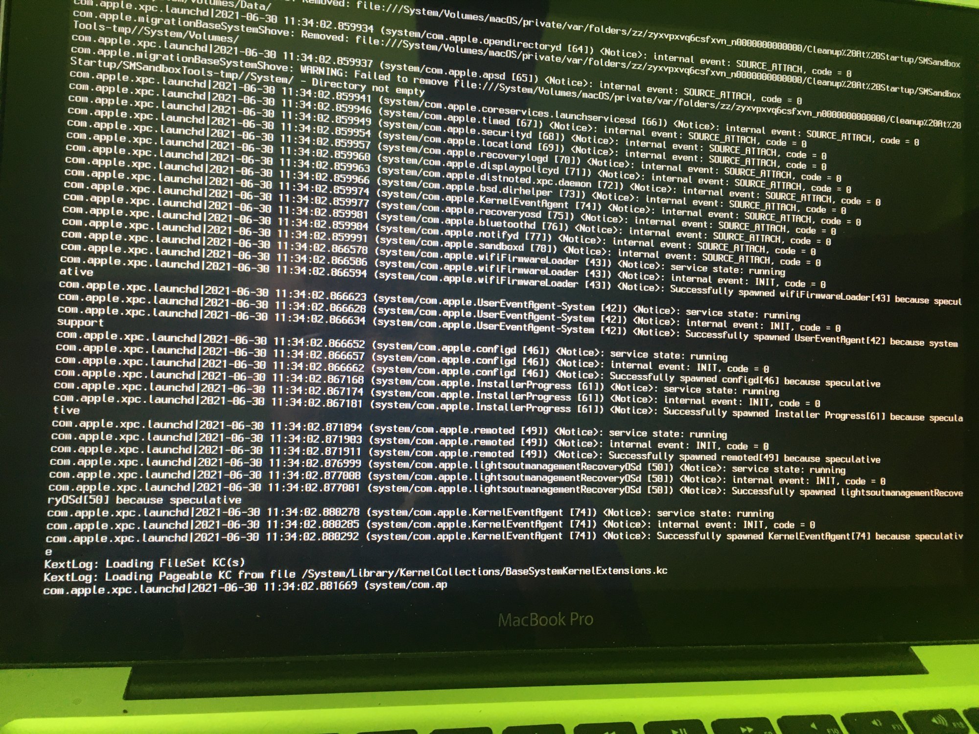

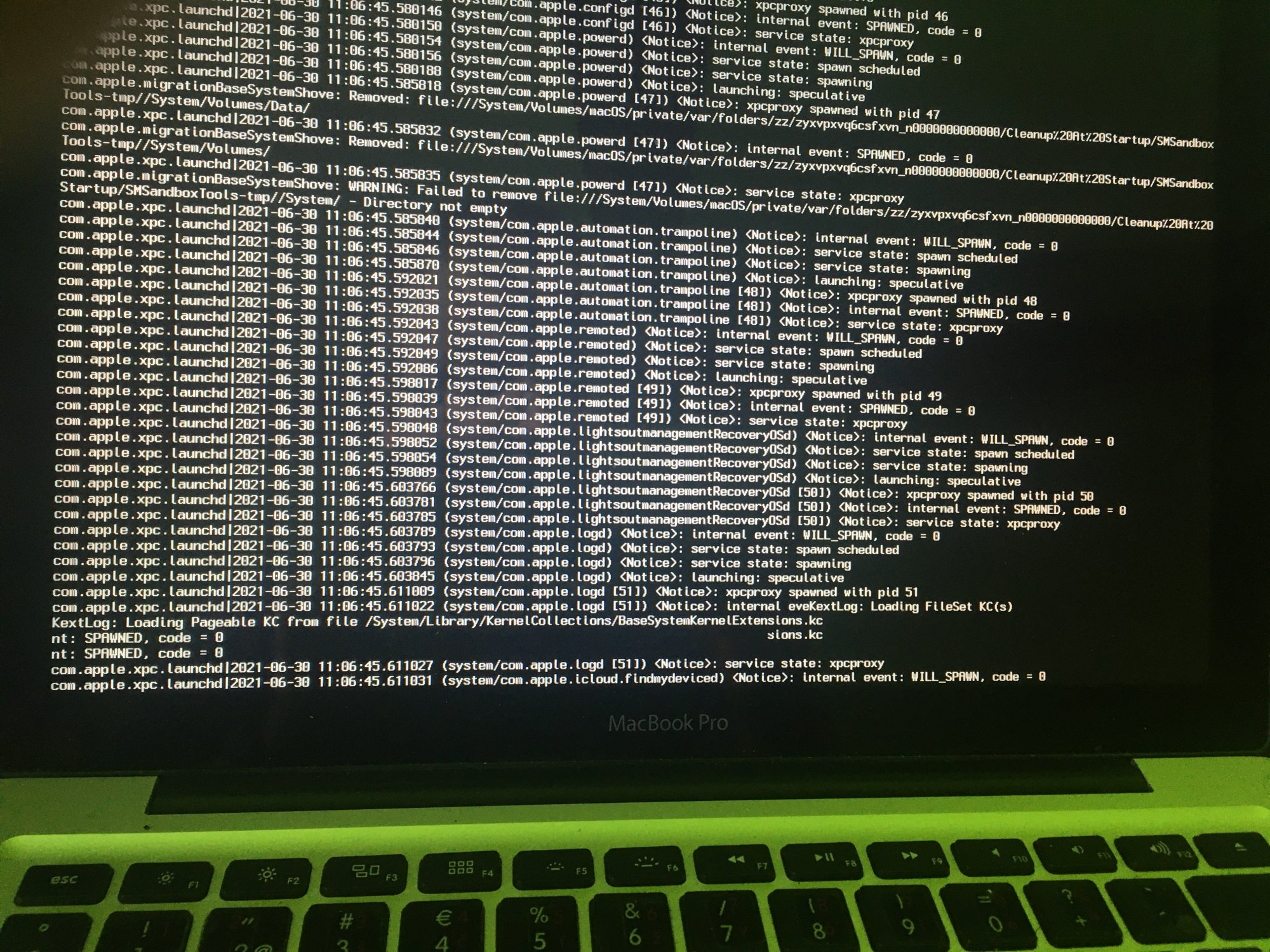

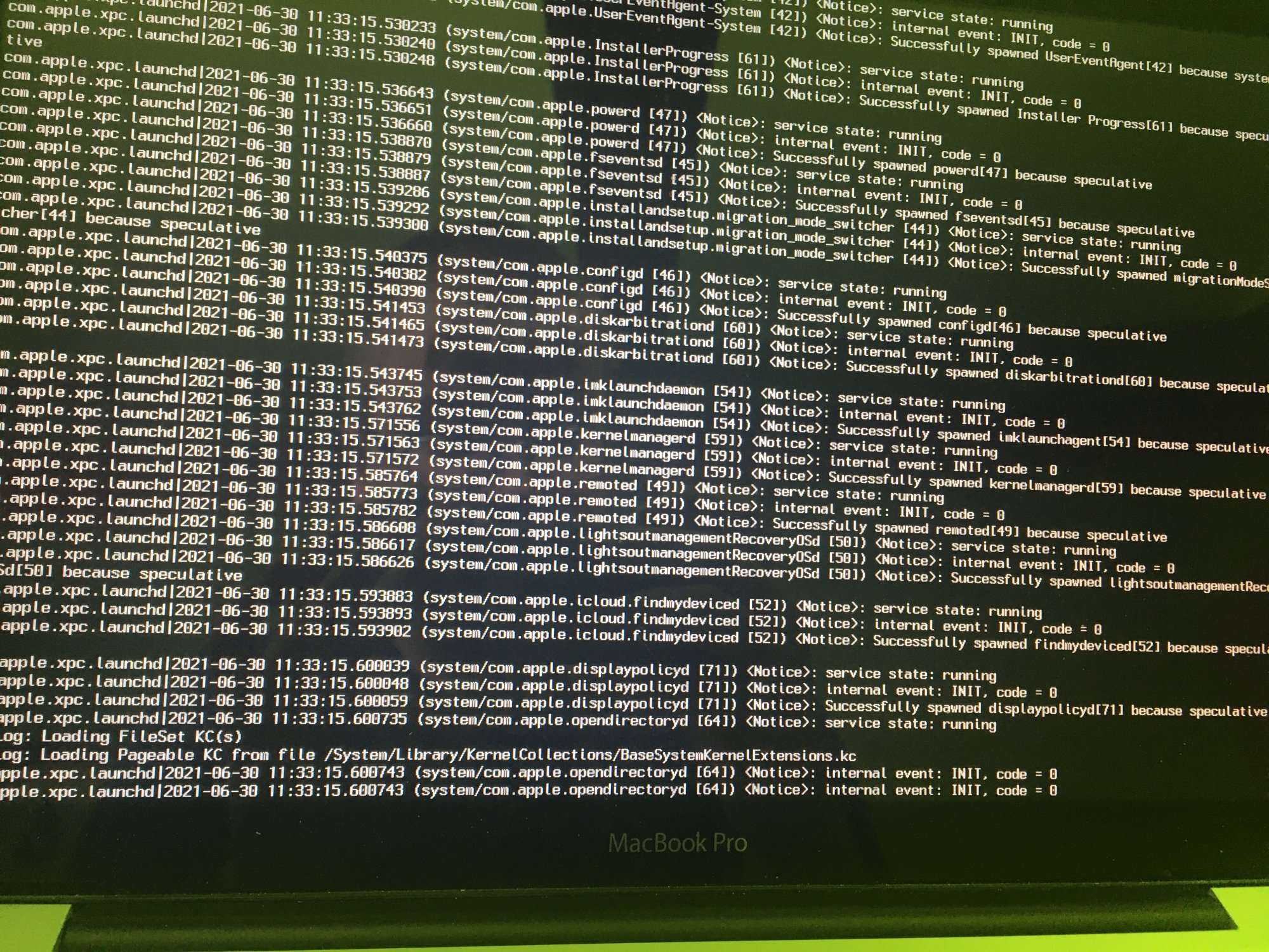

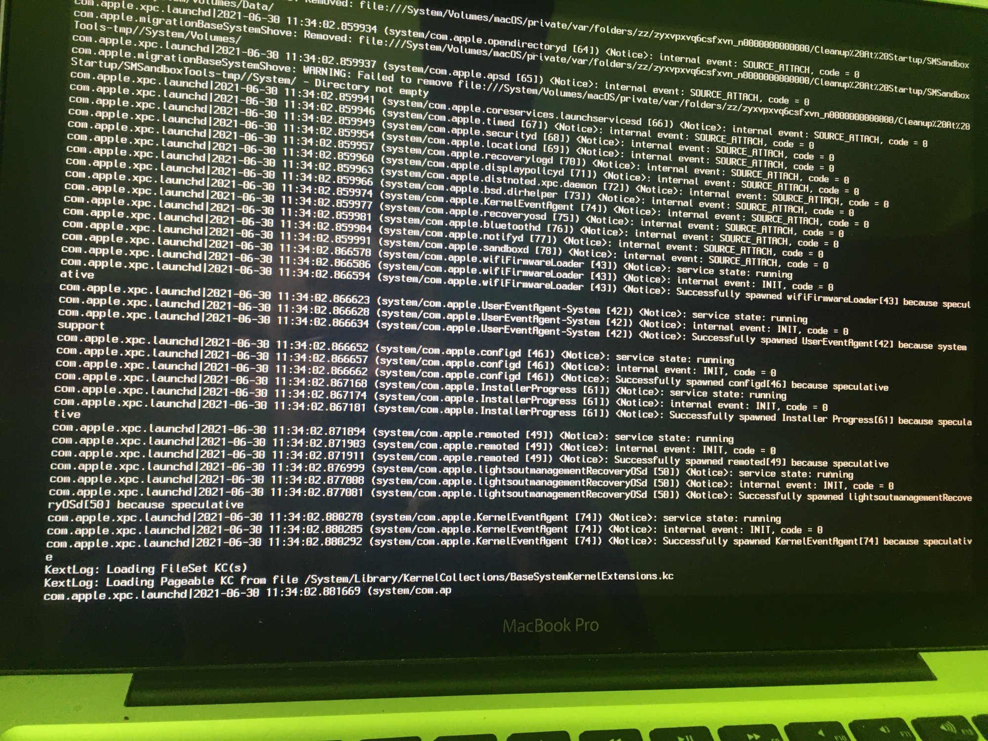

Hi everyone! How to fix this? I have installed Monterey B2, restored from Time Machine and then… Micropatcher booting results in failure(this is verbose from that) and booting with OCLP causes bootsplash to hang on 1/3. Before restoring of backup everything worked fine. I suspect that there is some sort of conflict between BS and MT services.
I am able to boot to single user mode.
NOTE:each time I boot it, output is different.
Try a clean install rather than restoring from Time Machine.
I know! It works, but I would like use my data there. I need a hint what’s causing problems.
TM restore worked fine when I moved to BS from Catalina.
Upgrade from BS with USB stick results in failure.
What to cut from backup restore?

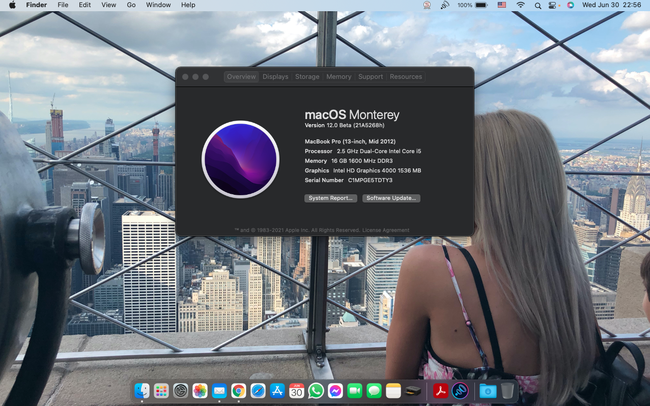

Hi guys! Just finished updating my MBP 9,2 non-retina, HD4000 to macOS Monterey Beta 2 using the OCLP 0.2.2 GUI patcher. Just wanted to state that even though I have installed on June 7th the Monterey developer profile on my MBP, I am not seeing the updates on System Prefferences like it was suppose to... Since June 17th, I no longer have access to the developer downloads since I haven't renewed my subscription, so I can re-install the profile 🙁 Anyone else seen this issue? Thank you guys for all your help and support!
Same here, initially: BT missing after beta2 update on cMP3,1.
Did NVRAM reset and re-installed 0.2.2 OCLP (which was already on that machine before 12b2 Monterey update).
BT shows up again and is usable.
Reactions: SparkX
Is there anyone who performed clean install of Monterey and restored Time Machine backup? Or installing from USB over BS installation? Does that work for someone?
That doesn't work. You must use migration assistant as far as I know.
Install from USB over existing BigSur is working.
Yeah, I meant Migration Assistant. It restores from TM backup.(results in Kernel Panic after reboot)
And reinstall with USB on top doesn’t work at all.
Use OCLP 0.2.2 . Make bootable USB drive . Install OC on it. Boot with option then to EFI. Then install over existing BS. Should work. Read "readme" of OCLP.
Thanks! Will try. I was just getting error in half of the first stage.(Failed to prepare update or something, will post screenshot if it does not start) Clean installation worked.(Migration Assistand ruined system afterwards)
