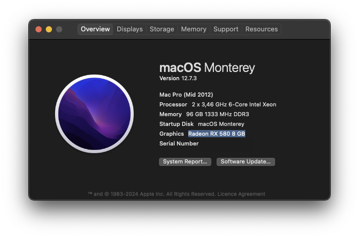

The Problem I face is that I can boot into my non-OCLP Mojave macOS, but all other OCLP macOS's give met black screens.

Thank you for your offer, greatly appreciated. As I was expecting a much easier transition from the GTX 680 to the RX 580 after injecting EnableGOP, the RX 580 worked on my other macOS's before.

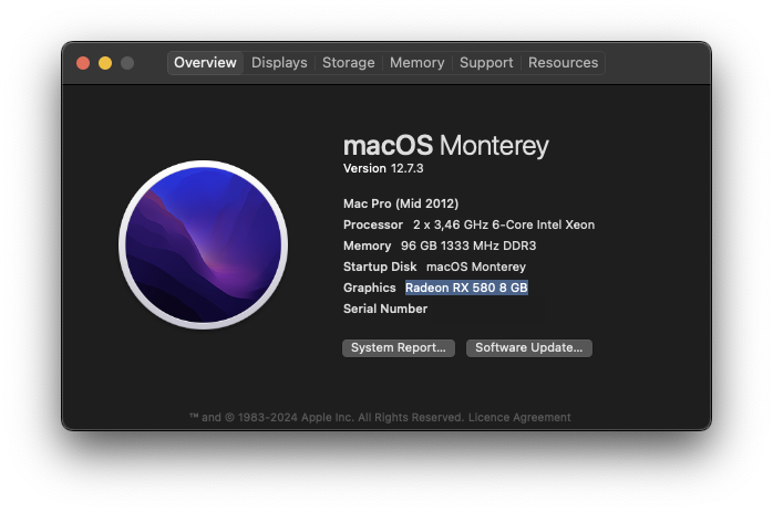

So I've decided to put a hold on this head scratching project to me for now. Need some more clear headroom for this.
Keep you posted when I'm ready to move forward. Cheers.

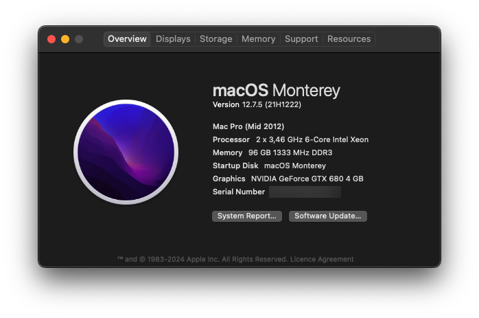

MacPro5.1 from the signature. macOS 12.7.5 (21H1222) - OCLP 1.5.0
In app Updating from OCLP 1.4.3 to 1.5.0 -> Install in EFI -> Install Legacy Wi-Fi Patch (Broadcom BCM43xx ) -> Reboot = Everything is fine, and there seem to be no problems.

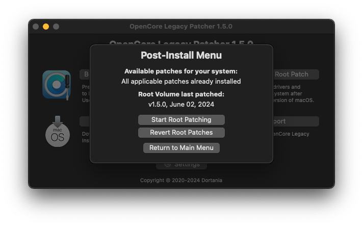

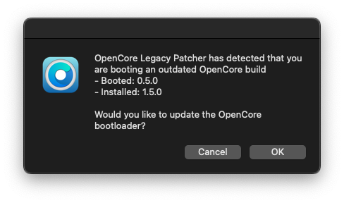

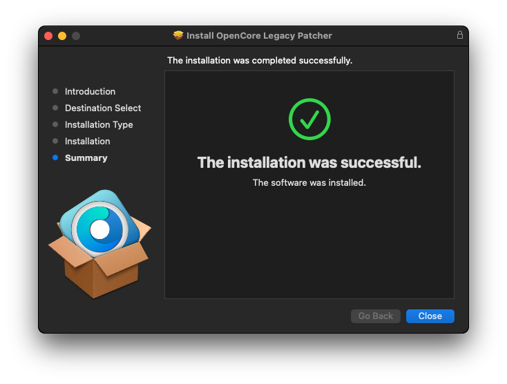

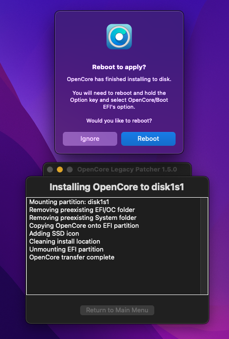

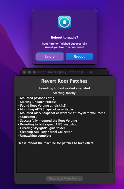

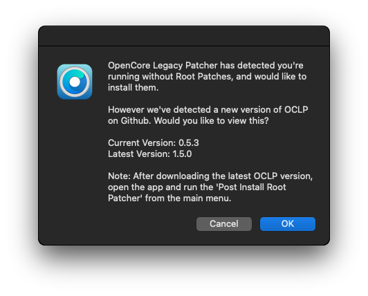

Manned my battle station and updated macOS Monterey to 12.7.5 using OCLP 0.5.3. During this process, I came to realize my system was some kind of OCLP galore:
1. Update to macOS 12.7.5 => root repatch with OCLP 0.5.3 = big mess no Wifi / Networking etc.
2. Undo post-install root patches and reboot:
2. Downloaded the new OCLP 1.5.0 installer package:
3. Rebooted
4. Updating bootloader
5. Post-install root patching
Happy to have successfully updated macOS 12.7.5 and upgrading to OCLP 1.5.0. Nice practice for updating my other macOS Ventura and Sonoma SSD's.
Thanks to Mr. Macintosh + OCLP Team / Jessie's Flying / MacRumors :cool:
