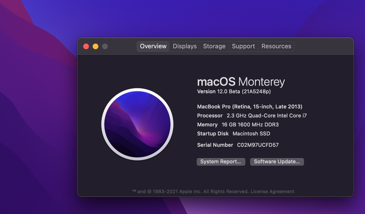

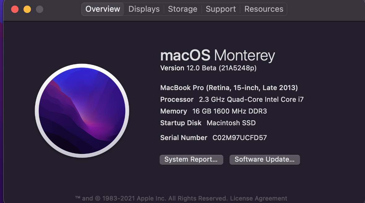

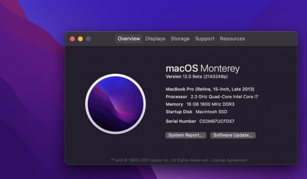

used bigsur micropatcher and create install media method, works fine on MBP 11,3 Late 2013.
