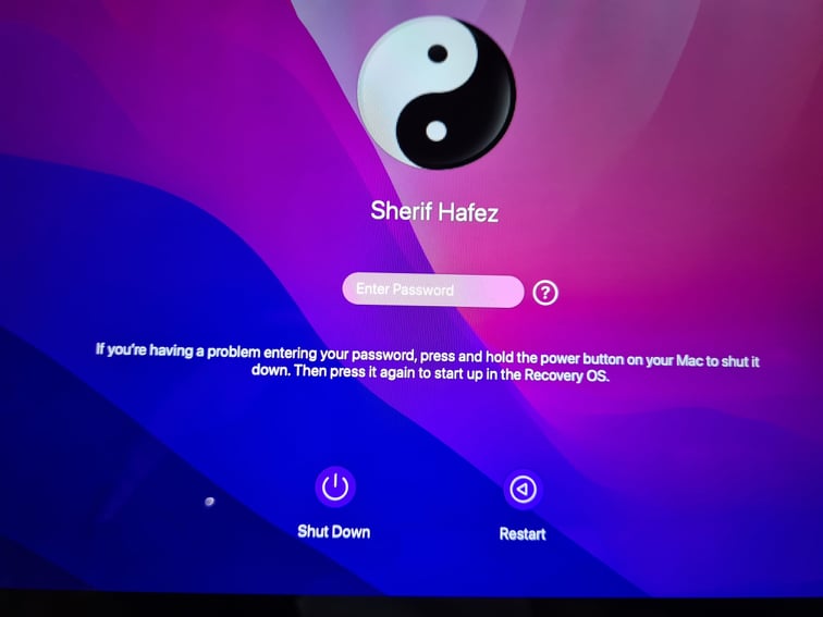

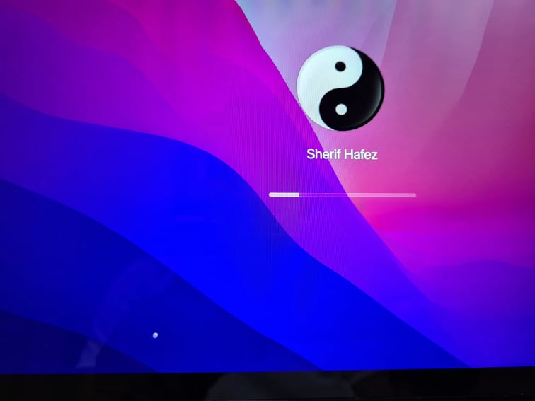

Has anyone seen this, I got the following on boot then the os starts to boot as in the second image after a clean install.
how do I get back the normal black boot screen?,
It cannot be a clean install since there is already a user configured.
This happens after mistyping a password three times in a row.
Follow the on screen instructions to reset your password.
  1. boot into opencore
  2. hit spacebar to see the recovery partitions
  3. boot into the Big Sur recovery
  4. open terminal app
  5. enter resetpassoword command
and follow the instructions to reset your password
or just disable shift 🙂
This is not the case, The first image is a boot login screen and after entering the correct password the the os starts to boot as in the second image.
