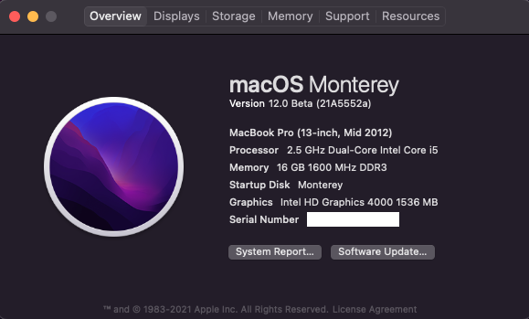

MBP 9,2: Updated to beta 10/21A5552a via software update. Download 10min. Prepping 30min. Installation went rather quick 15min. Reboot did stop halfway. No signs of any progress. Pressed/held power button and rebooted again. Booted normally. Applied patches using OCLP 0.2.5. Reboot. Done.
Thank you!

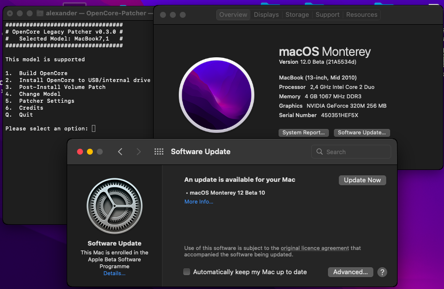

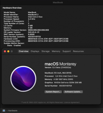

This is my experimental second ssd drive.
I will watch movies🎬

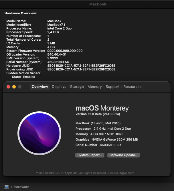

2012 Macbook air upgraded just fine to beta 10 using 0.3.0.
On the other hand, my poor old white mackbook from 2009, also updated but there is no Bluetooth, not even using the terminal command to kill it and restart.

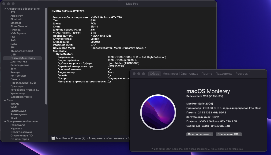

Hi to All!
Successfully updated my CMP 2009 system by the OTA updates. From MacOS Monterey 12.0 Beta9 to 12.0 Beta 10.
System Volume patched for keppler GPU acceleration enable.
OC config - by latest OCLP 0.3.0
Issues - no issues (only crashes useless nvmefix kext on cold boot)
After 20 hours - Works fine, sleep and wake up are normal.
Greate Work guys!
