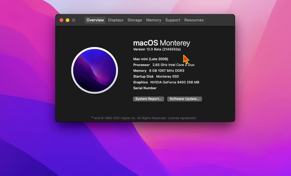

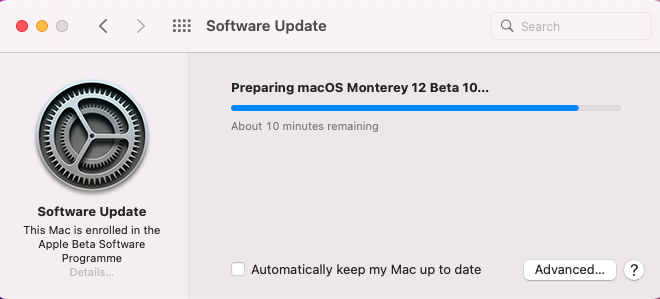

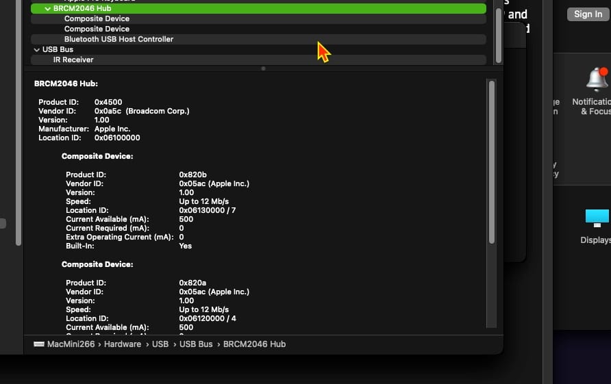

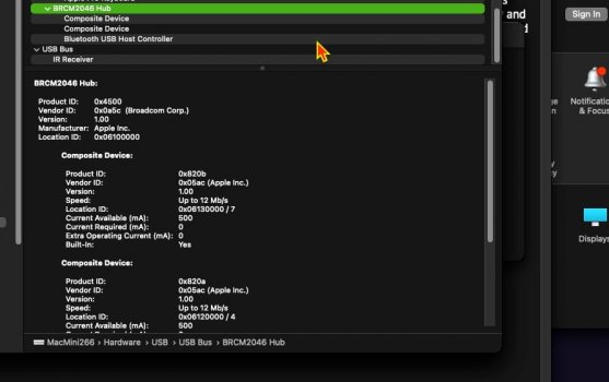

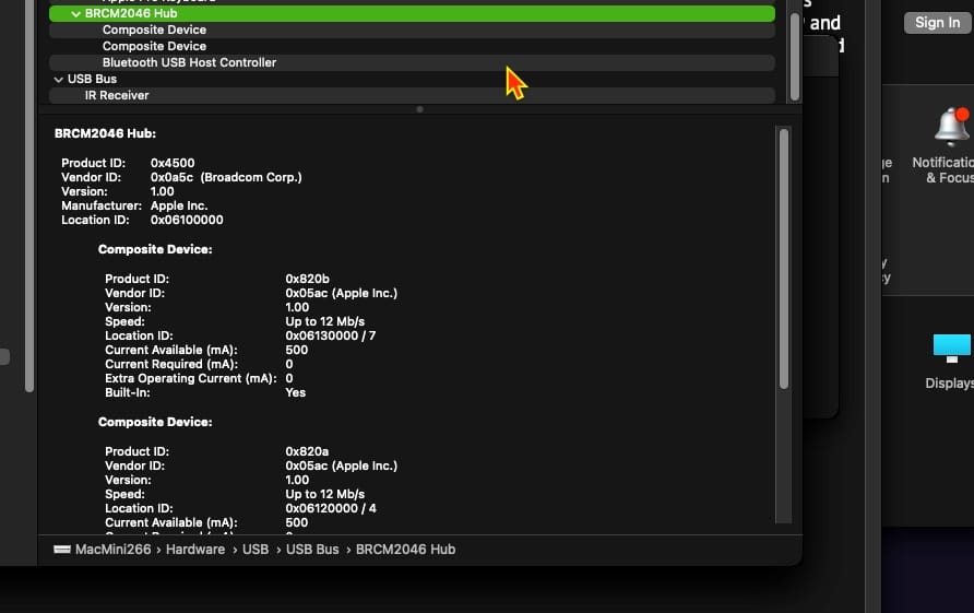

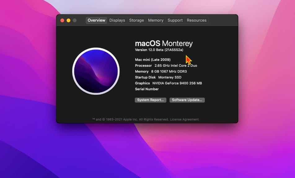

'09 Mini3,1 OCLP_030 Offline Variant installed Beta 10 OTA atop suspect b9, went unattended to boot into Build #21A5552a - applied OCLP Step #3, restart. Promising but Magic Trackpad seen as mouse, Bluetooth C/P reports Bluetooth permanently OFF Trackpad MIA. Not good PITA, :mad: :rolleyes: Magic Trackpad is a lousy mouse. Worked well in b9 and previous. (Noticed Beta 10 B/T driver is for mid-2014 Macs and newer but after a reboot the entry vanished. USB Device Tree reports BRCM2046 using no power.) Wi-Fi works, post-patch. C/Ps are a minefield of "Preferences Error." Fortunately, the over-install grabbed most of the previous version C/P settings. Graphics smooth and crisp exactly like unsupported Big Sur and Catalina. :cool:
A little snapshot upkeep tmutil thinlocalsnapshots / 999999999999999 4 seems to have fixed the crashing apps cascade lockout seen post-b6. :cool:
dead B:T.jpg
'09 Mini3,1 OCLP_030 Offline Variant installed Beta 10 OTA atop suspect b9, went unattended to boot into Build #21A5552a - applied OCLP Step #3, restart. Promising but Magic Trackpad seen as mouse, Bluetooth C/P reports Bluetooth permanently OFF Trackpad MIA. Not good PITA, :mad: :rolleyes: Magic Trackpad is a lousy mouse. Worked well in b9 and previous. (Noticed Beta 10 B/T driver is for mid-2014 Macs and newer but after a reboot the entry vanished. (USB Device Tree reports BRCM2046 using no power.) Wi-Fi works, post-patch. C/Ps are a minefield of "Preferences Error." Fortunately, the over-install grabbed most of the previous version C/P settings. Graphics smooth and crisp exactly like unsupported Big Sur and Catalina. :cool:

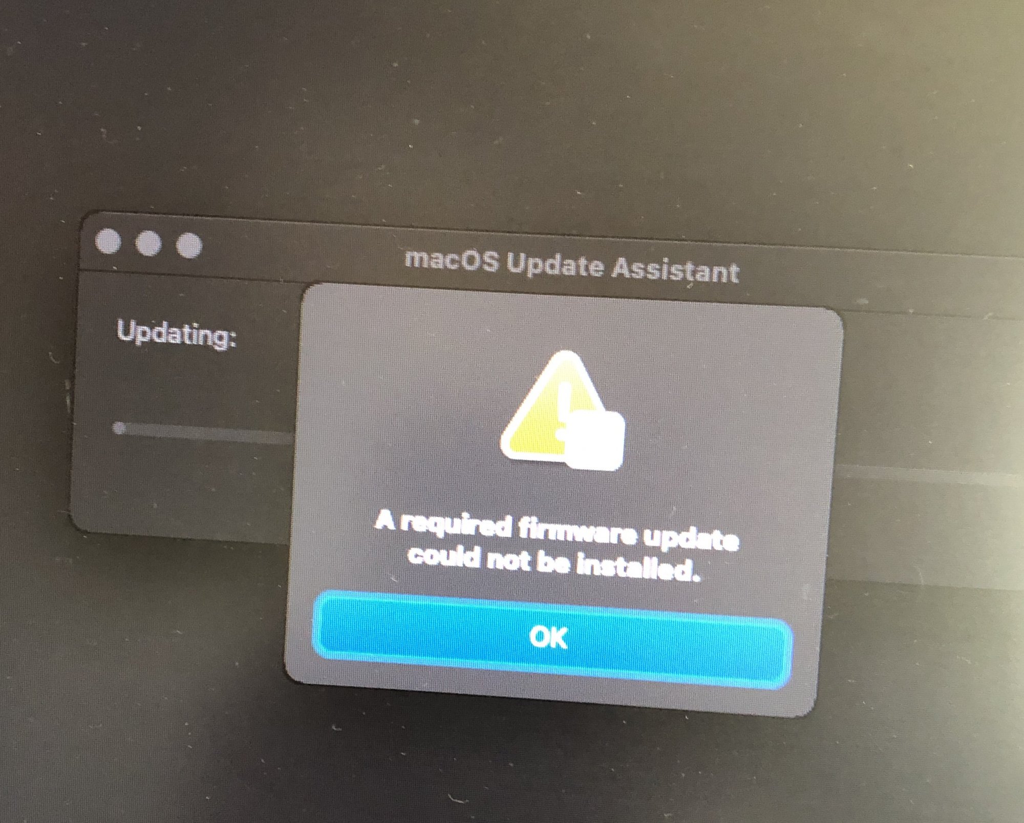

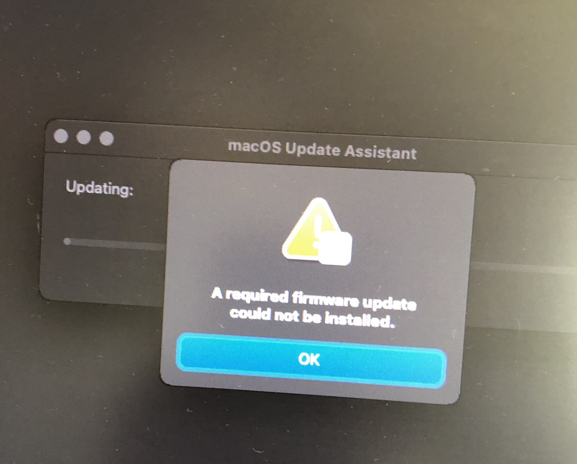

I am having a problem with a full 12.0 beta 10 USB installer built using the most recent 0.3.0 nightly OCP on an erased SSD on a MacPro 3,1.
With about 14 minutes to complete it displays the following screen notifying that a required firmware update could not be installed! It looks to me like there is an issue with the 0.3.0 OCP nightly and this recent beta.

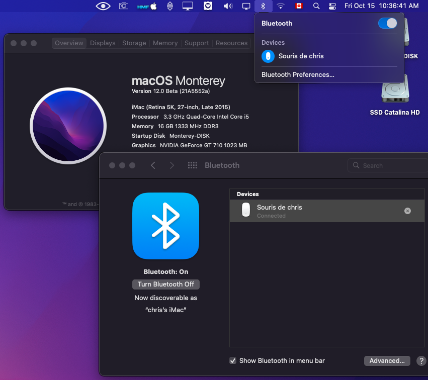

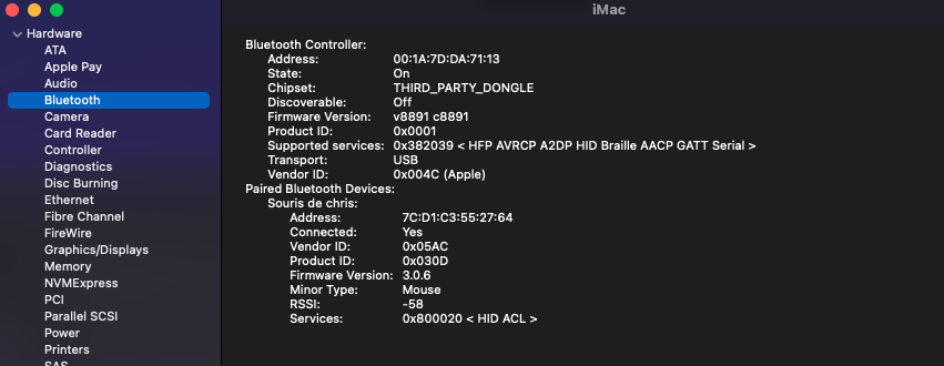

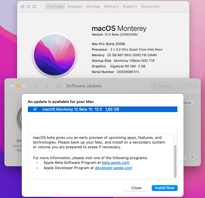

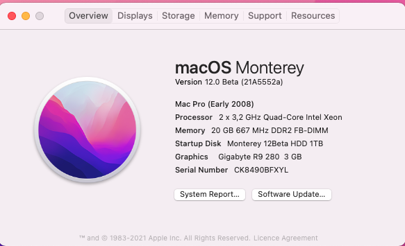

Hi, World update was successful😊MacPro3,1✨
Nightly OpenCore Patcher (TUI) 👍
Thanks to macrumors.com/and all the creator-developers👏👏👏
Hi, did you try to install it on another ssd drive?
NVRAM? Boot-args keepsyms = 1 debug = 0x100 shikigva = 128 unfairgva = 1 agdpmod = pikera -wegtree -v

I've had same error message ( ... required firmware could not be updated) when installing B10 from USB thumb drive with OCLP 0.3.0, and when attempting (thereafter) installation using OCLP 0.2.5. In former case (0.3.0), more then one installation was attempted; each time the Post Install Volume patch was run, it would cause boot process to stall soon after (necessary) reboot.
Had to download Beta 10 full installer onto internal drive with BigSur partition, erase Monterey partition, and then install Beta 10 onto its own partition form BigSur.
Installtion from BigSur partition was successful, however, the OCLP 0.3.0 post install patches would always cause Kernel panic. The OCLP 0.2.5 allowed installation of Beta10, and post install volume patches (after fresh Monterey B10 install)
Still, the display panel in system preferences only shows one [default] resolution and there is no screen brightness adjustment)

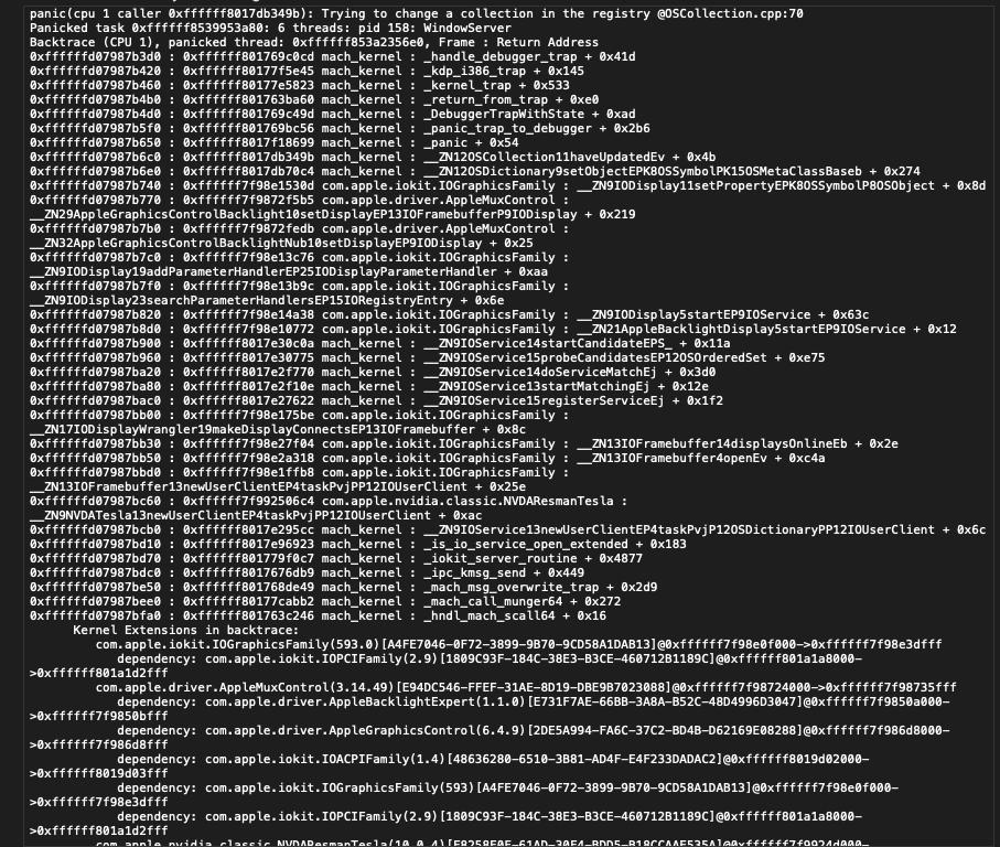

While OCLP 0.2.5 seems to have provided graphic acceleration, it causes Window Server to crush every time an item on the right side of the menu bar is "clicked"; there was no such problem before volume patches were applied (of course there was also no graphic acceleration). The menu bar and dock are not translucent, but window movement across the screen and window minimizing is very smooth).
Just to provide complete background; my first installation, using OTA over beta 9, went well but OCLP 0.2.5 could not invoke graphic acceleration; subsequent application of the OCLP 0.3.0 volume patches, in an attempt to achieve graphic acceleration, resulted in the described issues.
This is a report associated with use of two OCLP variants on my machine, which hopefully may lead to resolution (everyone understands the risks).
Addendum: Monterey Beta10 Window Server currently crashes (randomly) without any "provocation".
***Update 10.16.21:utilizing OCLP 0.3.1 resulted in same problems with window server, see attached:
