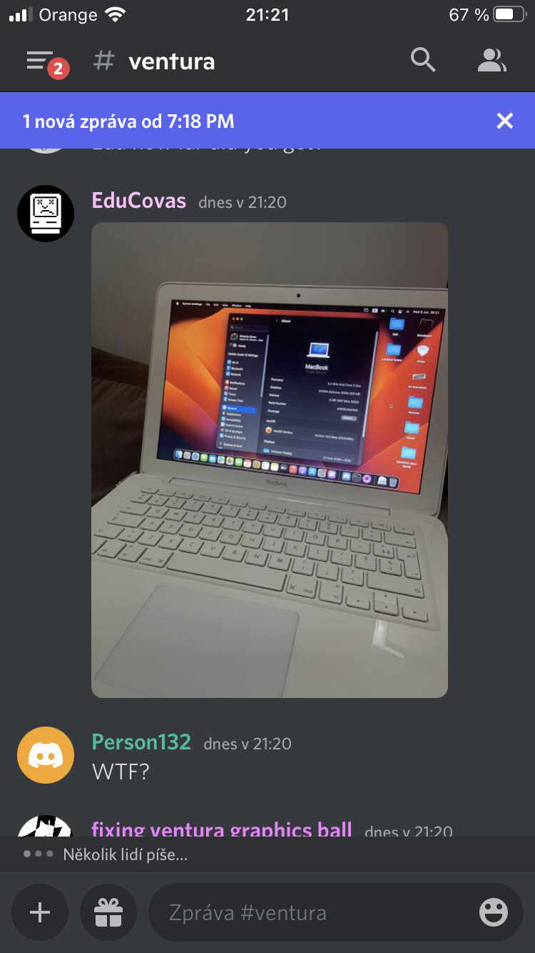

Oh yes, White Penryn Macbook, dammit that’s fast!(Don’t throw your cMPs3.1 away yet.) Arrandale and Sandy Bridge left.

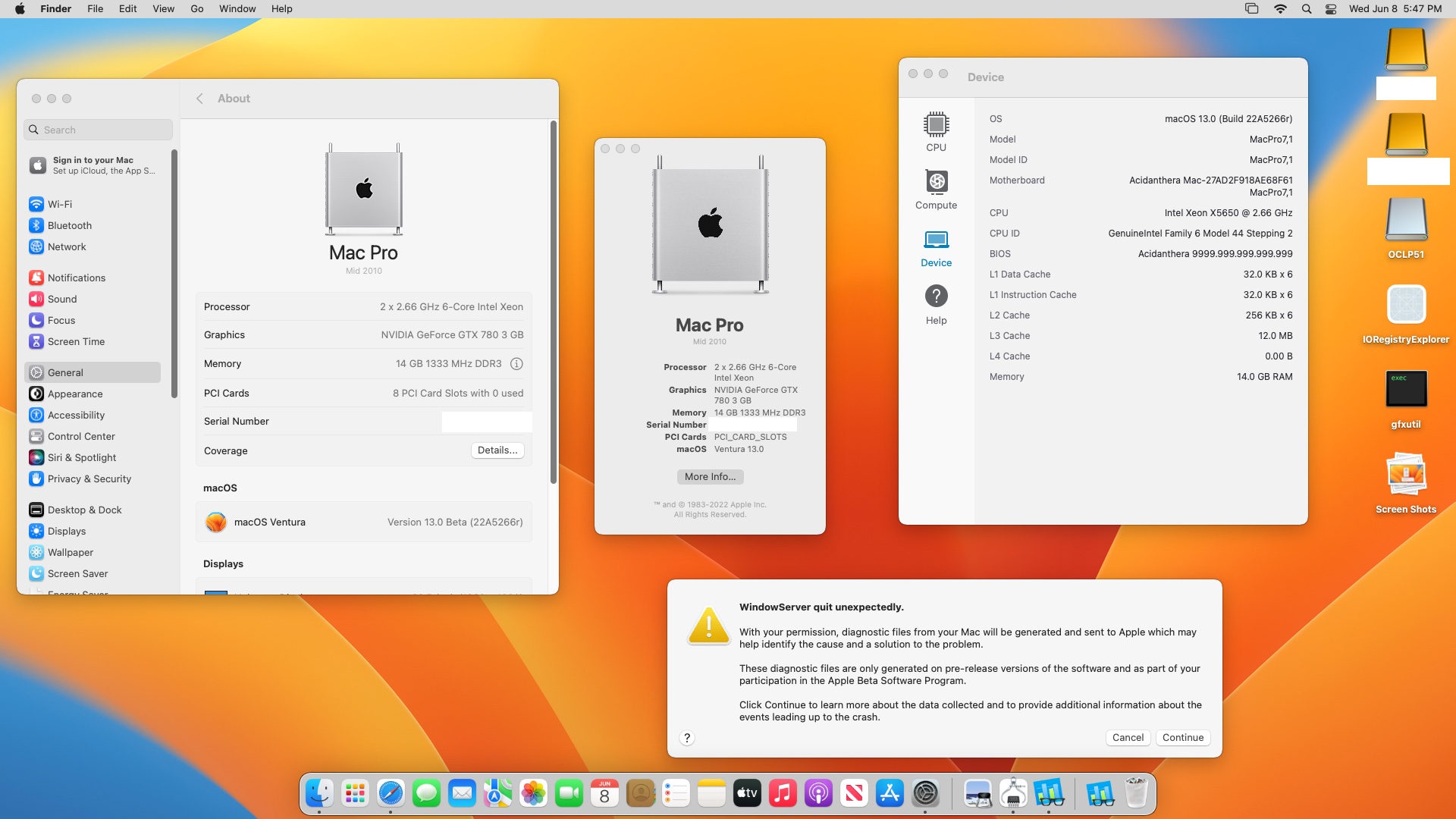

As a MacPro5,1 owner, this is a particularly exciting screenshot from Jazzzny:
EDIT: Jazzny just posted more details about Ventura running on MacPro5,1 over on the OpenCore on the Mac Pro thread. Too cool!

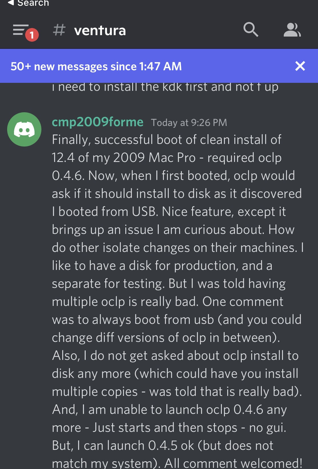

Maybe not yet. I would not give up on it yet. We got amazing people and developers in this thread and on discord that I am sure could pull it off. This was just posted on the OCLP discord server which you can join at this link: https://discord.gg/rqdPgH8xSN

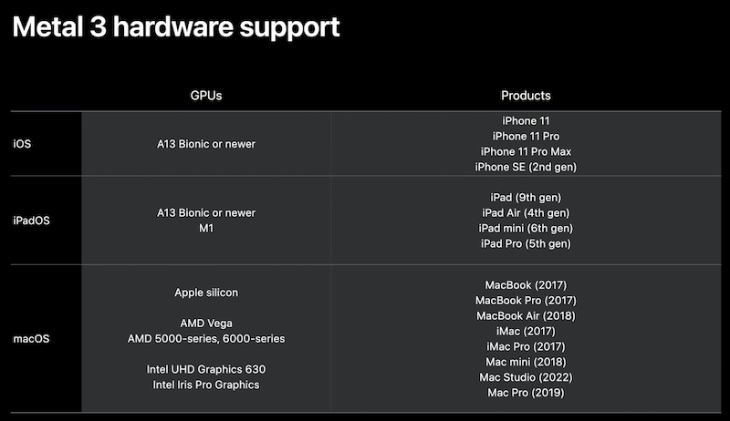

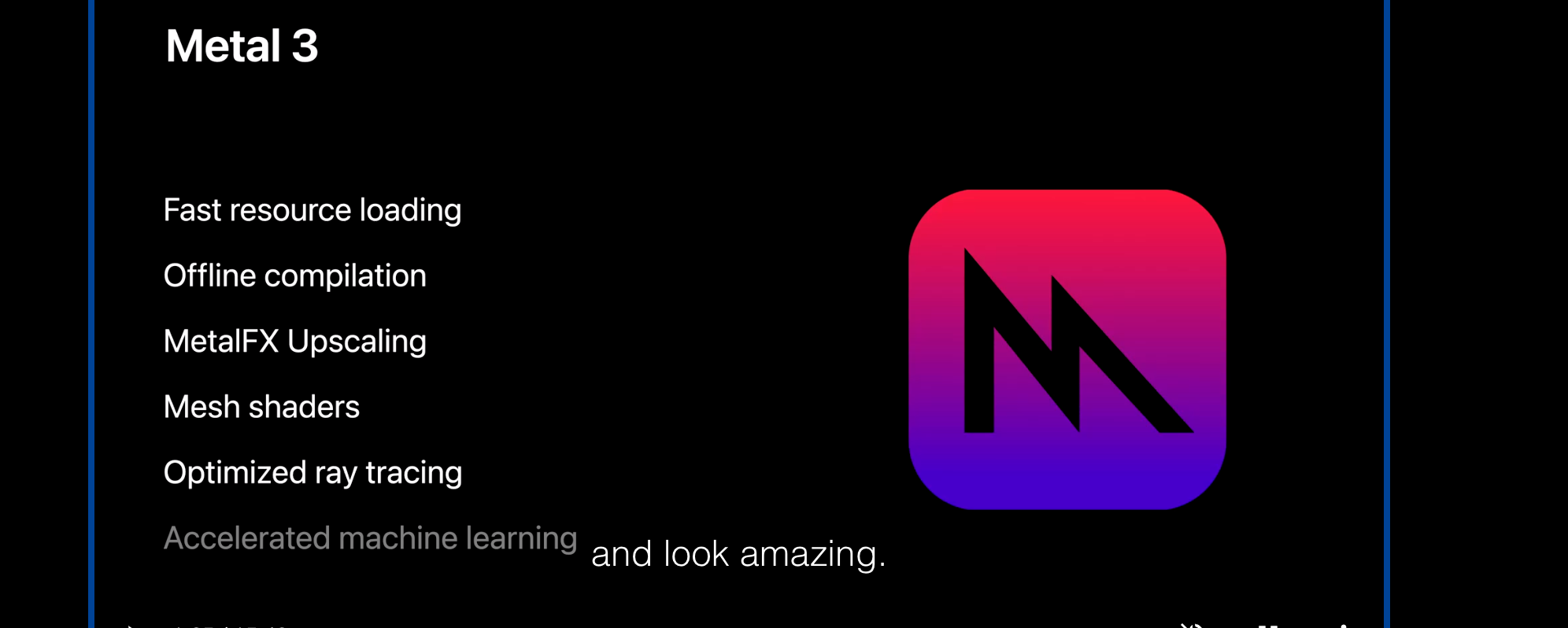

There is a reason for the huge drop at least on the GPU side. Metal 3 is a huge API upgrade.
See for yourself:
screenshot-2022-06-08-at-10-05-55-png.14754
See for yourself:
In the case of iOS and iPadOS 16 they are clearly keeping support for devices that do not support Metal 3. So there is perhaps a chance to get devices that support older versions of Metal running with acceleration even in Ventura if the fallback code is in place there, too, without having to patch the entire OS.

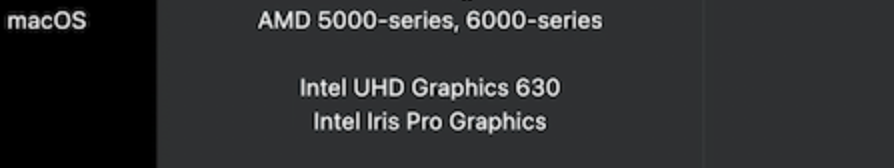

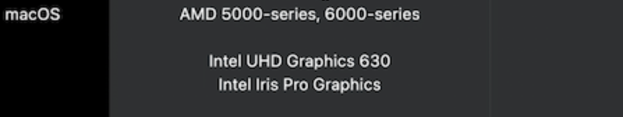

Wait MBP2015 has Intel Iris Pro 5200? Is there a driver for it in Ventura?
The Iris Pro series was first shipped with the late 2013 MacBook Pros. Apple never reported the model numbers of the subsequent models, so they all share the same name. Presumably they’re referring to the 640 and above here.
Edit: I can’t read, apparently.
