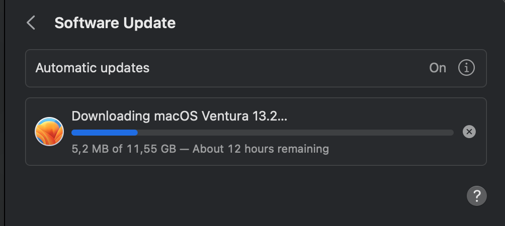

Can anyone confirm the update size is the correct 11,55 GB with patcher from 13.1 to 13.2? Because on M1 update was around 3 GB
