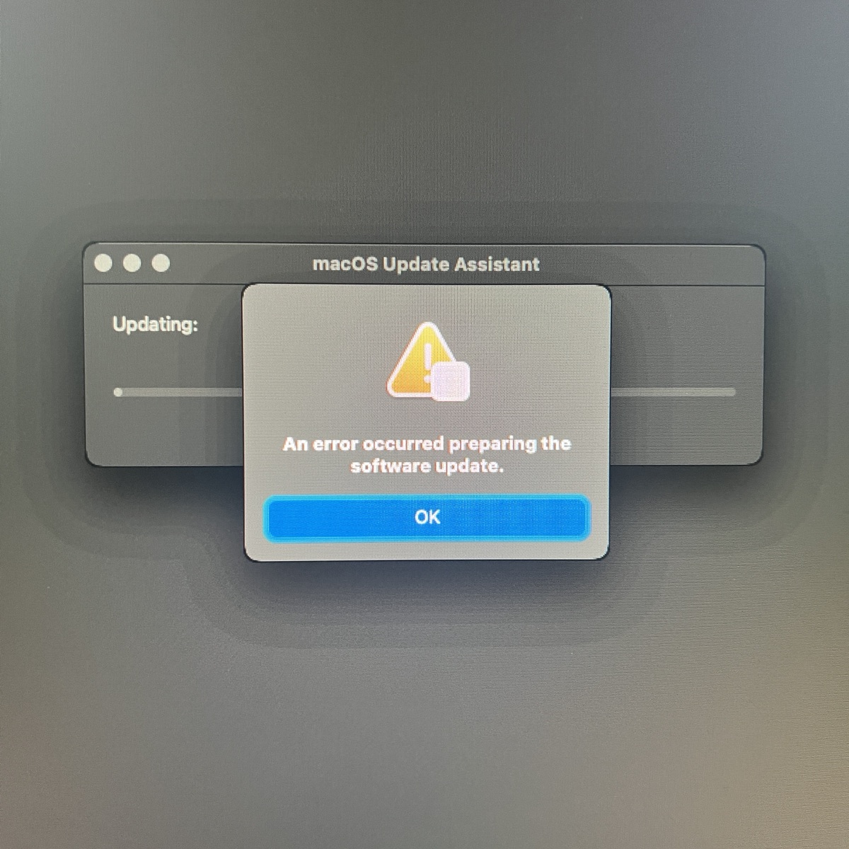

Clean or conventional installation of macOS 13.2 with OCLP 0.6.1 via USB3 card reader on a native USB 2 port or a card reader in my display (actually a USB 3 hub ...) doesn't work here. With about remaining 12 minutes of the installation procedure this error suddenly appears:
An offered restart always brings me back to this point.
Can this be fixed or circumvented?
Thanks in advance for useful hints! :)

If you restart and go to Mac OS installer from efi boot it will finish successfully but you will not have WiFi. I had the same above issue happen and no WiFi on either Mac same with a friends Mac…
Thanks for your reply. As I said, a restart (including the selection of the macOS installer) brings me back to this point (from 29 minutes remaining down to 12 minutes). Again and again.
