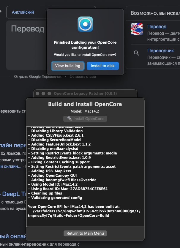

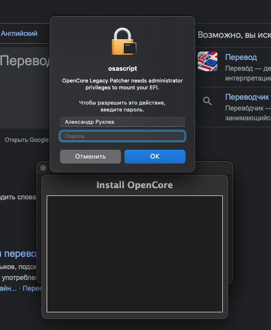

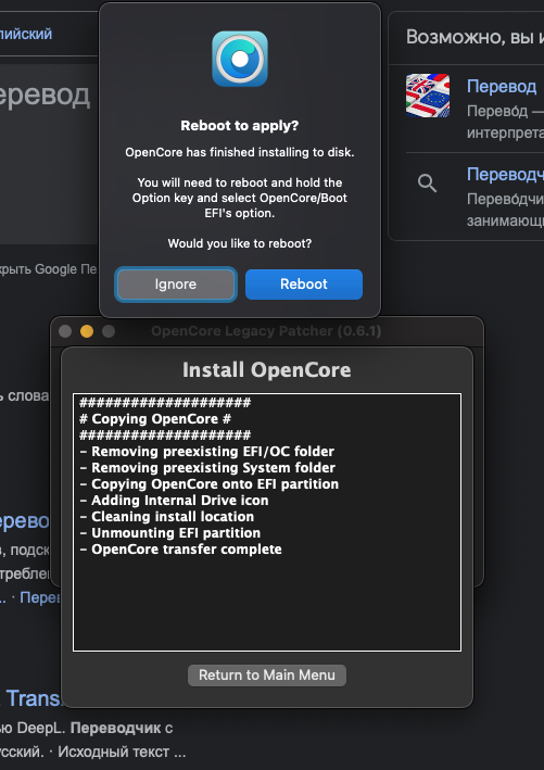

Good afternoon. Installed Ventura on iMac 14.2. Everything works well, but I can’t install OpenCore on the built-in disk to boot without USB. It is constantly suggested to install on the built-in disk - I constantly install it - as a result, it doesn’t boot without USB. OCLP 0.6.1.

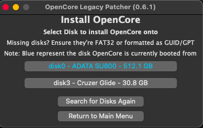

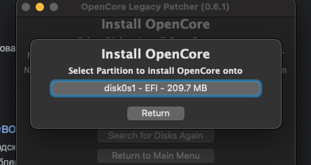

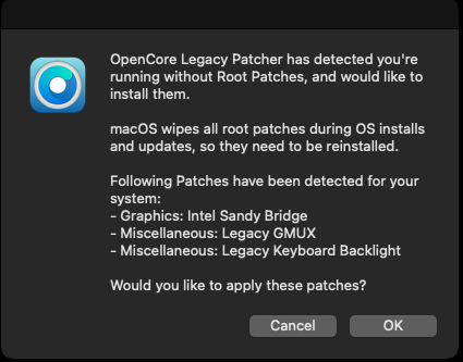

I don't fully understand your question, so forgive what may be my misunderstanding. When you run OCLP and select "Build and Install OpenCore," you should see a prompt like this:
Are you seeing your internal disk in the list? Are you selecting the correct disk? If you don't see your desired disk, do you see and understand the "Missing disks?" explanation in the prompt?
I see my internal drive and install OCLP on it. I pull out USB - I reboot - without USB it is not loaded. There is no EFI folder.
In addition, when you select your internal disk, you should click once on that disk's button, for ex. the blue button in the picture above. Then it should show the EFI partition on the disk you just selected, and you have to click on that button too. So that's 2 buttons to select your internal disk. Then the OCLP should prompt you for typing your admin password.
Did you do that? The fact that OCLP keeps prompting for a disk selection indicates that you didn't do exactly that. So what did you do?
Edit: Just saw your 2 pictures. Did you click on the blue button saying disk0s1-EFI-209.7MB ? or did you just hit the Return button. Try clicking on that second button!

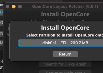

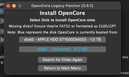

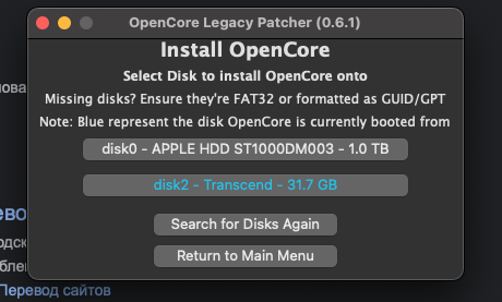

After I remove the USB and restart the computer. When loading, I hold the button to select the boot - only the Macintosh disk is on the screen for selection/
I install not on Flash
