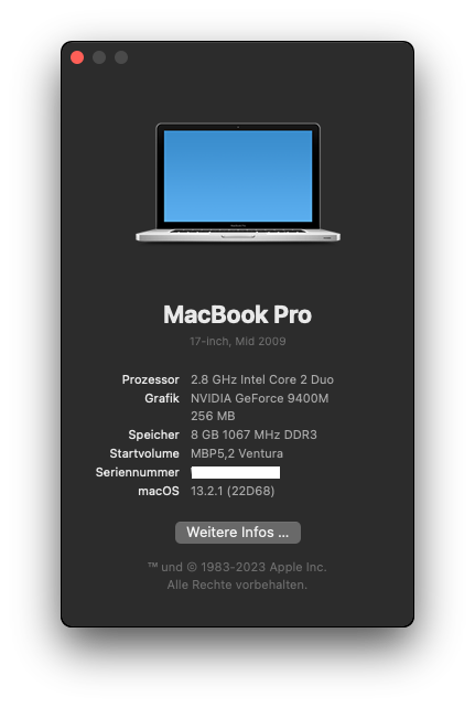

MBP5,2 now on 13.2.1 on internal SSD.
Updated OTA from 13.2, full 11.55 GB size.
Using latest OCLP 0.6.2n from 10 Feb.
Before running the post-install patches (manually), ran the Build-Binary.command.
Looks good so far.
