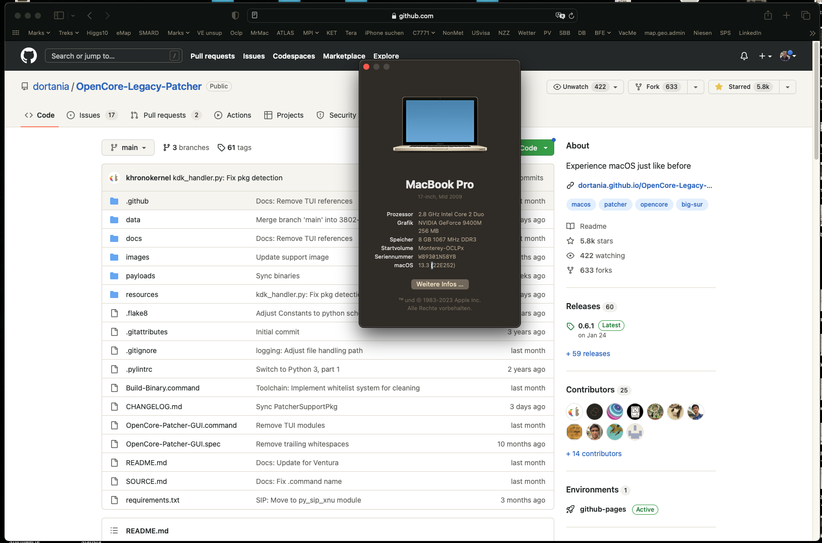

MBP5,2 (Penryn+Nvidia 9400M): same good result.
KDK handling re-installed KDK (which gets incomplete during 13.3b4 OTA installation) correctly from KDK backup.
As backup serves the .pkg file (if still present) which was used to install the KDK.
MBP5,2: fine again with 13.3RC (22E252), KDK handling as before.

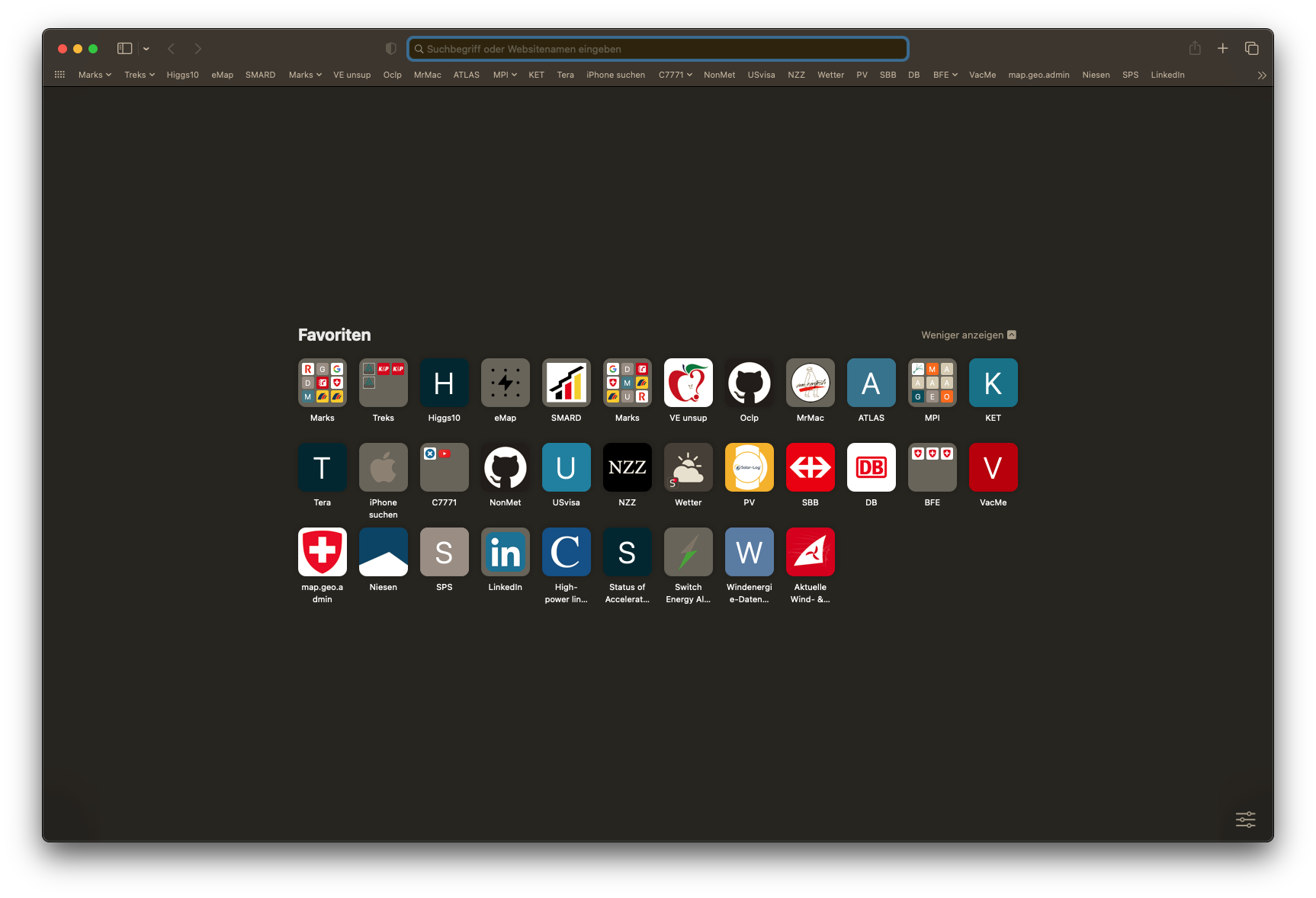

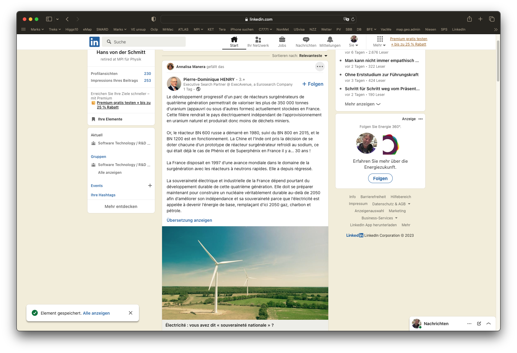

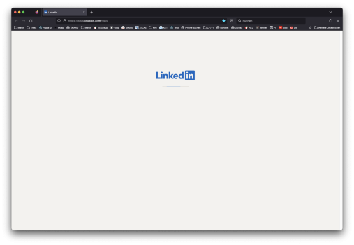

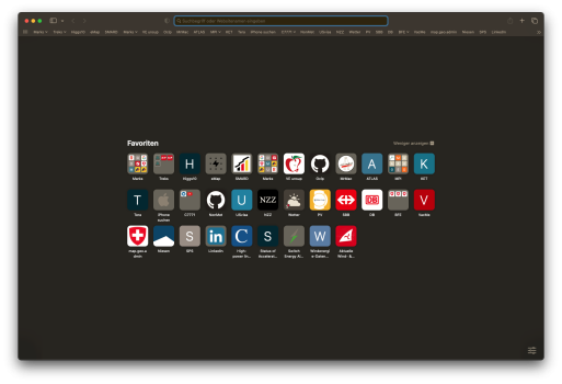

Safari: shows blank page unless its window is not in the foreground, as was reported in an earlier post. Exceptions: LinkedIn page always works. The favourites page is also fine.
Firefox: fine as alternative.

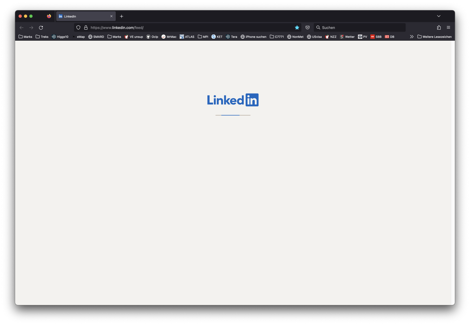

- Exception: LinkedIn login doesn't proceed in Firefox.
- EDIT: just tried LinkedIn in Firefox in 13.2.1 on supported MBP 16,1. Doesn't proceed either.
- So a problem of the LinkedIn/Firefox combination, NOT of OCLP or 13.3.
NB: used OCLP 062n 25 Mar (last commit: kdk_handler.py: Fix pkg detection)
NB2: 13.3 public release is 22E252, same build# as RC.

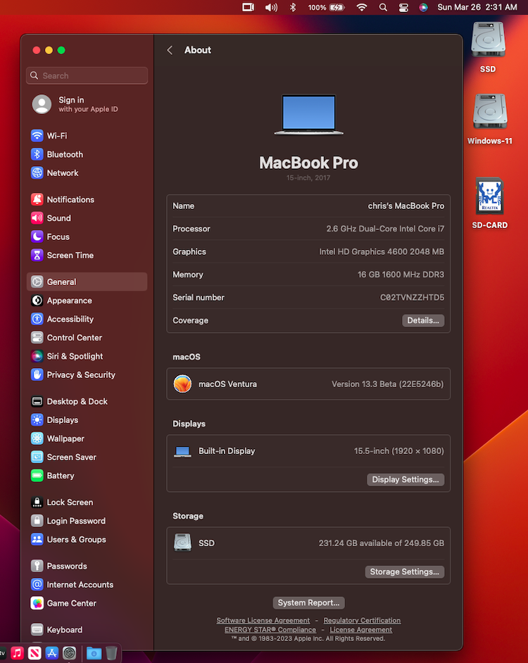

I said it too early perhaps. Now my MBP wouldn't boot, from OCLP on disk or USB, and even in safe mode. On booting, it just goes half way and stays there :(
I made no change except I had let it sit overnight and the battery had drained. Not sure what I can do except wait for some more fixes. Don't want to wipe and install 13.2.1.
