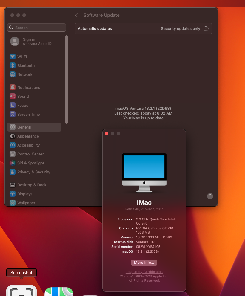

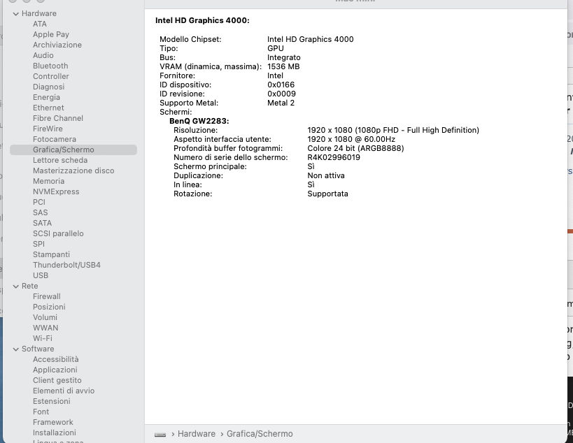

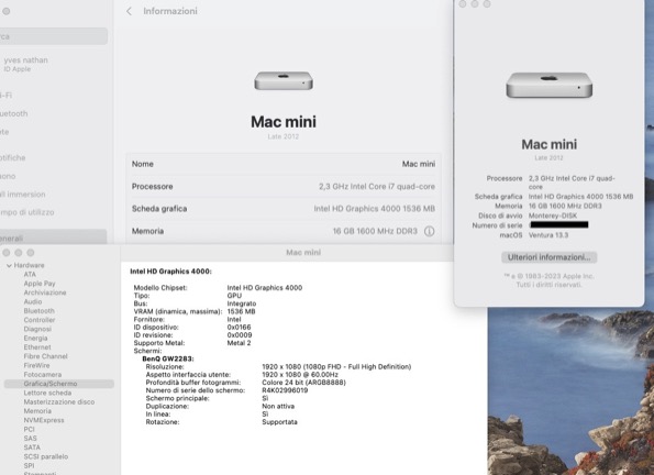

Some little issues but not so important.
I can't see preview but i can paste to a post like you see, sometimes sys info is not smooth, but other seems working.

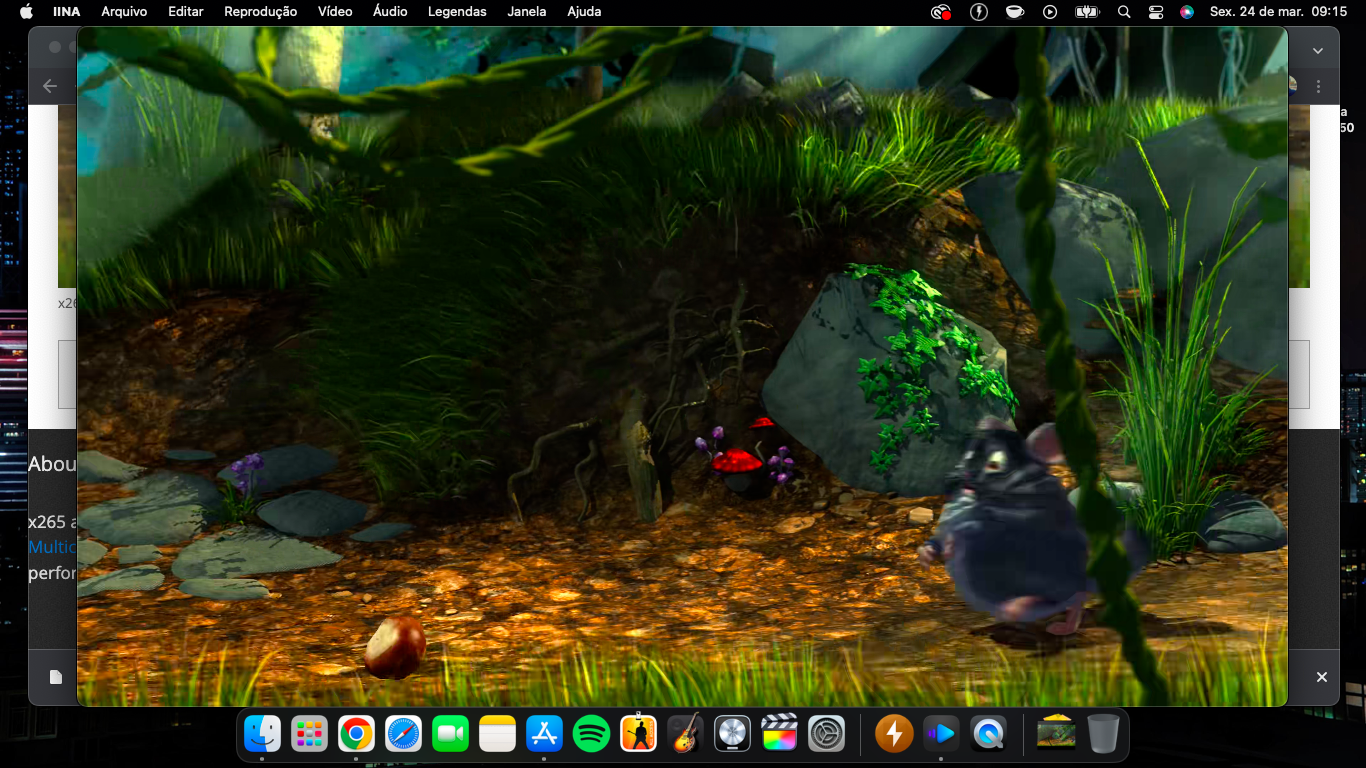

I downloaded the OCL 0.6.2 Nightly build, reinstalled OpenCore and post installed the Root Patch on my MacBookPro13,3 (late 2016 MacBook Pro 15") with macOS Ventura 13.2.1. Unfortunately I still can't play HEVC (x265) encoded videos (like these ones on a sample page https://x265.com/hevc-video-files/ ). The QuickTime Player hangs and has to be Forced Quit. VLC player takes a very long time to start playing using, I think, software based rendering of HEVC files. Also, using (copy right protected) streaming video services hangs/crashes the computer. x264 videos play without problems in Quicktime and VLC. So, this means that Hardware decoding/encoding of HEVC files (including all videos/photos shot on iPhones) is still not supported by the drivers in 0.6.2. Hardware decoding/encoding of x264 works. Unfortunately this means I (and many others I think) still can't switch from Monterey to Ventura yet. Hopefully the mighty developers of OCL will find a solution for this annoying and quite serious driver problem.
P.S. Would be nice if other forum members could test the same sample page for trying to play HEVC videos with their newest installs.

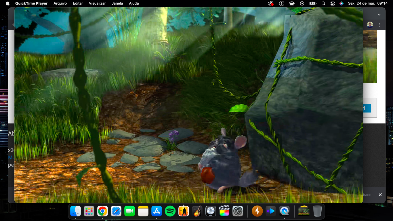

I've been using both the AppleTV+ and IINA and QuickTime app flawlessly to play DRM or x265 content on my Air 2012, and haven't encountered any OCLP 0.6.1 issues, I suggest reviewing the root-patch of your installation. I recommend replacing VLC with IINA, I'm on version 1.3.0, as the latest 1.3.1 failed to exit the application, even though it's working perfectly, so it's an application that always has updates and an innovative design: "This Is Way" (The Mandalorian)

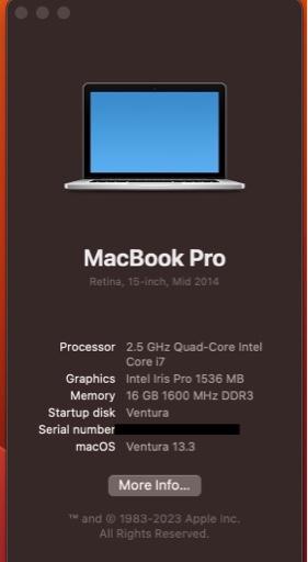

Success sort of on mid 2014 using nightly but wasn’t without its hiccups for me with several failed attempts and deleting the patches in extensions from a big sur install anyhow at least it boots props to developers for there work so far

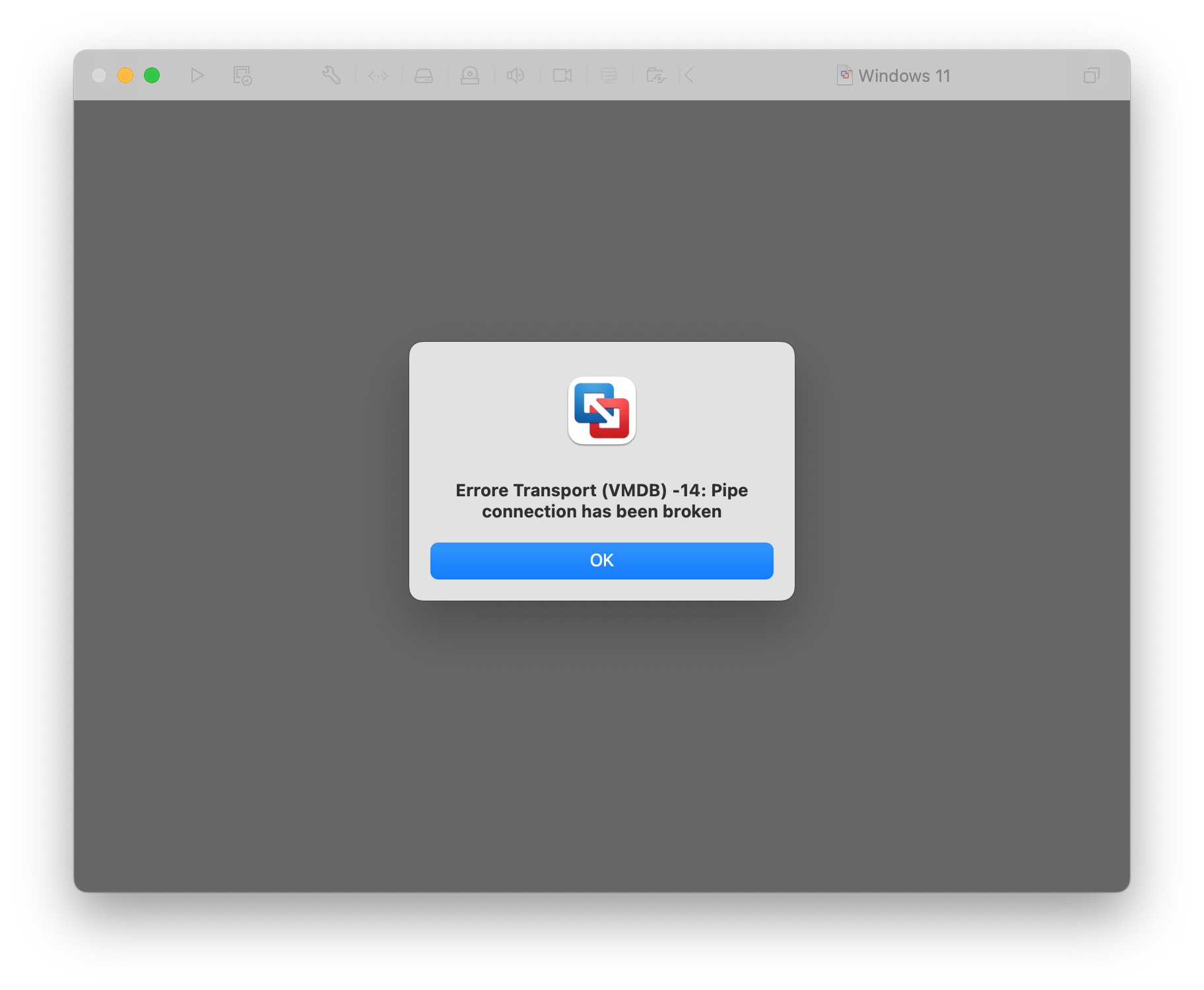

if your using virtual machines UTM works Parallels and vm fusion both won’t boot due to AMFI being disabled it looks like sticking to 13.2.1 and using a test install for 13.3.
So far, so good - great job Devs!!! used the latest OCLP, was a little slow to log in initially but after root patch, all is back to normal. Noticed VMware Fusion does not launch guests but I figure they'll update it since 13.3 is out now.

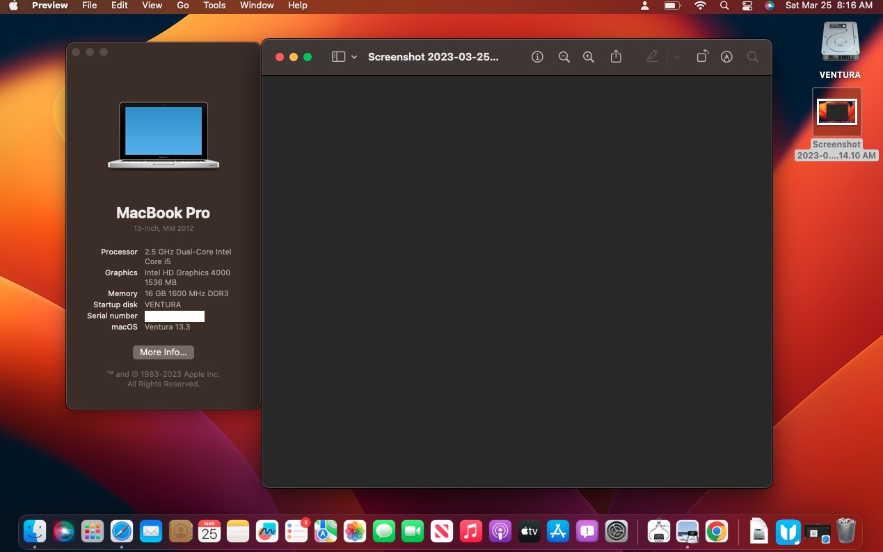

2012 13" MBP (9,2) latest OCLP 0.62n Ventura 13.3 RC, this might be a bug or just maybe due to AMFI disabled, anyway any photos open with preview app will result in blank image.
Yes, same here (MBP11,3): VMware Fusion 13.0.1 and also Parallels Desktop 18.2.0 refuse to resume most VMs; a rather serious issue (maybe due to AMFI now being disabled?): let’s hope this can be fixed, as soon as possible…
Edit (see below; and here, too, Preview displays a blank window: but option-clicking on the green maximise button displays the image correctly again): Yes, it looks like this error is indeed related to AMFI being disabled…
