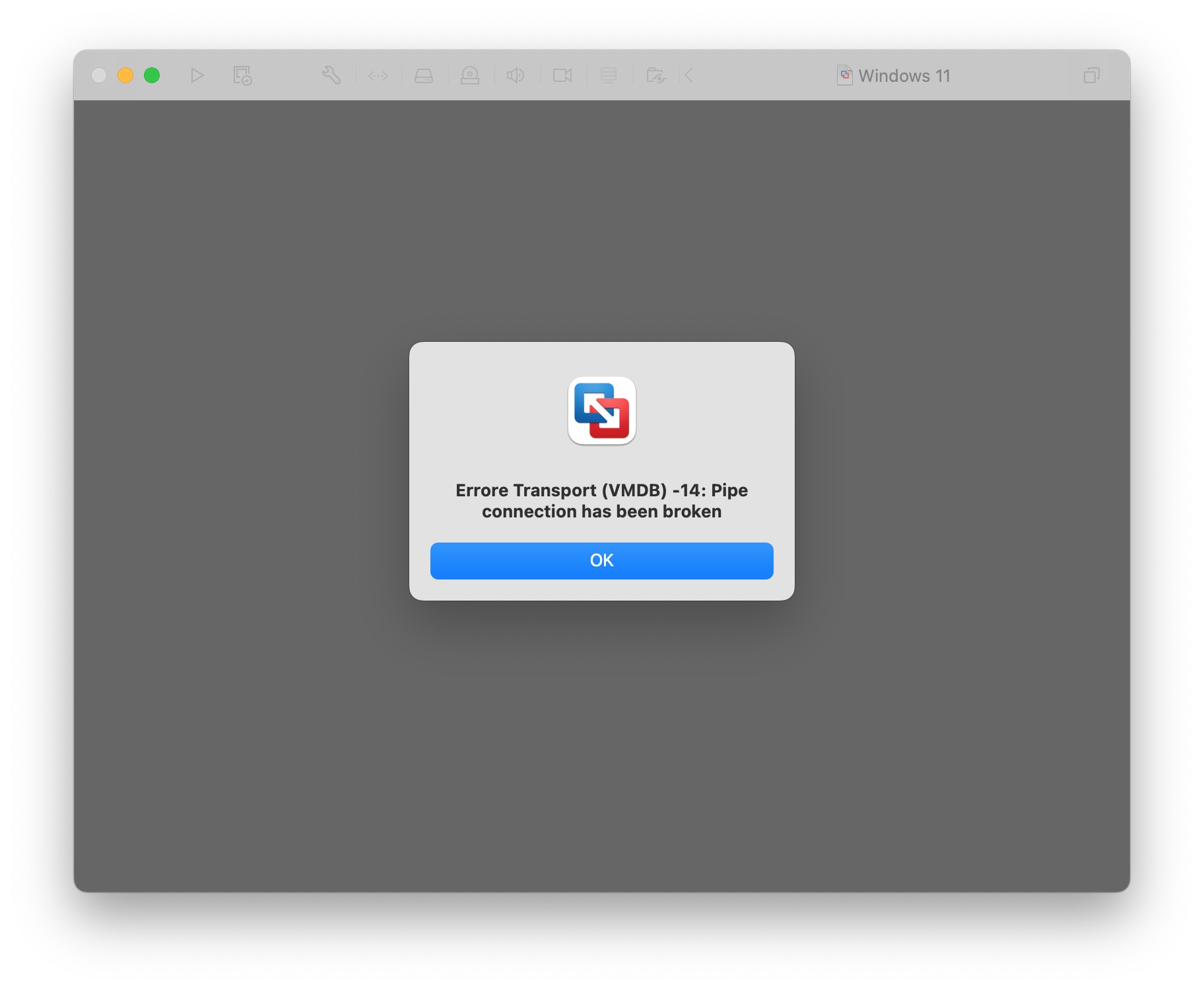

Yes, same here (MBP11,3): VMware Fusion 13.0.1 and also Parallels Desktop 18.2.0 refuse to resume most VMs; a rather serious issue (maybe due to AMFI now being disabled?): let’s hope this can be fixed, as soon as possible…
The error in vm fusion is to do with AMFI being disabled looking on VMware communities UTM will still run windows 11 without it do you also have the preview error?

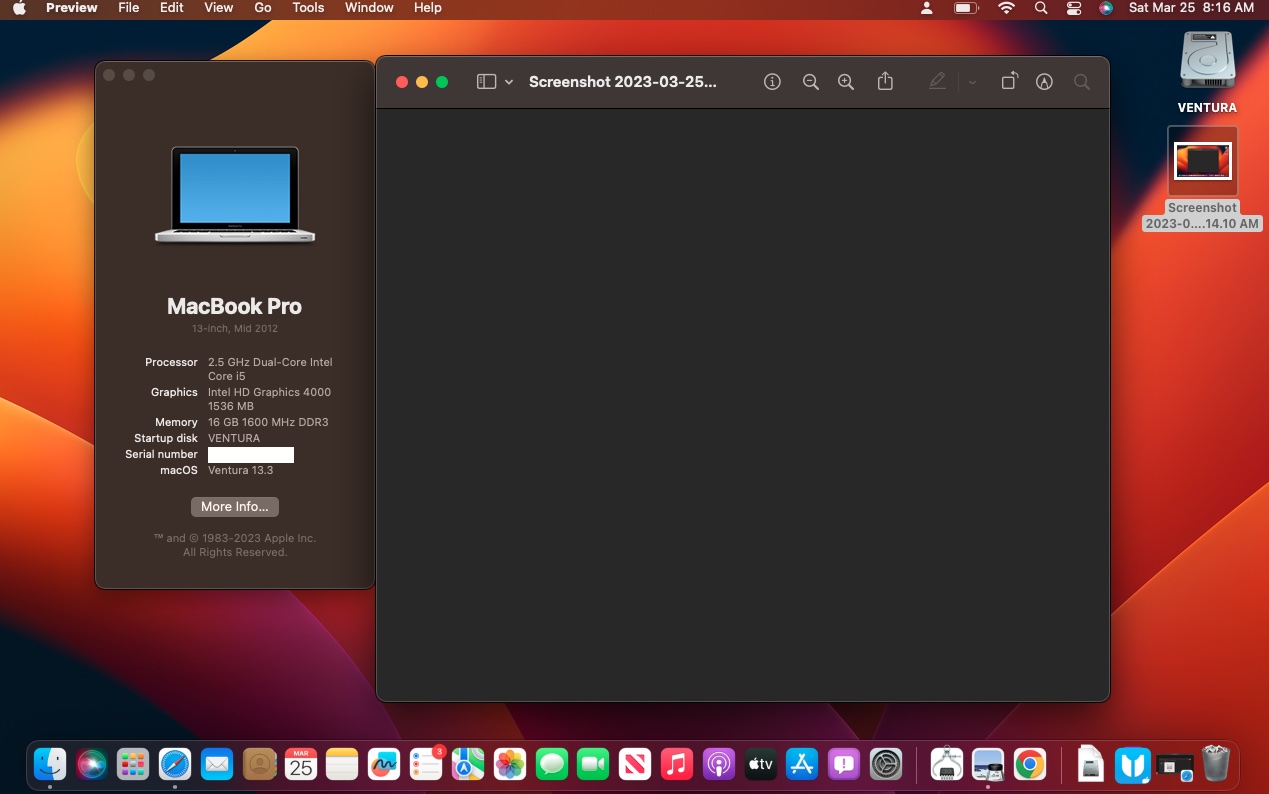

I too noticed this behavior just now after your post, however if you zoom in/out, the picture displays - just not on normal zoom.
I can’t get it on zoom in/out but if you put the mouse over share the document or any bit of the top bar in preview and two fingers swipe any direction on the mouse the image will appear then disappear when you let go.

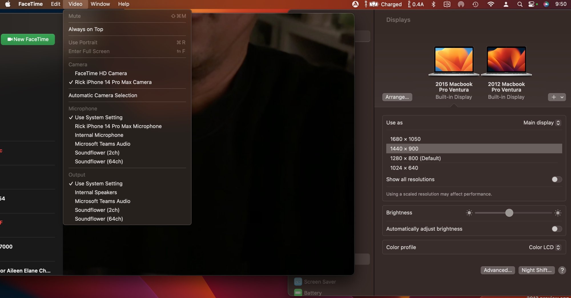

fix will be release when its ready, we'll wait for now, very impressed using iPhone as your webcam with continuity camera plus universal control unlocked working very well with 2015 13" MBP Ventura 13.3 RC.

The only two issues afetr updating my Ext SSD USB to 13.3RC OCLP 0.6.2n (AMFI disabled) are empty preview window and Shutdown/Reboot windows don't appear. I am obliged to shutdown by power button. Premiere pro and Final cut work.
Another confirmation that VMware Fusion doesn’t like SIP and/or AMFI being disabled:
Strangely, with Parallels Desktop, my Ubuntu 22.10 VM resumed correctly and seems to be working, while the macOS and Windows VMs don’t work: odd, but essentially the same behaviour as with VMware Fusion. Well, if this AMFI thing won’t get addressed, I’ll have to go back to Monterey (which doesn’t have all these SIP, LV and AMFI problems with OCLP): but hopefully it will be fixed in a reasonable time…
