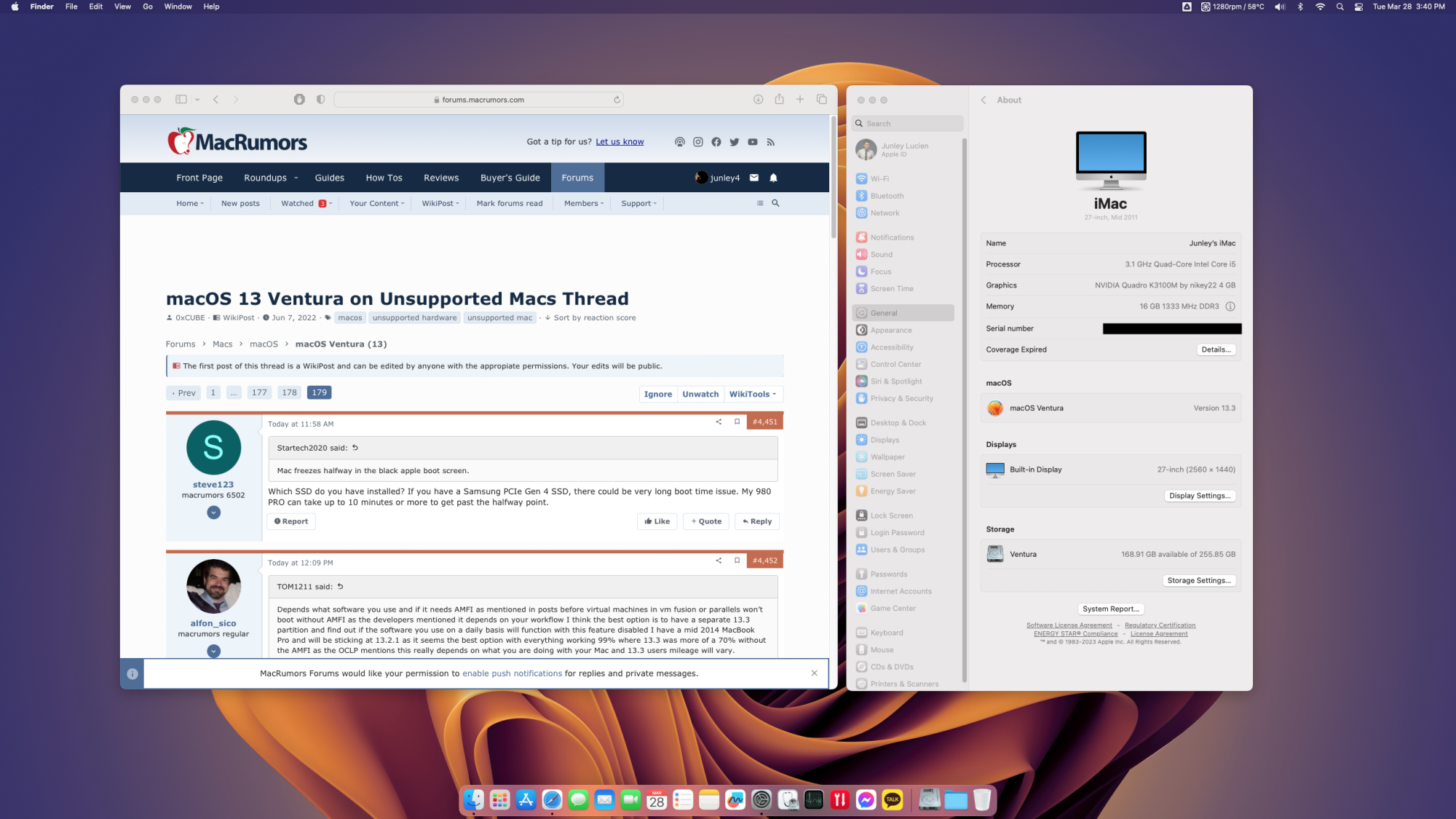

Successful update of iMac mid 2011 27inch with NVIDIA K3100M
-From 13.2.1 to 13.3
-OCLP 0.6.2
So far, everything that I need works and I have not observed any problems yet. Again, thanks to all the devs, contributors, and testers of nightly OCLP and MacOS betas.

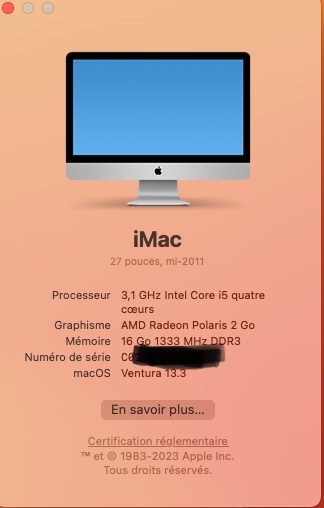

OTA update OK on my test iMac 27" mid 2011:
- OCLP upgrade from 0.6.1 to 0.6.2 before Ventura upgrade
- rebuilt and installed OCLP 0.6.2 on the internal disk
- reboot
- OTA update from Ventura 13.2.1 to Ventura 13.3
- at the last reboot, OCLP detects and indicates that it is necessary to relaunch the post-install patches
- last reboot: everything seems OK :)
