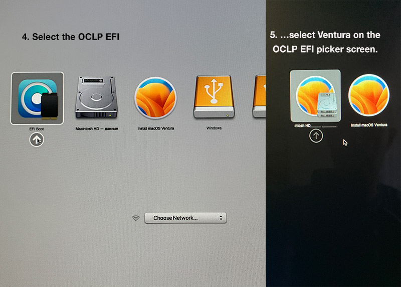

1. Restart
2. Hold cmd+opt+P+R (PRAM reset) until hearing a chime.
3. Hold opt key immedicately until Apple native EFI picker shows up.
4. Select the OCLP EFI,
5. Hold Ctrl and select Ventura on the OCLP EFI picker screen.
I don't get OCLP EFI instead always Macintosh HD icon on gray background. And nothing changes((

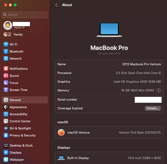

On MBP11,4 spoofed to MBP14,3 as recommended by OCLP 0.6.1. From past experience, I avoided the Ventura 13.3 betas and stayed on the 13.2.1. With the announcement of 13.3 today, I thought it was safe to update my laptop's OS. Not so. Hanging 1/3 of the way on rebooting. I am trying to go back to the 13.2.1. Time Machine is not cooperating - It did not show any backups. Ah well, I'll try to get back to 13.2.

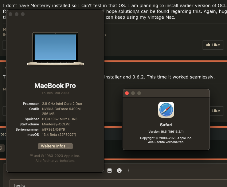

Followup: I finally got my machine working without going back to Ventura 13.2.1, thanks to @kopurando's detailed experiences on post #4411.
Reactions: roronl

Just verified that Safari 16.4 in 13.3 now works on non-metal MBP5,2.
I stayed with the 0.6.2n that I had before (same code as 0.6.2 release) but replaced the PatcherSupportPkg with 0.9.2 in resources/constants.py, then re-ran build-binary.command and then post-install patches.
Will be the same with 0.6.3n, but wanted to try the minimal change.
Transparency also working beautifully.
Post-install automatically used the proper KDK for 13.3.
Thanks OCLP and non-Metal developers!
MBP5,2: Installed 13.4b1 over 13.3 OTA. Works well, including new Safari 16.5.
Using OCLP 0.6.2n (with the modification for PatcherSupportPkg 0.9.2). I'm sure 0.6.3n works as well.
