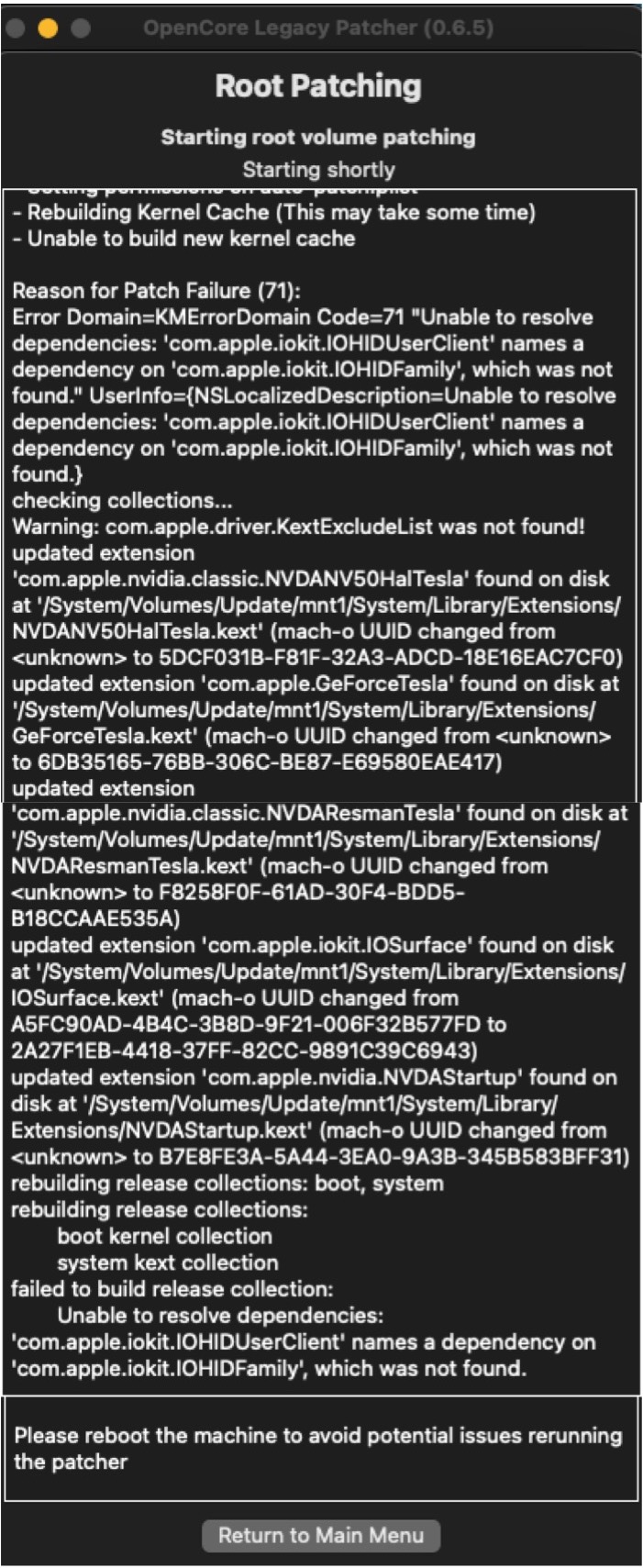

Post install root patch keeps failing???

Trouble repatching a MBP 6,1 w/ oclp 0.6.4 and ventura 13.2.1.
Patching keeps failing.
Any help would be great!
I forgot the trick lol

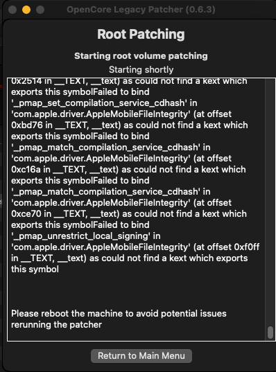

Lots of failure modes. Might help if you post the error. When I try to apply 0.6.5 Beta post-install patches on Big Sur and Monterey patched with OCLP 0.6.3, I receive the following error. When I reboot, 0.6.3 patches are still installed and work well, so I haven't tried to debug. Is this the error you are seeing? I don't see this error when I apply the 0.6.5 post-install patches in Ventura 13.3.1. My SMBIOS model is MBP6,2.
yes I get the same error and so I unpatched and then rebooted and when I repatched it fails...
Any fix??
I haven't tried to fix, since 0.6.3 post install patches work fine for me in Big Sur and Monterey. I see this error only when attempting to apply 0.6.5 patches to Big Sur and Monterey already patched with 0.6.3 (I don't see it in Ventura). Would also be curious to know the fix if anyone has suggestions.

oh ok I'll try 0.6.3 tnx
I tried 0.6.1, 0.6.3, 0.6.4 and 0.6.5n and all fail to patch my mbp 6,1 machine..
vantura 13.2.1
