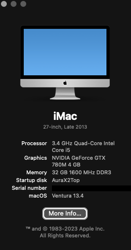

I am currently booting Big Sur 11.7.7, Monterey 12.6.6, Ventura 13.2.1 and Ventura 13.4 on my MBP6,2 using the OC EFI generated by OCLP-AMFIPass-Beta4 (AMFI Enabled, Library Validation Enabled, AMFIPass.kext 1.3.1). I upgraded the OC EFI to Open Core 0.9.3 and also upgraded kexts to the latest (including the BrcmPatchRAM kexts to 2.6.8 [nightly build]). I am finding Ventura to be just as responsive as Big Sur. I keep multiple versions of macOS installed for a few things that work better in earlier macOS versions and am finding less and less of a need to avoid Ventura 13.4. OCLP Devs continue to perform miracles.
Note that my MBP6,2 has NVidia Tesla non-metal graphics. Based on the posts here, it is clear that individual experiences with OCLP vary depending on the Mac model / graphics.
Reactions: houser

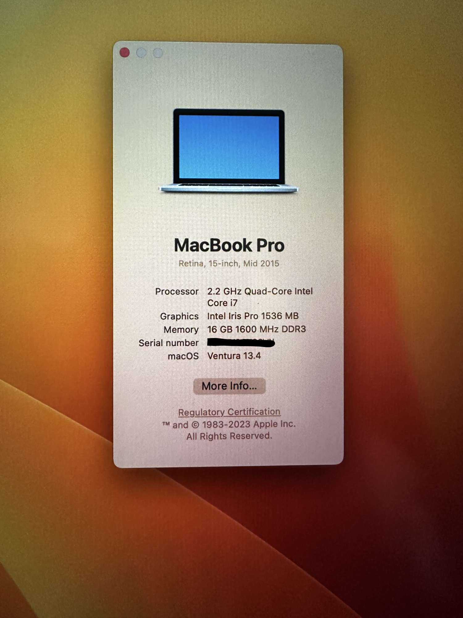

Working on mid 2014 with AMFIPass beta did have to do a couple of reboots first would open then close then rebooted and would play the episode it’s fine now on 13.5 beta.

iMac 14,2 with OCLP 0.6.7 running 13.4 upgraded from 13.2.
I only use it for security updates. General browsing use.
It also drives my 30" Cinema Display no problems.

Another problem I wanted to share with you. I have noticed that on some computers (Mac Mini 2012, Mac Pro 2013), when I open pages or Calc, if I drag an image inside, pages or calc crashes.
However, on a 2016 Macbook pro 15" (which also uses OCLP) pages does not hang and works normally.
I was investigating and I have read somewhere that it is because of the AMFI. To solve it I have tried to use the OCLP beta which keeps the AMFI turned on. I'm talking about this.
https://github.com/dortania/OpenCore-Legacy-Patcher/releases/tag/amfipass-beta-test
However for some reason the error remains there. To investigate, I have seen if there is any difference between the amfi of one computer (macbook pro 2016) and the other (mac mini 2012), so I typed this command in the console to see what I get on each computer
Code:
sudo nvram boot-args
But my surprise has been that... Both teams show the same result.
So I also looked at activating SIP on both with this other command
Code:
csrutil status
and again in both I have the same result.
Any idea why I may be having these crashes in Pages?
Thank you.
