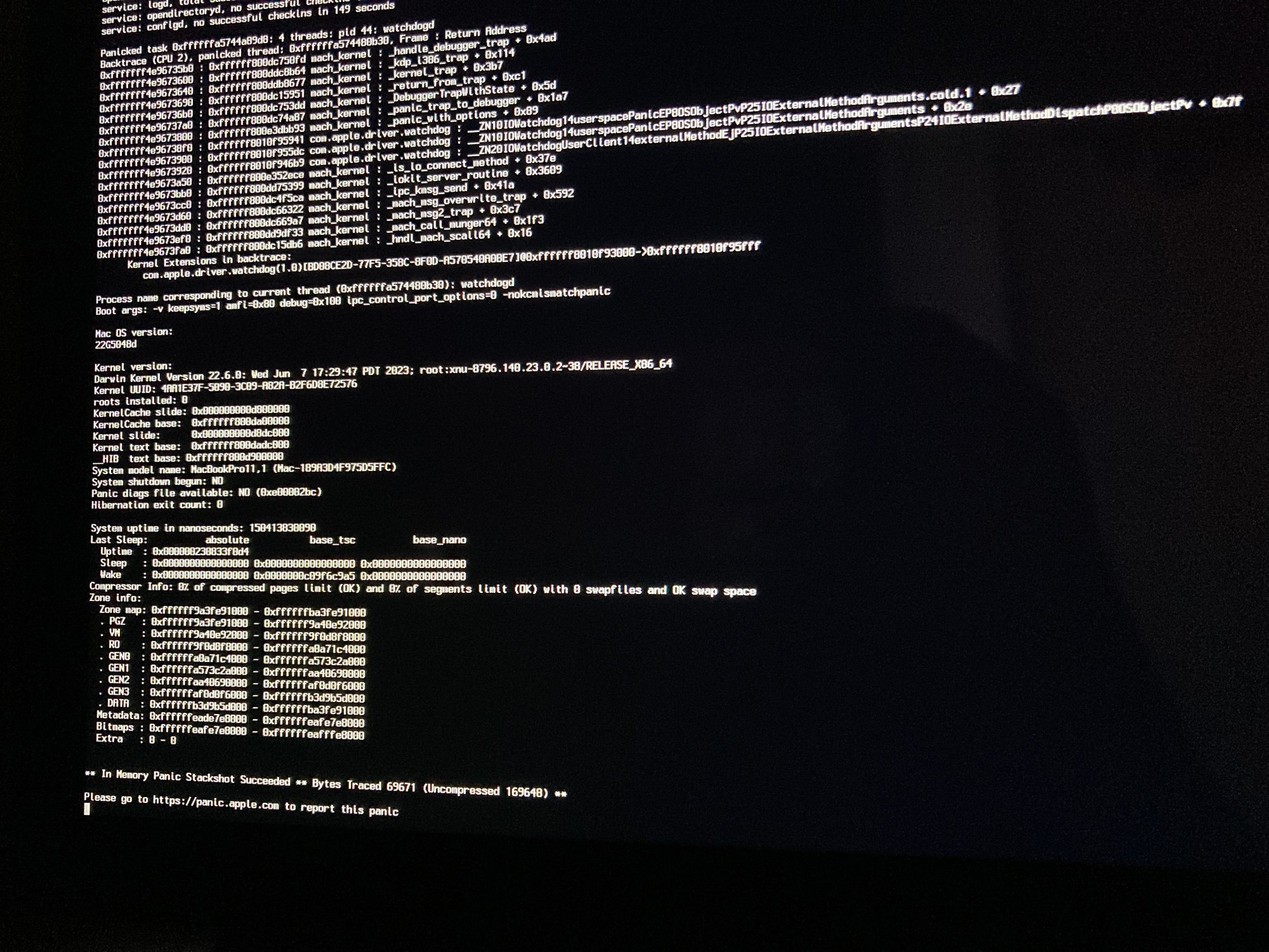

After using the system all day yesterday, it seems that from time to time it hangs up on start up. I would say 50%. I have to hold down the power button for 5 seconds to get it to turn off. When I restart, it it says system was turned off …. It does restart on 2nd attempt.
I did not install the system on the external. It’s in the OWC 1Gb internal.
I installed it on a USB, I wonder if that has something to do. If you want to know why does it hangs up. Press command v to activate verbose mode
Reactions: Lgga74

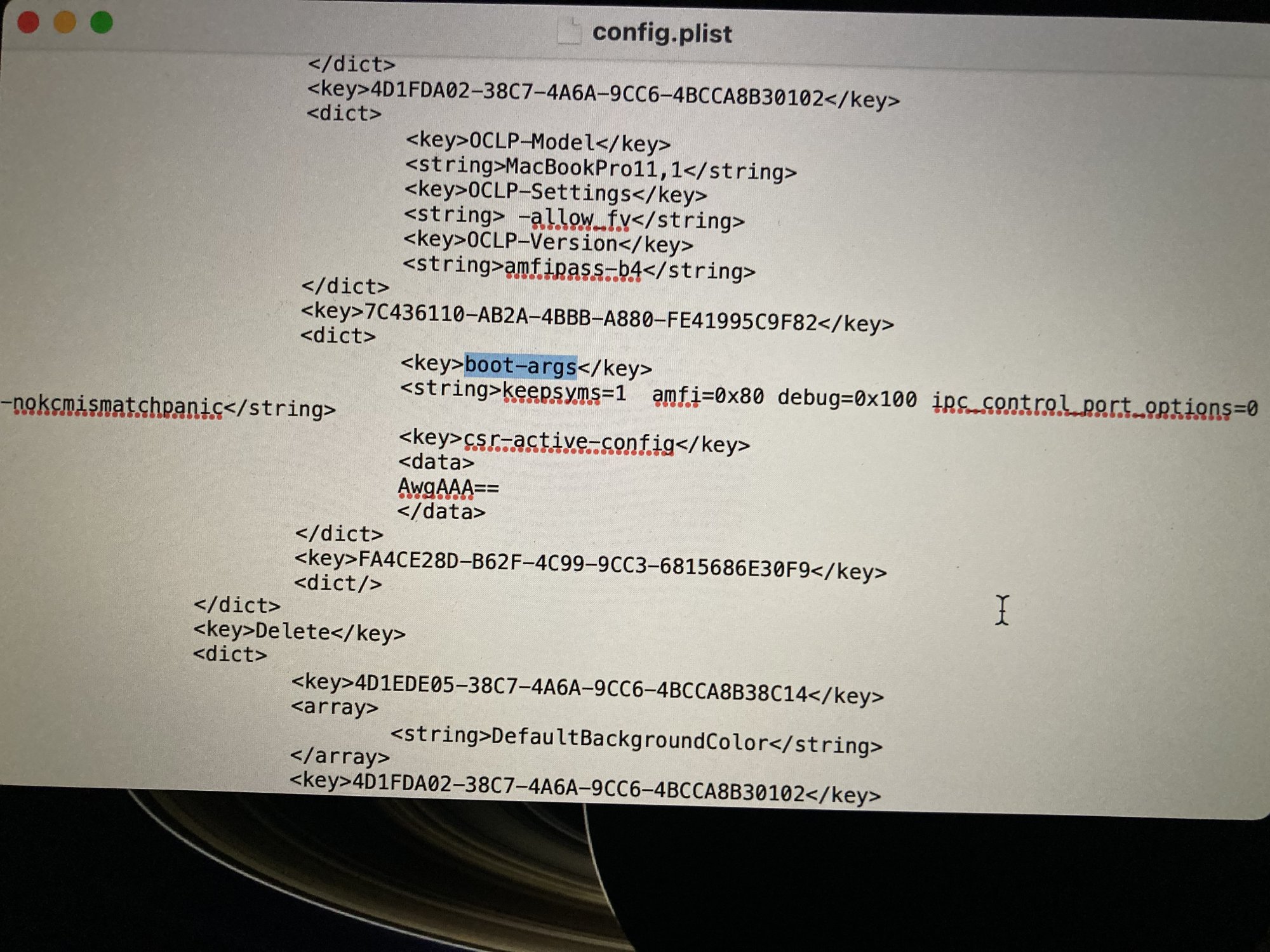

I ran into the “watchdog” kernel panic too. The boot sequence in graphic mode would show the progress bar stopping at about 50% complete, that’s when the KP would occur. It turned out to be AMFI.
For me, it happened when I upgraded from OCLP 0.6.4 to 0.6.7. I was able to workaround it by booting into the recovery partition, then edit the OpenCore config.plist. Find the NVRAM section, edit the boot-args setting, add amfi=0x80. That setting is what the OCLP GUI adds when the “disable AMFI” option is selected. Find my post a few pages back, I tried to write a detailed method of adding the amfi value to the config.plist…
I don’t know if that will help you guys or not. It’s worth giving it a try.
Also, if you have multiple disks (even USB memory sticks), you need to be sure which of the disks is providing the EFI with OpenCore. It’s easy to edit the wrong disk/OC and then wonder why the changes haven’t had the desired effect.
I did it, I dont know if I did it wrong because it didn't work
Opencore is in a partition of my original ssd. It's the only one.
