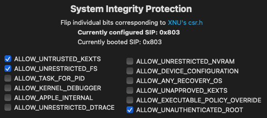

IMHO very important feature: i.e., enabling SIP as much as possible, also on Ventura (the maximum working configuration so far has been 0x800 - with SIP fully enabled but SSV disabled, - but only up to Monterey)…
I would think that the ability to more fully enable SIP would depend on the Mac identifier / graphics (maybe with a new Wi-Fi patch). My MBP6,2 currently needs NVidia kexts, so bit 1 (ALLOW_UNTRUSTED_KEXTS) is currently required. Could OCLP Devs sign the NVidia kexts?
EDIT: I just found this and am reading it to learn more.

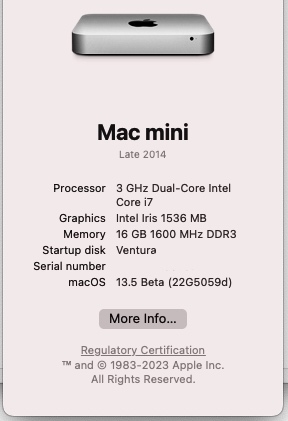

Update to 22G5059d done via OTA using 0.6.8n. No issues. Apple TV works. Weather freezes frequently but does not crash/close. I did not see any other issues for the time being.

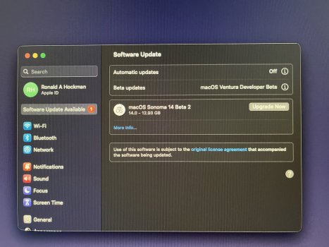

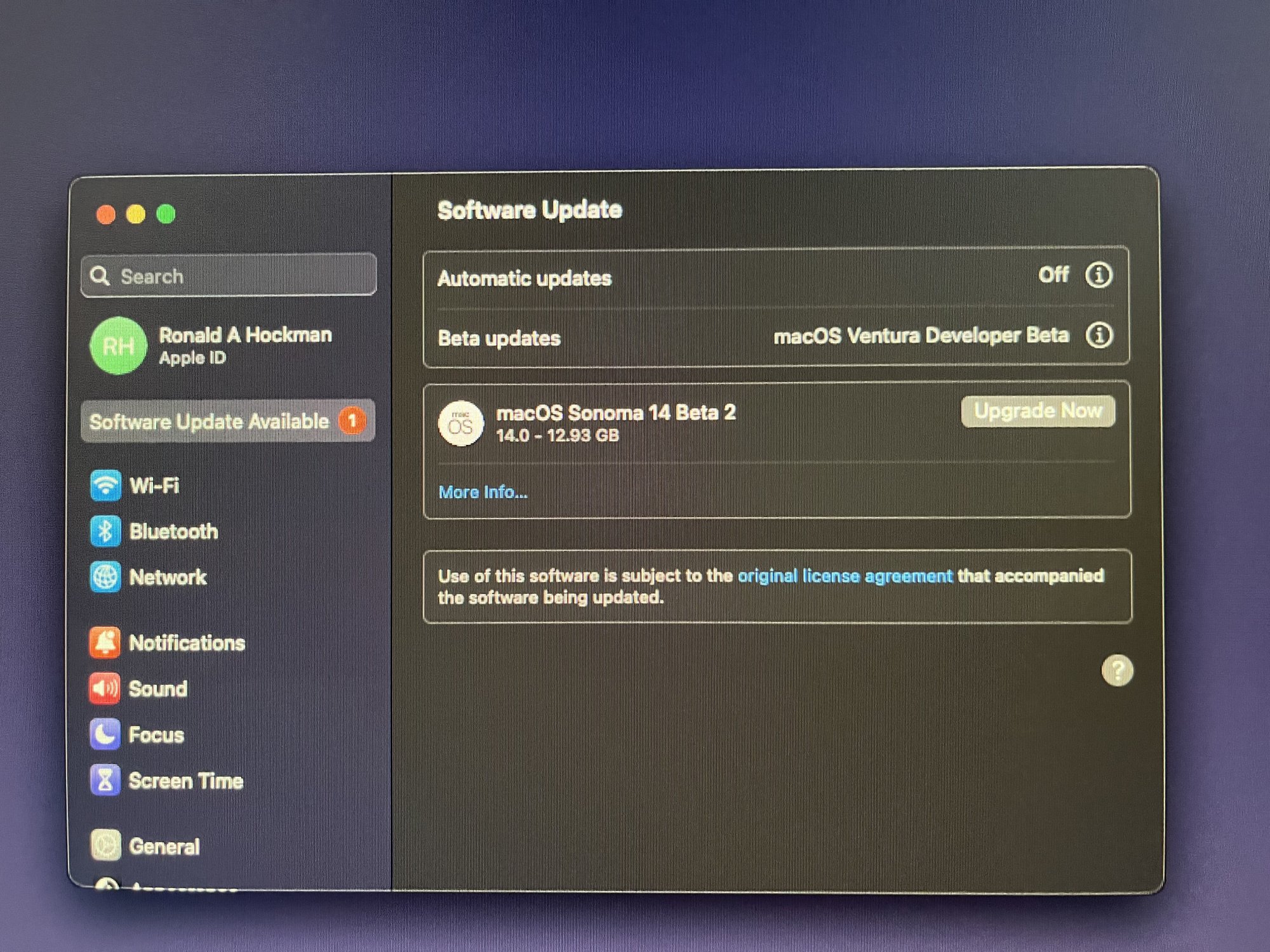

I made a stupid mistake in software update, and now have Sonoma beta 2 avaiable which I am not ready to experiment with. How can I get rid of this notification.
Imac 27, late 2012, 3802

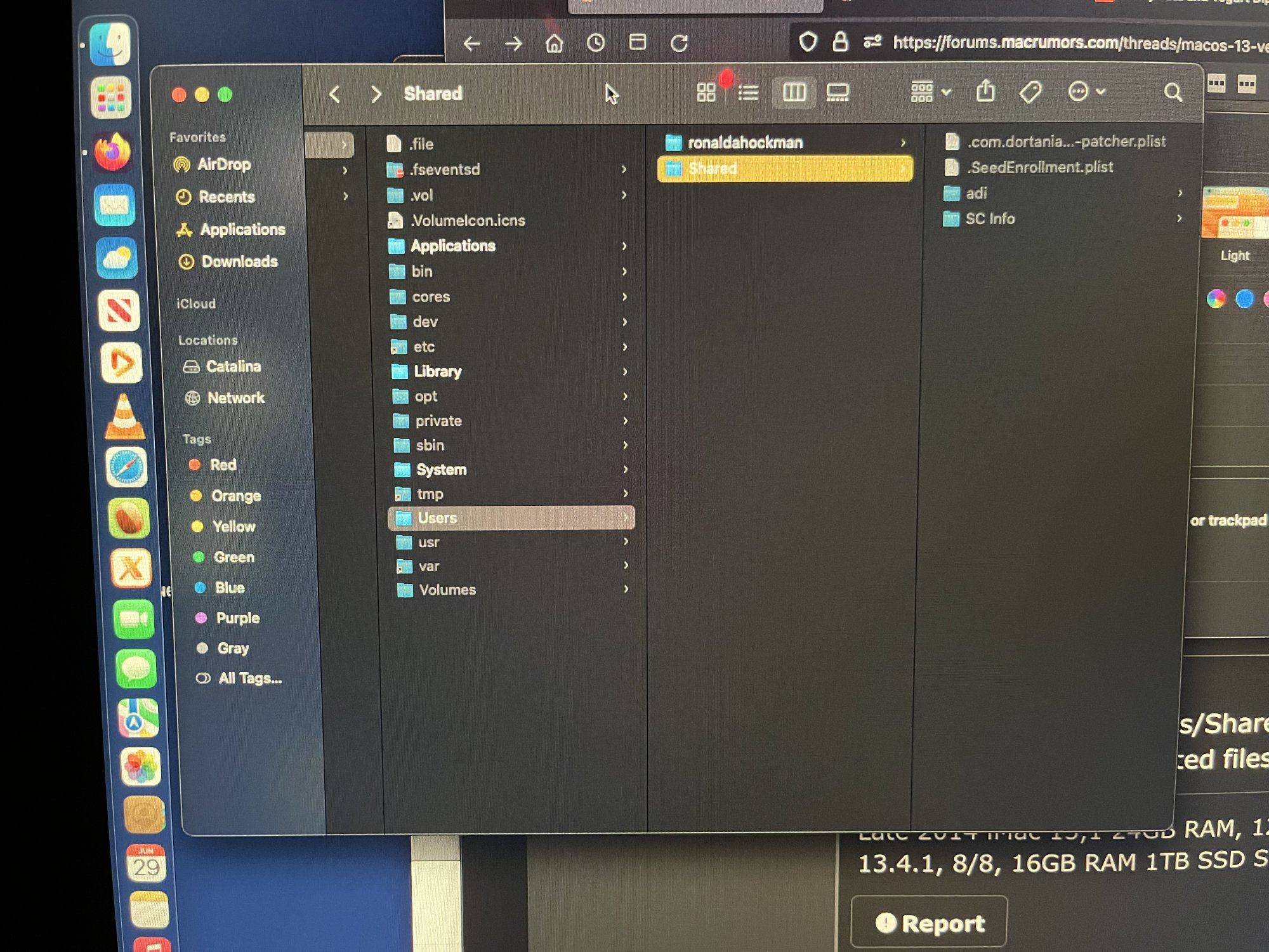

From Finder, go to /Users/Shared/, press Command, Shift and dot (⌘⇧.) to show hidden files,
delete the two beta-related files.
I believe I am at the place you described but there are no beta files.
