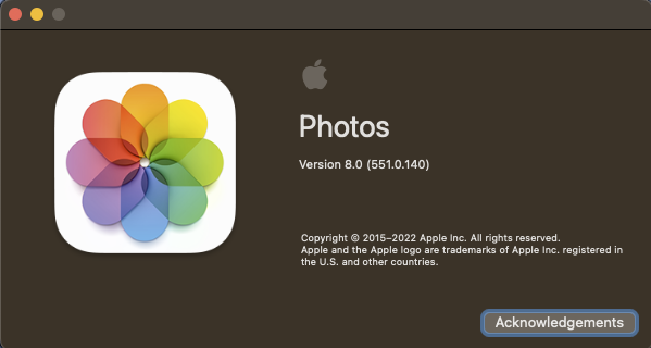

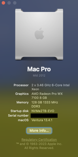

Hi folks, I am running macOS Ventura on my Mac Pro 5,1 using OCLP version 0.6.7. It's running well so far as I can tell.
However, just today I noticed the inability to edit 4K HEVC videos in Photos.app that were taken by my iPhone 12 Pro. Curious if anyone else has seen this or experienced this. 🤔
Here's the error I get...
"Edit" button greyed out in upper right hand corner of the photos.app (see attached images)
An exclamation mark inside a triangle is present in the upper right of the photo.

When the exclamation mark inside a triangle is clicked on, a popup with "Unsupported Video Format. The full-resolution video is unsupported" appears (see also attached images).

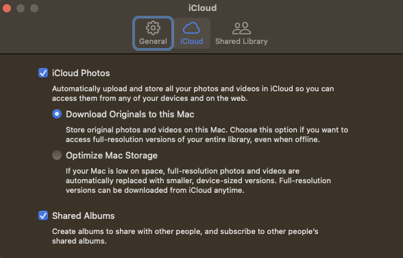

I am successfully signed into iCloud and iCloud Photos is enabled in the Photos.app with "Download Originals to this Mac" selected with "Shared Albums" also enabled (see attached photos). And all photos and videos taken on my iPhone have been automatically syncing to my Mac Pro's Photos app successfully for some time now (or rather ever since my successful install of Venture on this Mac Pro last month).

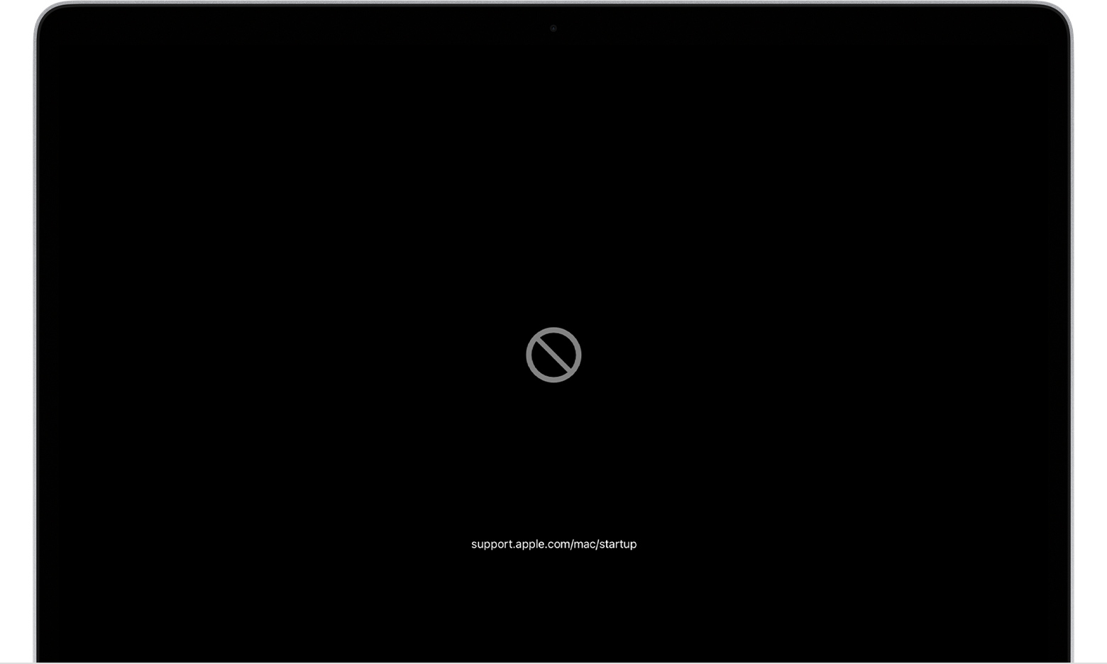

Hello everyone, I installed instead of an optical drive on iMac 12.2, installed an SSD on reboot, it gives an error, but if you turn off the poppy and turn it on, everything loads without problems, tell me what could be the problem OCLP 0.6.7
