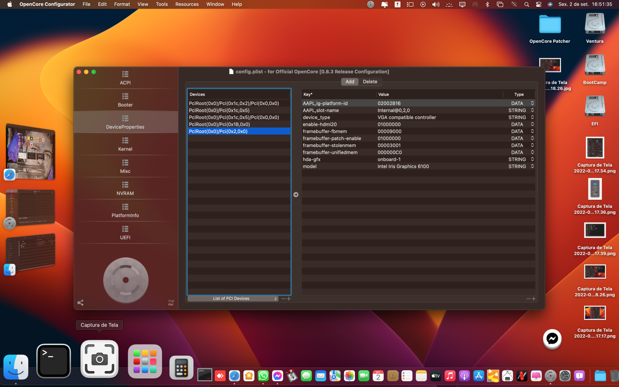

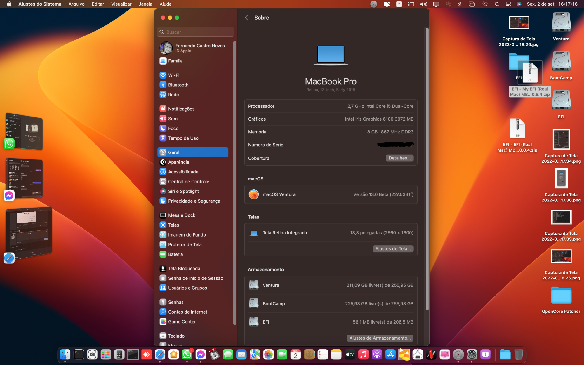

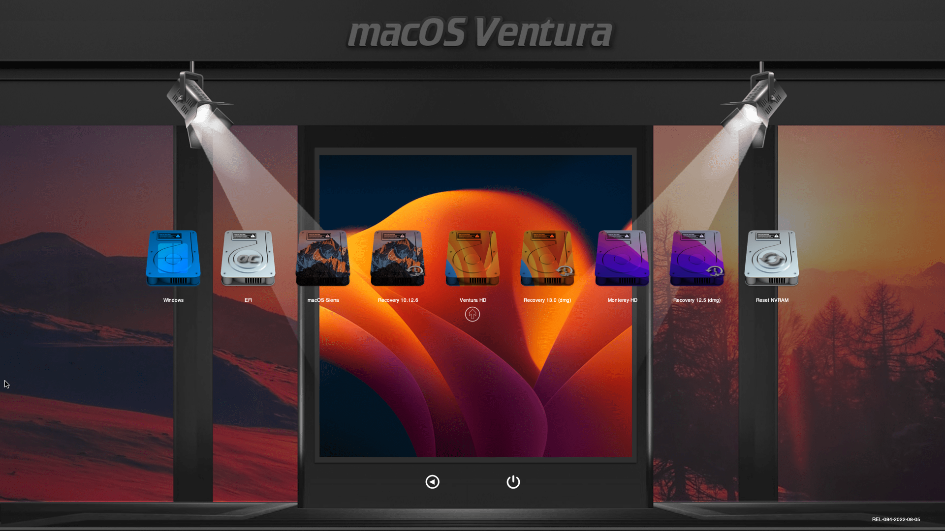

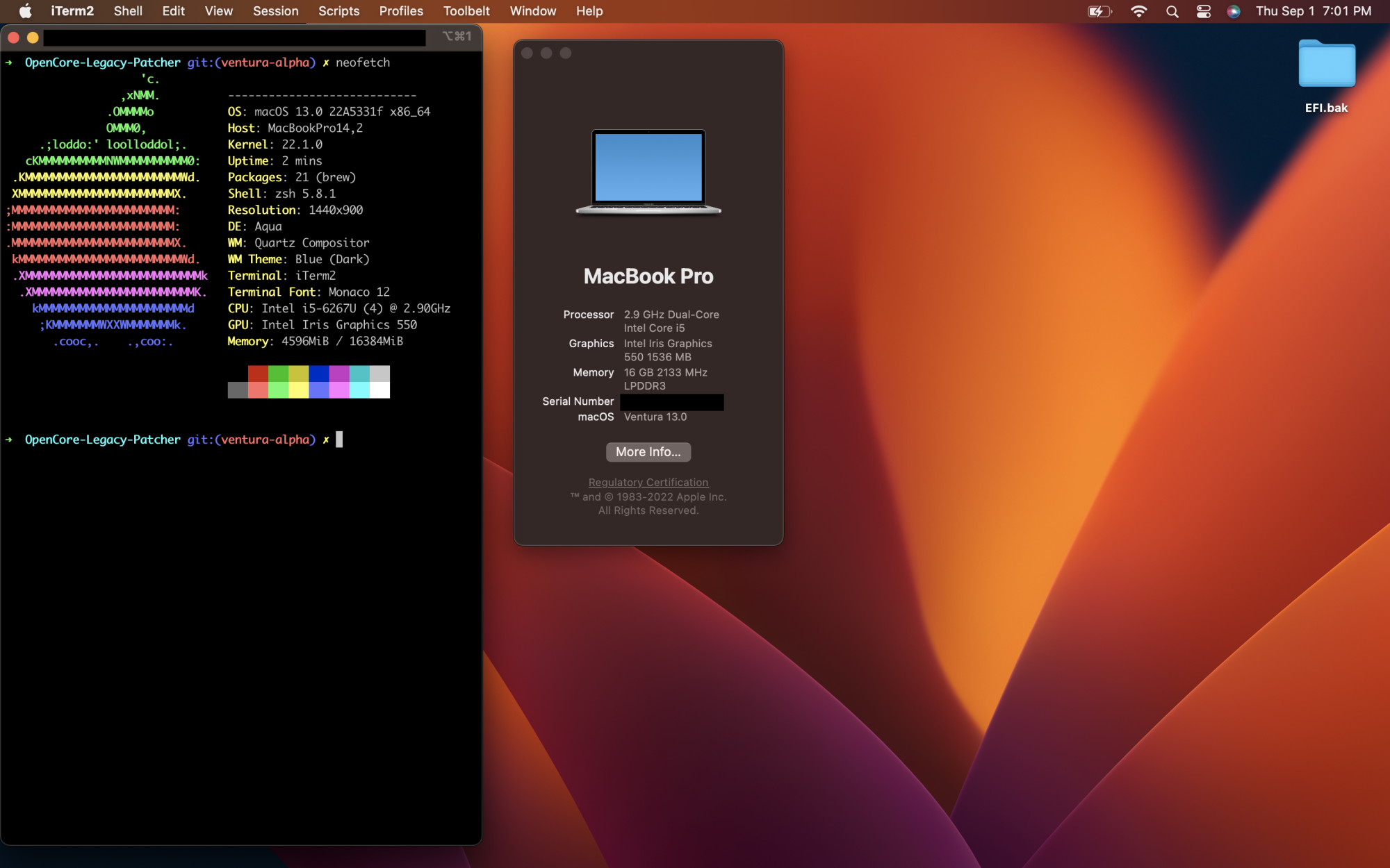

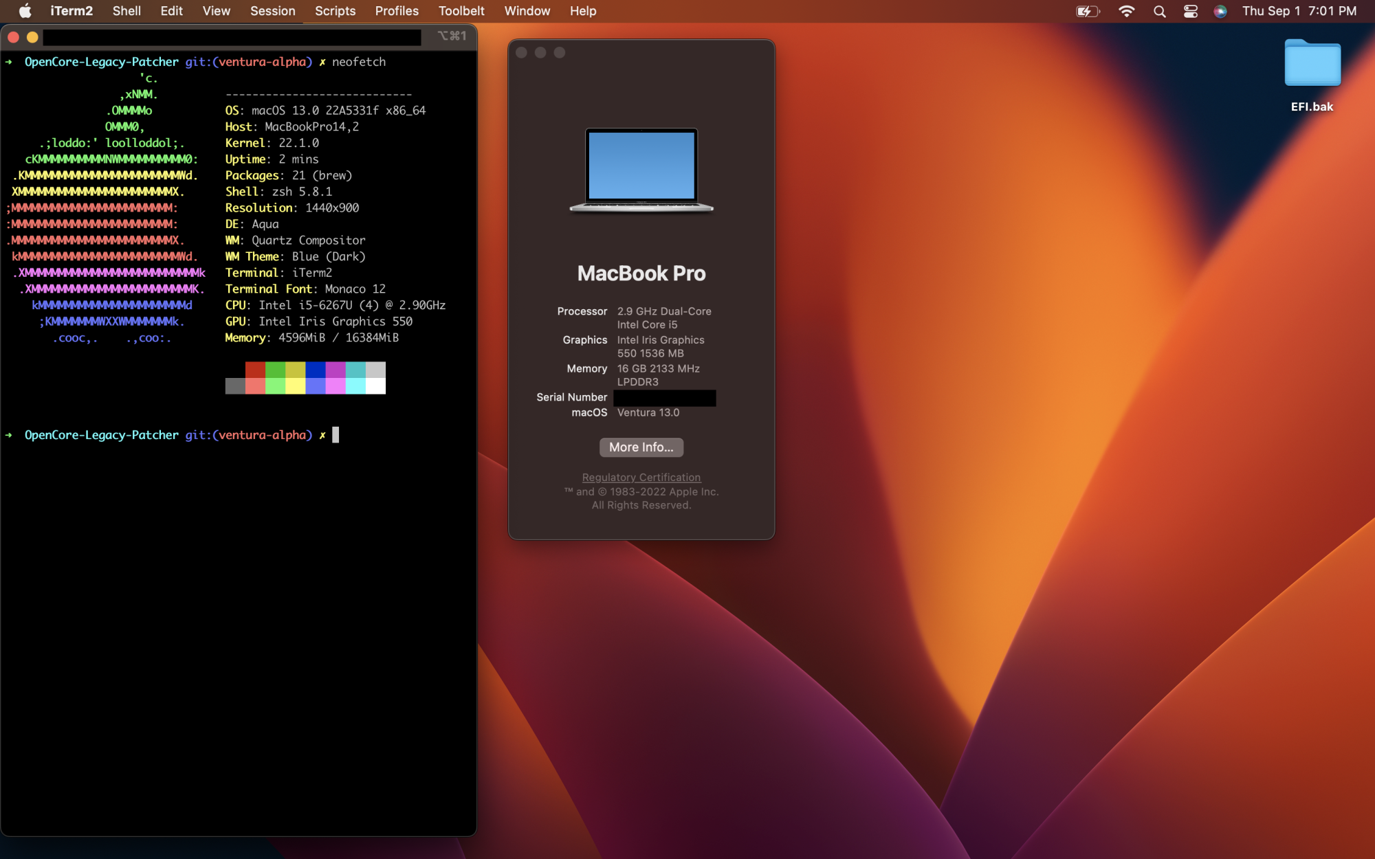

Hey all, lurker since page one here. Managed to get Ventura b6 installed on my MacBookPro13,2 Intel 550. Used the ventura-alpha branch. Pretty dang pumped, so I'm going to stress test a bit with some XCode builds tonight.

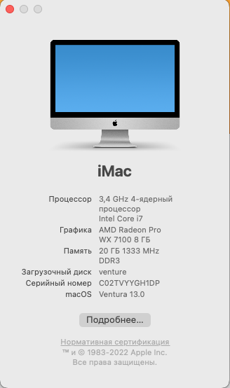

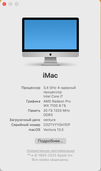

Ventura doesn't get to the end. Why? The video card didn't boot up or something?
And through the safe mode, Ventura is loaded. And I see an AMD WX7100 graphics card.
Kernel_Debug_Kit_13.0_build_22A5331f - must I?
In dortania GPU Buyers Guide your DGPU should work with Monterey, need's Lilu and WEG (Latest) in your EFI (OpenCore).
Download the kext's from this source, is the latest.

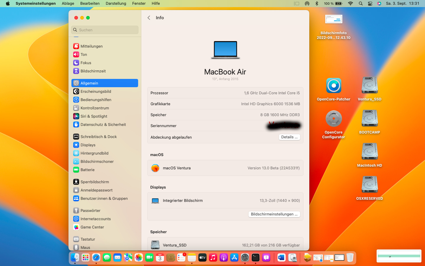

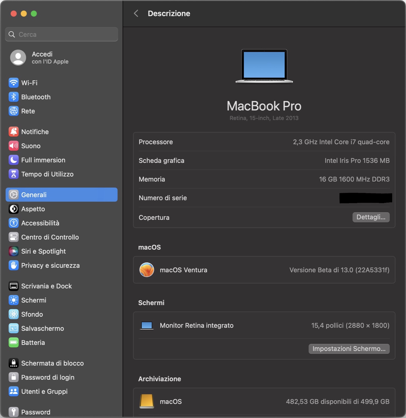

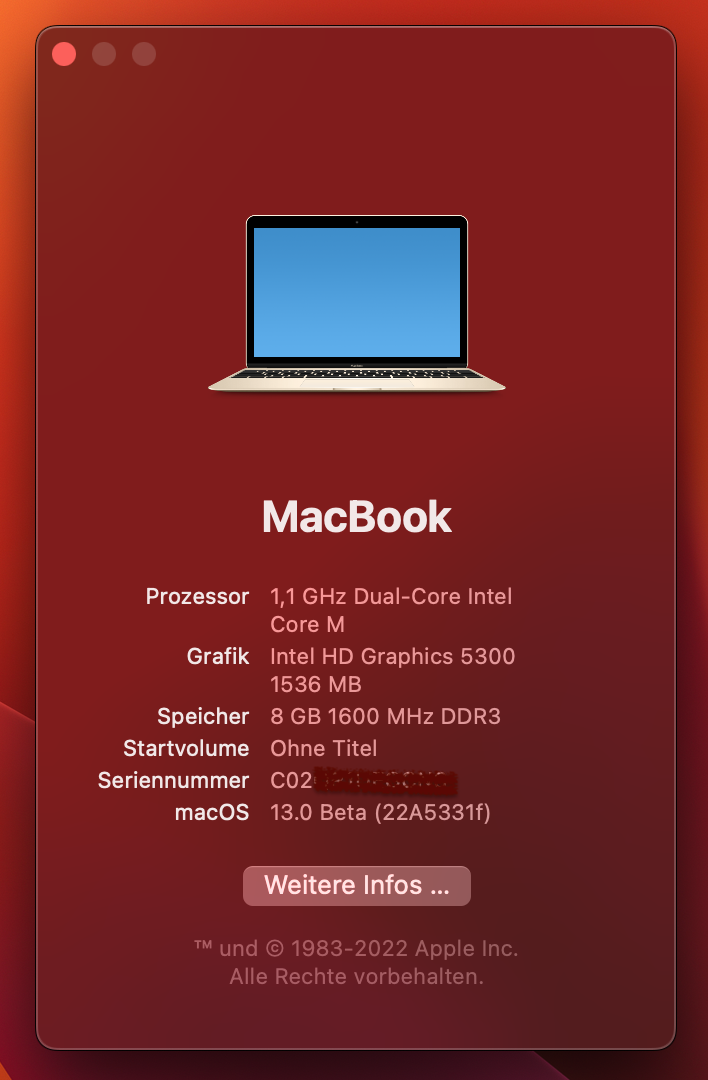

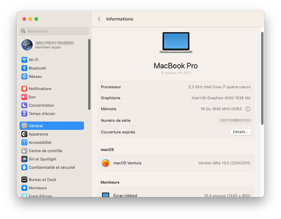

Success with yesterdays nightly on MacBook8,1 with Intel HD5300.
Of course, AMFI ("get lost") and _authenticate_root_hash for Rosetta's OS.dmg contents have to be applied as well as SIP 0xa03. Then after patching, metal works. Trackpad (full featured) and Wifi also oob.
Not sure, if Kernel Debug Kit still needed (have it still on the root volume) because Kexts seem to register nicely with Ventura asking permission to enable them via control center privacy settings.

last year, the same problem occurred in the Monterey system. I added the configuration to Openkore config.plist, and the Monterey system booted up to the end.
There are drivers in the Ventura system. I am a developer and programmer. I know for sure that Ventura has a driver for the W X 7100!!! Obviously, Ventura downloaded the video card. But the problem lies in the configuration of Openkore.
The fact that they write that Polaris and others have disabled it is not true!!!
Ventura requires AVX1 !!! And AVX2 does NOT require!!! We have to wait for Ventura's release. Then I'll figure it out completely.
