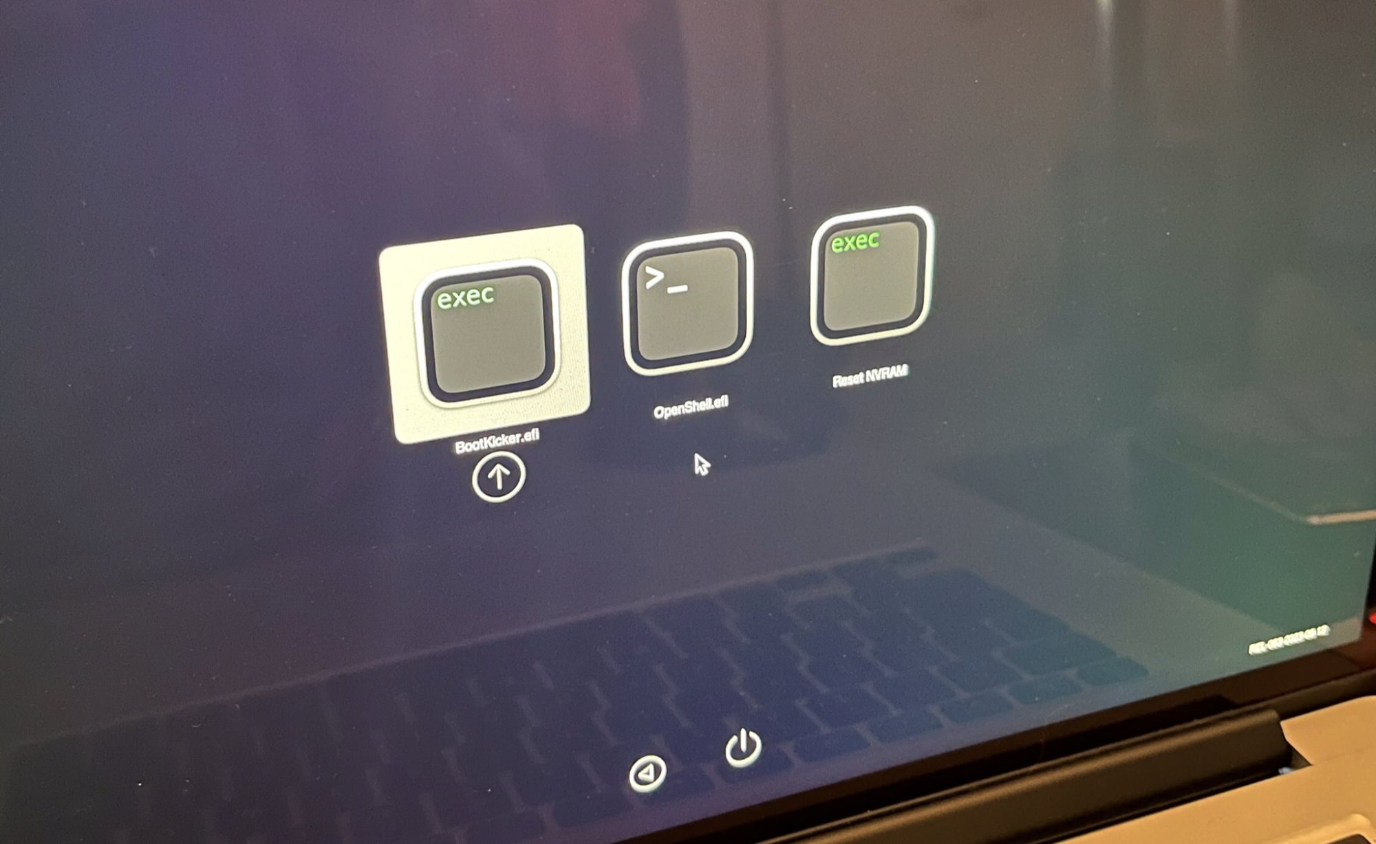

OCLP 0.6.8 installed.
post-install patches applied.
Reboot.
(not able to access OC extended menu as BT keyboard doesn't work at boot menu)
Error messages come back after few minutes.
Everything else OK, including BT.
Connected USB keyboard & mouse.
Reboot and access extended OC menu, Reset NVRAM selected.
Unable to activate BT after reboot.
Error messages back after few minutes.
Several reboots and power down/ power up performed.
Always no BT and error messages after few minutes each time.

Hi folks, I'm having sudden, terrible trouble with my Ventura install and I'm all out of tinkering options I can think of to get it going.
Summary: My MacBookPro11,2 (mid-2014 w/ integrated graphics only) turns on and the backlight comes on but there is no video for 5-6 minutes, after which it finally shows a folder icon with a question mark. At that point I can try to boot from a bootable USB drive made in OCLP, but the system doesn't behave as expected. When I insert the stick, after exactly 2.5 minutes it shows the bootable partitions of the USB drive, and I have like ten seconds to choose one or the system will go back to a blank screen and be non-responsive. Even if I do choose one in time, the system restarts itself rather than actually booting from the USB stick. It's quite a bad situation and I'm all out of ideas.
I think OCLP is "to blame" because if I take the drive out of the machine, it starts behaving normally with regard to external USB drives and everything is just faster. I don't know what went wrong; maybe my Mac installed an update overnight the other day that hosed the machine?
I'm basically asking for any ideas before I cut my losses and recycle this otherwise perfectly fine old computer.

Pressing Option does nothing. It's supposed to call up the boot picker, right? The screen just stays black (w/ backlight on) for 7-8 minutes even if the Option key is pressed the entire time (don't worry - I used a weight to hold the key down for that long). Then I hear the boot chime and presumably it just resets itself. No boot picker ever appears.
The only way I seem to be able to get one to appear is to let it try to start up and get to the point where there's a folder question mark icon, then insert a bootable USB drive, quickly select that option to boot from, but unfortunately it just resets itself and never boots from the external drive. :(
At this point I feel like what I need is to be able to erase this hard drive and start over with a fresh install, but I can't think of any way to do that with the puzzle pieces I have. I know that the external USB boot process works fine if I take the SSD out. Longshot, but... I don't suppose it's safe to insert an SSD into the empty slot on the motherboard after getting to the install screen from the bootable USB drive (i.e., hot-swapping)?

It means if I just run the machine without an SSD inside, suddenly the booting functionality works "normally" as in it quickly obeys pressing the option key to get to the boot selector. Obviously it doesn't properly boot in this condition since there's no drive. :)
Slight progress on my end! I installed OpenCore to a USB drive and was able to actually get it to do something! I was able to get the middle option working in this screenshot and access OpenShell.efi. It's responding to text input and everything. Does this do anything for me? Can I use command line to try to run patches on my system or something?
