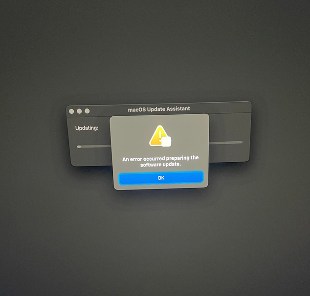

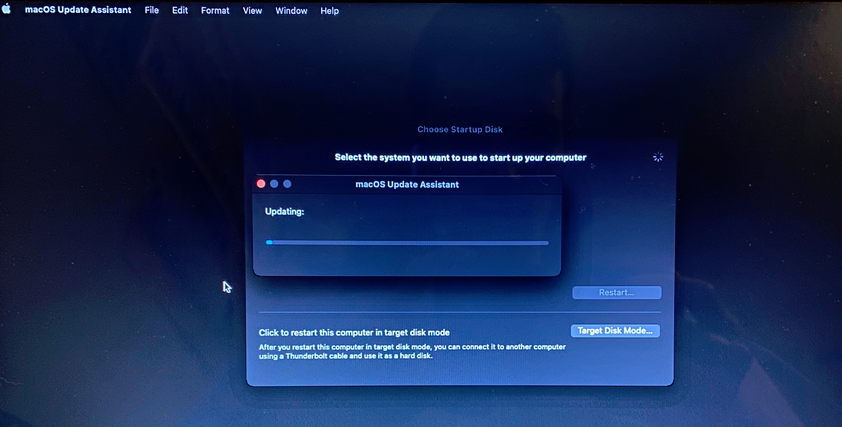

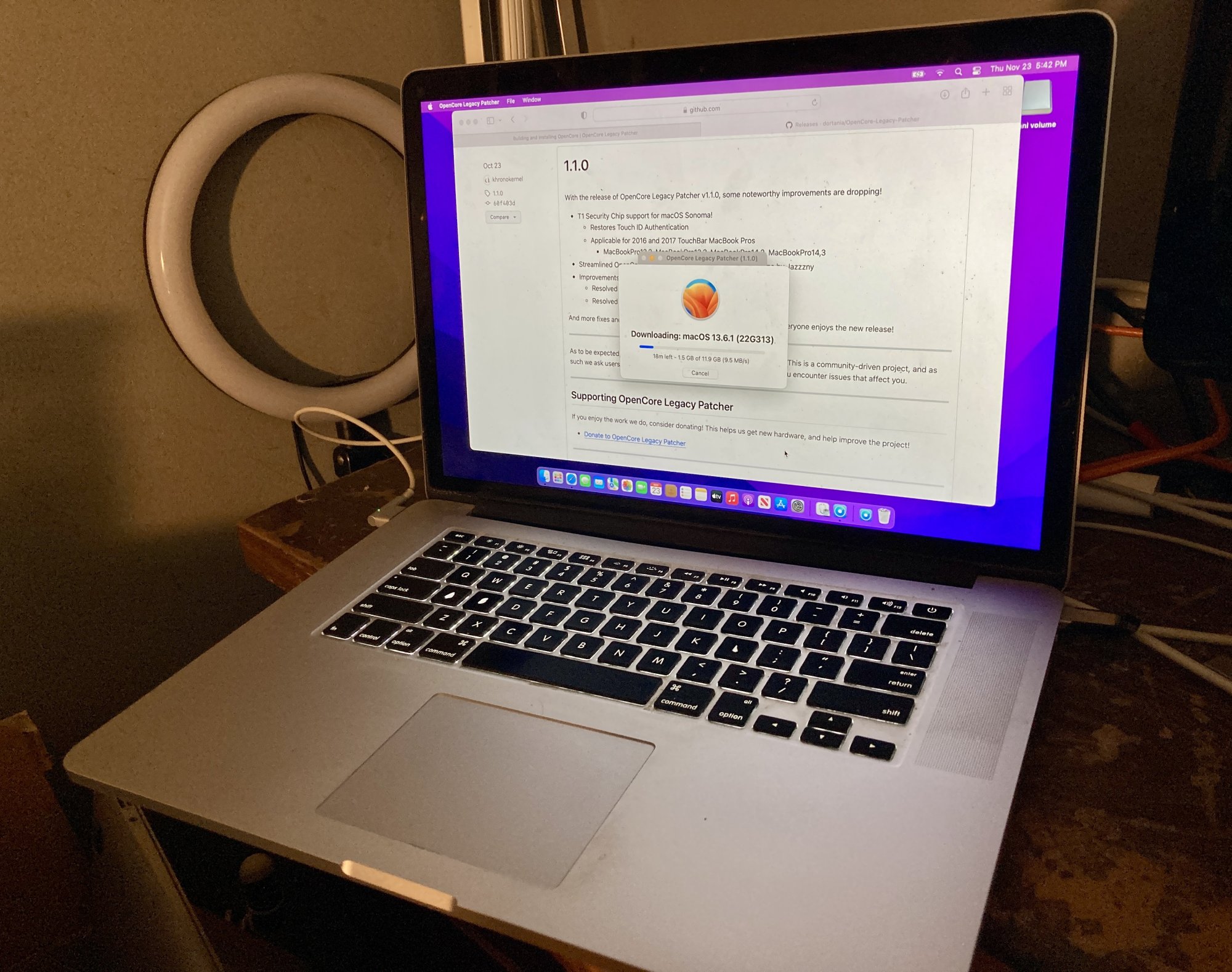

256GB 2015 MBP 15inch, latest OCLP and started this process using 12.7.1 Monterey. I think I screwed up, I don’t think i’ll get myself out of this one without losing my data.
How are you communicating with the forum? From another Mac?
In order to get that MBP working, you need to have a USB Monterey start up disk made with OCLP 0.6.8 or even 0.4.11 installed. After you have that USB key drive, insert it and start up the MBP while holding the Option key. When you see the EFI icon, use the Tab key to select the EFI icon on the right (hoping it is for the USB) and hit enter. That should bring up another window, Tab to the USB installer and hit Enter.
After that use the Install Monterey option to do an overwrite of the Monterey system. (Don't use Disk Utility to format the internal drive! We want to save your data!)

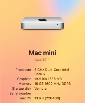

How can macOS 13.6.3 be a Beta when 22G423 is the RC? The current release is 22G430, it is either RC2 or the final release. 🤷‍♂️
"either RC2 or the final release."
The Mr. Macintosh site doesn't have anything with the version number 13.6.3, and as he is almost always up-to-date, I suspect the 22G430 13.6.3 we have (OTA for me) must be an RC.

The Developer Beta toggle was set to off in Software Update when OTA d/l 22G430. Only releases can occur with that setting. 🤷‍♂️ It remains set to off, btw. Time will tell? 🤔 22G430 runs perfectly w/OCLP v.1.2.1, here. 🤗

macOS 13.6.2 is Apple Silicon exclusive, so far. 13.6.3 OTA Build 22G430 appears to be intel specific. The changing of the guard is underway. :apple::eek:🙃

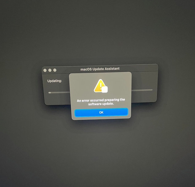

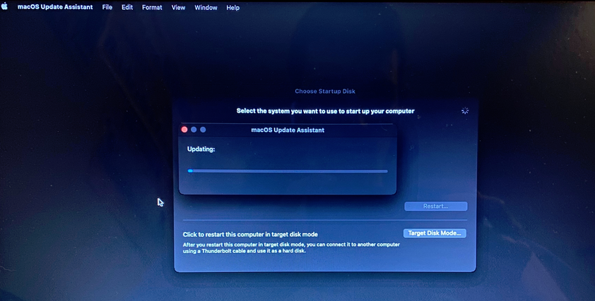

Big headache: two very frustrating install attempts yesterday and today to Mac Mini Mid-2010 4,1. Both installs errored out at approx 14 minutes with error software failed something...., don't remember the exact wording. Screen I'm brought to shows frozen MacOS Update Assistant with option beneath that to restart. Back in startup volume, seeing Ventura-Data volume on Desktop with approx 14GB used, so the install must have progressed at least to a certain extent.
Target drive has loads of empty space. Internet connection is good.
Not sure what to try next. Yesterday after trying a second install, the startup volume then showed Ventura-Data and Ventura Data-Data, which seems like the second install just reinstalled the first -Data. So don't want to simply repeat that. Nothing like this happened with the install to the iMac 10,1 some weeks ago using same procedure, but this time with new USB drive formatted for the Mini 4,1.
After today's failure did an SMC Reset, and yesterday a PRAM reset. Also before trying second install today, erased target drive.
Any help or suggestions appreciated.

Did a search for "MacOS Update Assistant". The first hit which is from ASC (MacOS Update Assistant frozen) https://discussions.apple.com/thread/252414874 gives a link to Mr. Macintosh https://mrmacintosh.com/big-sur-upgrade-not-enough-hd-space-serious-issue-possible-data-loss/, which is mainly concerned with the upgrade to Big Sur involving either not enough disk free space - how to recover free space, or dealing with File Vault enabled. Neither is my problem, since no File Vault and the drive in question is 270GB minus a little for formatting.
In any case, this is the frozen Update Assistant in question, and the error, or similar: error occurred.png
