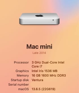

macOS 13.6.5 RC installed atop 13.6.4 via USB, OCLP v.1.4.0n. Runs better than expected, didn't have to install the root-patch! Behaves like a supported Mac. YMMV :apple::cool:
13.6.5RC.jpgImportant edit! Upon acquiring the Install Assistant from the Discord OCLP Paradise updates, when building the macOS 13.6.5RC installer USB w/OCLP v.1.4.0n, OCLP mis-identified the OS version as macOS 13.6.2, a Apple Silicon ONLY version of macOS. Yet, proceeding to build the USB yielded a perfectly functional macOS 13.6.5RC build 22G619 installer. So, this may be a bug in the Create macOS Installer function of OCLP v.1.4.0n? In case anyone else may be deterred by this in-process mis-identification bug. :eek:

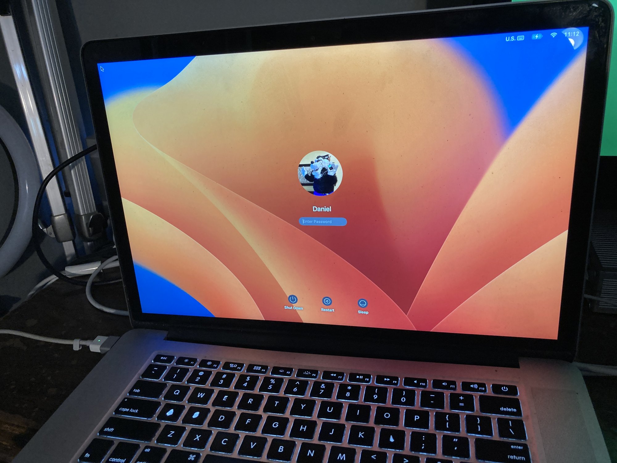

I wonder if that's why I've been getting that problem I mentioned. Once a week now, my MacBookPro11,4 running any version of OCLP since 1.0.0 starts to have trouble booting, and when it does, it's all sluggish and the buttons and text fields are greyed out like this, as if there were no root patches...
And if I try to apply the root patches, the loading bar moves to the bottom ala Mac OS 14 Sonoma and the volume is bricked! But now when I see it grayed out like I mentioned, I reboot right to my patched USB installer and re-install Ventura, temporarily fixing the problem.
I think it's trying to force an upgrade to an Apple Silicon version of Sonoma! So for now I am downgrading it to 0.6.8 and will have to suck up having the weather widget not working.

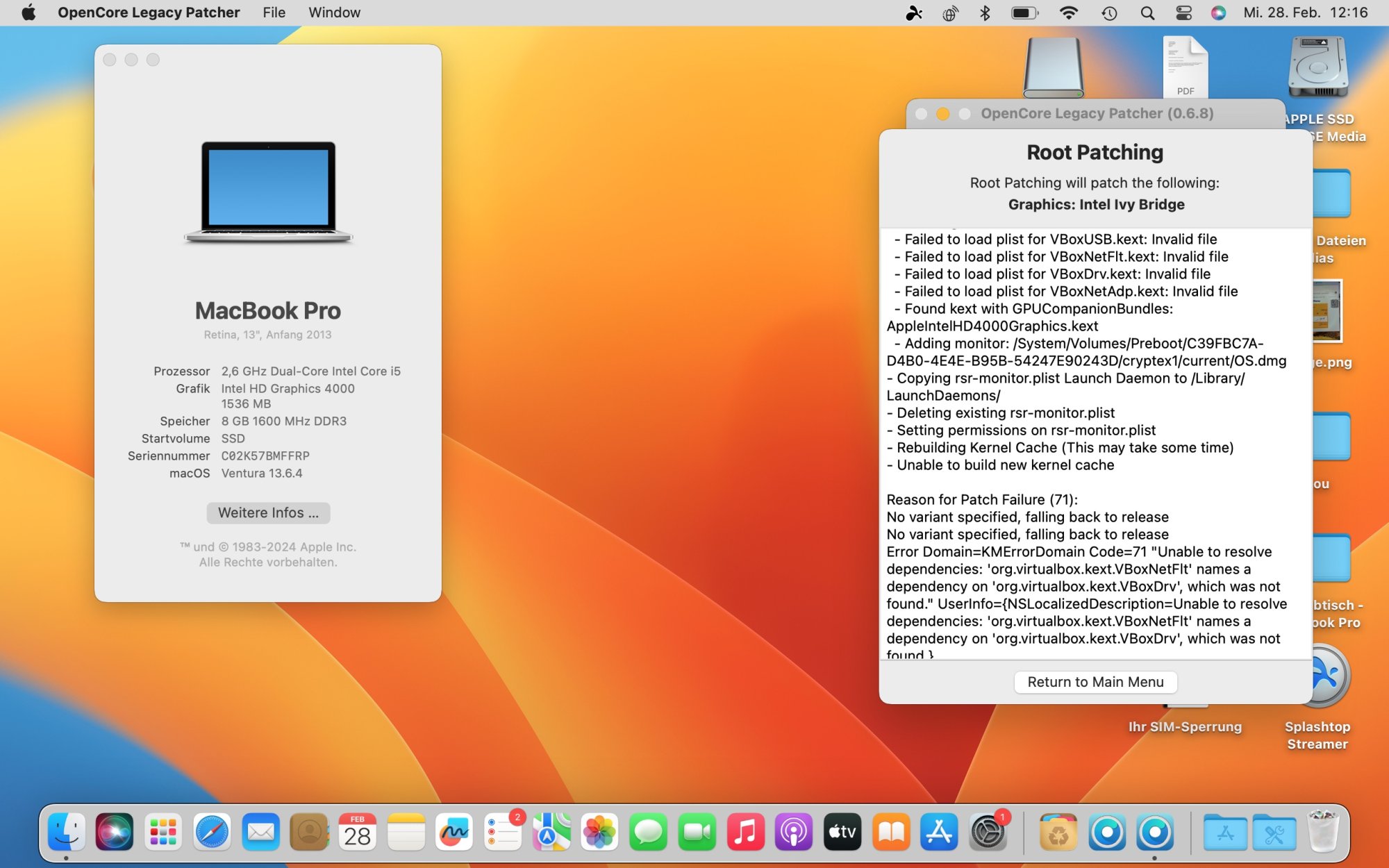

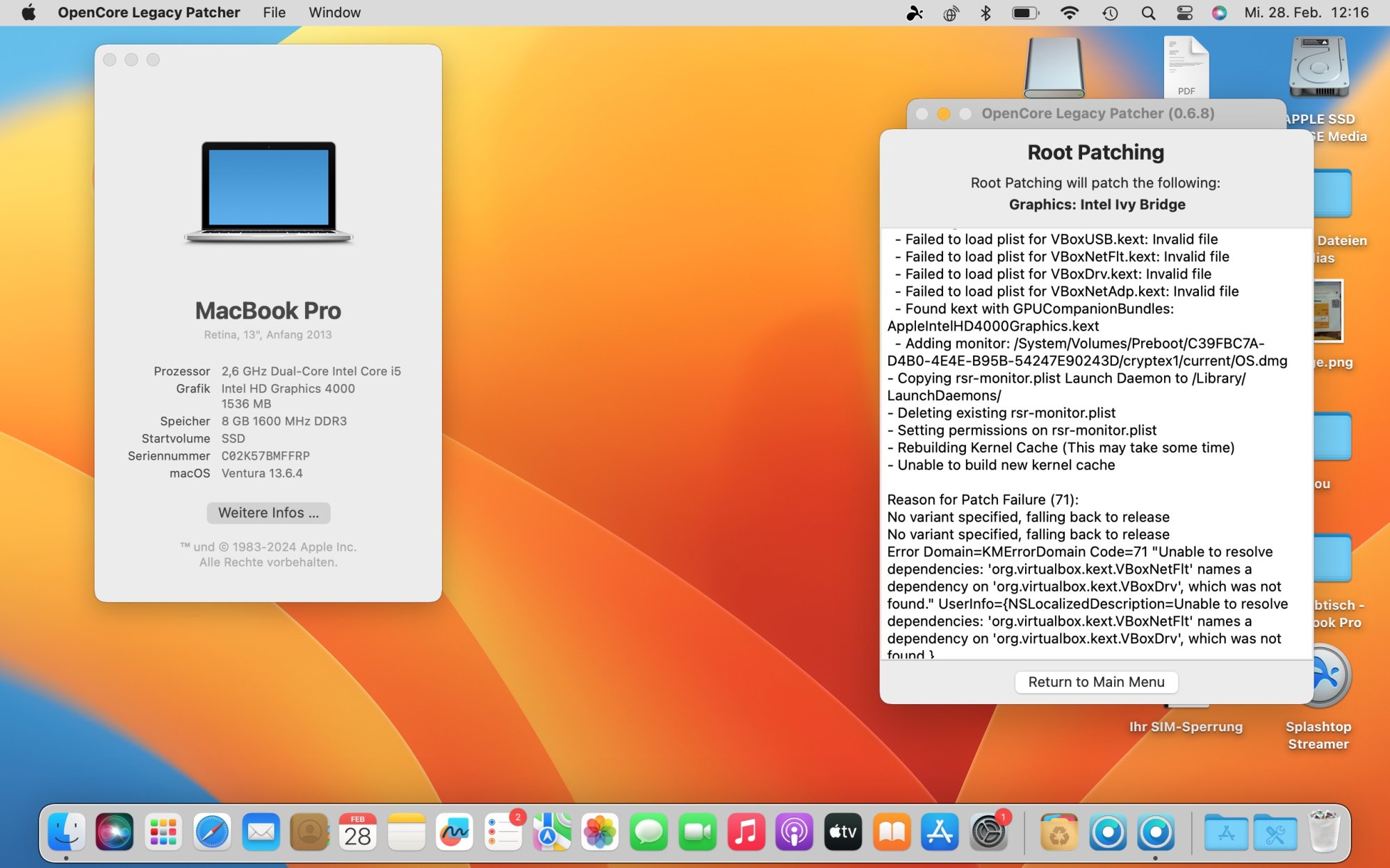

Root patching failure on MacBook Pro 10,2 (OCLP 0.6.8)​
Can someone pls point me into the right direction about this following issue?
I installed Ventura 13.6.4 with OCLP 0.6.8. Installation was smooth. However I cannot apply root patch for IVY Bridge. See screen shot. "Unable to build kernel chache. Reason for patch failure (71)"

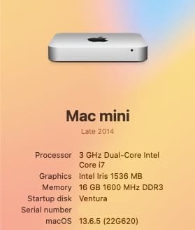

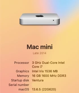

macOS 13.6.5 RC2 installed atop 13.6.5 RC1 via USB, OCLP v.1.4.0n. Runs better than expected, didn't have to install the root-patch! Behaves like a supported Mac. :apple::cool: YMMV Please note: OCLP Build USB function still mis-identifies installer as macOS 13.6.2! :oops:
Reactions: paalb and deeveedee

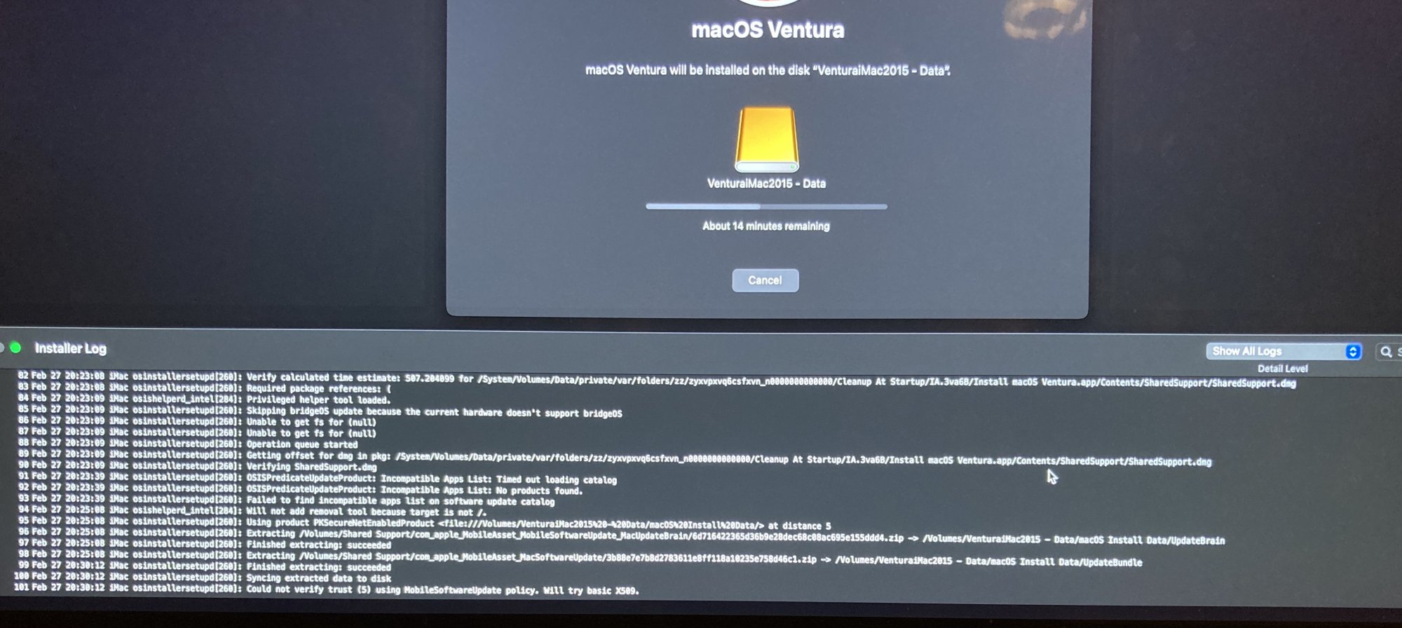

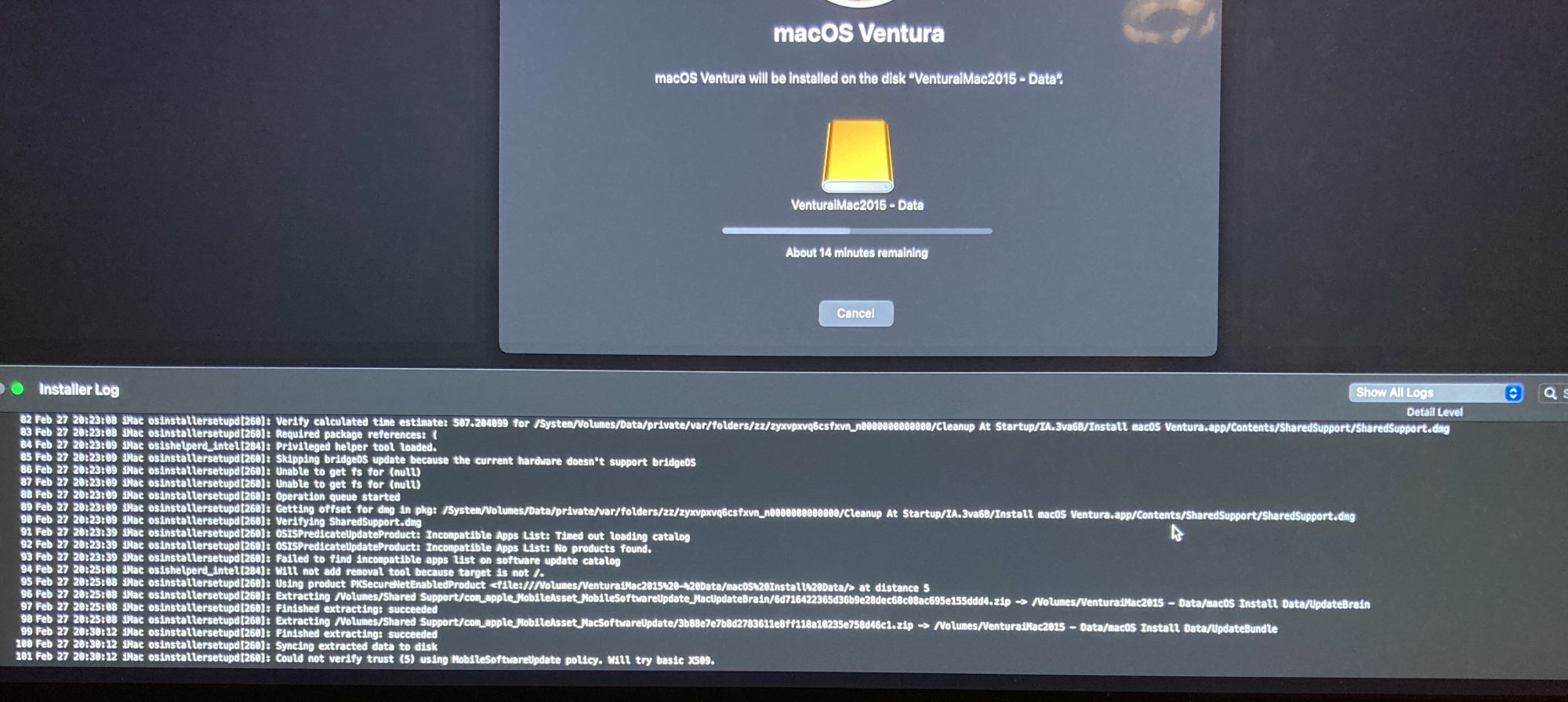

macOS Mojave iMac 10.14.6 on a late 2015 iMac with 16GB RAM.
I've tried OCLP 0.6.8, 1.2.1 and 1.3.0. Creating the bootable IOS Ventura installed seems to go OK. But it always get stuck exactly here at exactly 14 mins when attempting to install the OS to an external SSD drive. I've tired one brand of 32GB USB stick and another of 64 GB stick as the installer drive.
Syncing extracted data to disk
Could not verify trust (5)...
Then it hangs with mouse and keyboard still working for about 5 mins, then they freeze with the above on screen.
The target is a Crucial 2TB SSD with no faults that Disk Utility can detect. I'm wondering where I'm going wrong.
Why installing macOS onto Data? 🤷‍♂️
