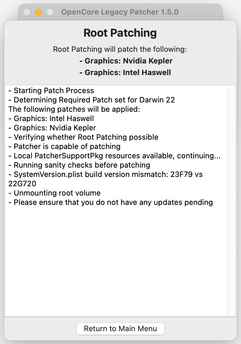

The version of OCLP 1.5.0 has now been released. However, I have discovered a bug.
When I try to install the root patches on macOS Ventura, the installation aborts with the message “Please ensure that you do not have any updates pending
This refers to the update to macOS Sonoma which is pending. But users of macOS Ventura deliberately do not want to install this. It is therefore no longer possible to install the root patches on macOS Ventura because the update to Sonoma is pending.
Can other macOS Ventura users reproduce this bug?

I can't: 1.5.0/13.6.7/MBP10,2 works flawlessly.
Reactions: K two
Maybe an update is lurking on your mac.
Is there a folder here?:
/System/Library/AssetsV2/com_apple_MobileAsset_MacSoftwareUpdate/
Are this files present?
/System/Volumes/Update/Update.plist
/System/Volumes/Update/Preflight.plist
Please state your mac Model Identifier.

I have exactly the same situation. iMac 8,1
- Starting Patch Process
- Determining Required Patch set for Darwin 22
The following patches will be applied:
- Graphics: AMD TeraScale 1
- Brightness: Legacy Backlight Control
- Audio: Legacy Realtek
- Networking: Legacy Wireless
- Miscellaneous: Legacy USB 1.1
- Verifying whether Root Patching possible
- Patcher is capable of patching
- Local PatcherSupportPkg resources available, mounting...
- Mounted Universal-Binaries.dmg
- Running sanity checks before patching
- SystemVersion.plist build version mismatch: 23F79 vs 22G720
- Unmounting root volume
- Please ensure that you do not have any updates pending

Me too iMac 14.2 Ventura 13.6.7
Yes I have this folder and the update.plist but not the preflight.plist. Should I delete them ? I have an iMac 14.2 Ventura 13.6.7
Important! Do not try to delete the "com_apple_MobileAsset_MacSoftwareUpdate" If there is a folder inside it you have a downloaded installer and you should delete it. The Preflight.plist as well.
Edit: So this is just a hunch. I do not know if it will help. But there is no harm done by deleting them. I have done it on several macs in the past.
