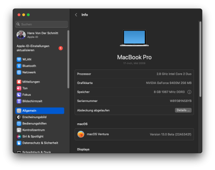

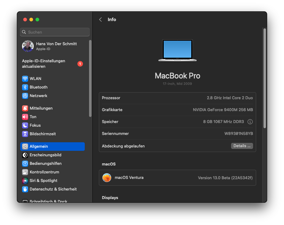

Once again - tried macOS 13.0 beta 6 on MBP5,2 mid 2009. The Rosetta library still does the job to enable a bootable system on non-AVX machines.
This time had to download the IPSW file for beta 6 (UniversalMac_13.0_22A5331f_Restore) via my developer account as MrMacintosh says. Put into place on the external target SSD while booted from the internal 12.5.1.
Using the latest OCLP ventura alpha 0.5.0 which contains the changes for KDK-less, which should matter only for post install patches.
A few window server crashes, needed to do a PRAM reset, and to use external mouse/keyboard as usual for Ventura tests on this machine. No post install patches exist, i.e. no graphics acceleration etc: just a non-AVX test. Still able to write this in Safari 16.1 on 13.0b6.
Same procedure and result with 13.0b7. OCLP 0.5.0n from 13Sept used.
A few WS crashes, esp. during 1st login after 1st boot. Not surprising, one of the crash logs attached.
Writing with Safari 16.1 on my MBP5,2. No graphics accel of course, but still amazing.
Thanks OCLP team and all contributors.

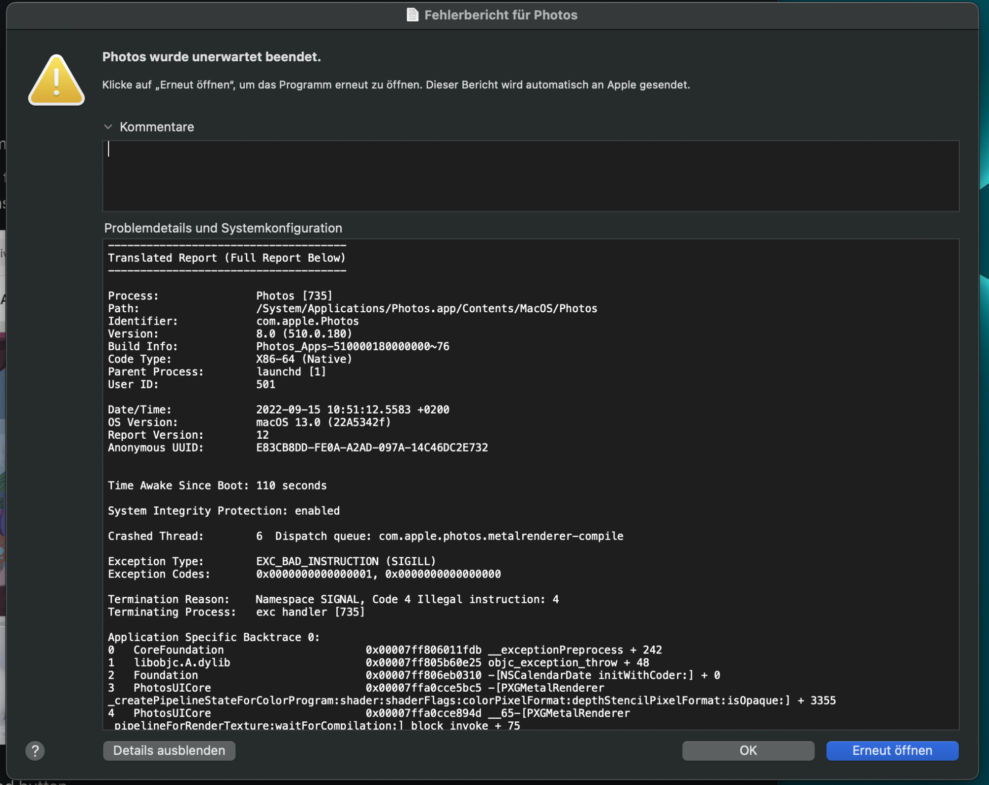

Maybe you can help me... I get this error message when I open the photos App. I have a 17,1 Mac with the latest alpha OCLP on Ventura. All other thinks working fine.

Had this Photos crash in Monterey betas more than a year ago on (non-metal) MBP5,2, see #820 . It went away with a release of Monterey. Not sure it will this time as apps rely more and more on Metal explicitely (but I may be completely wrong as I don't know about your mac model).
Maybe try to use an earlier version of Photos (7 not 8)?

Thanks for your answer... how can I get an earlier version? I think it's a graphic problem but I don't know why. Every solution is welcome

Same as you. iMac17,1 spoofed as 18,3. Developers have this as an issue of 0.5.0 alpha. I have read in OCLP GitHub that the issue is solved a few builds ago but my Photos crash although I have last compiled OCLP-Patcher.
Photo's App won't open / Non-Functional / Intel Broadwell and Skylake iGPUs / Resolved with c064269
Go to Graphics Acceleration.

Exact same for me here, iMac17,1, latest OCLP from today/yesterday. With new root patches and new built and installed OCLP...
I guess we need to wait for a new nightly...

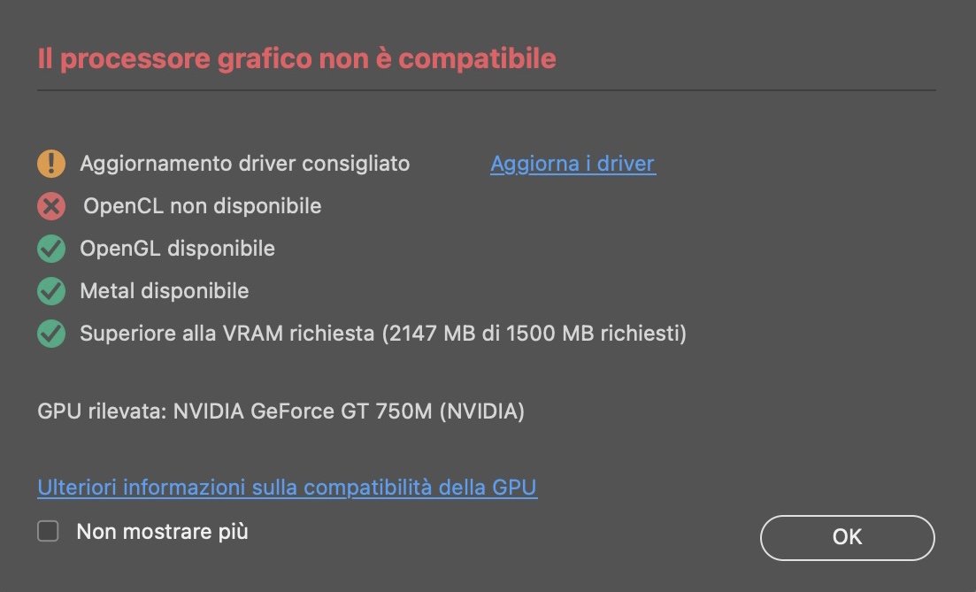

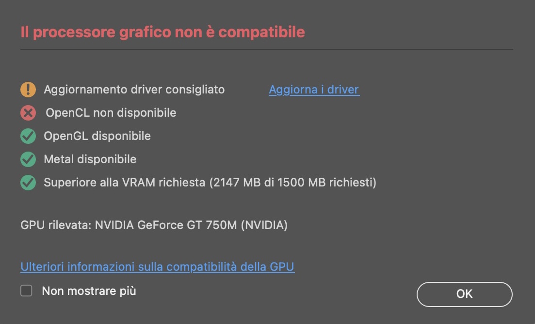

Just FYI (but probably already known by the developers): the latest Photoshop reports the Kepler dGPU of my MBP11,3 (KDK-less root patched for Intel iGPU and Nvidia dGPU, on an external SSD for experimenting with Ventura, with the latest alpha OCLP 0.5.0) as partially unsupported: so, it looks like currently it has no OpenCL support in Ventura (while in Monterey it passes all checks, OpenCL included); let’s hope that all this can be fixed in a future OCLP release…
