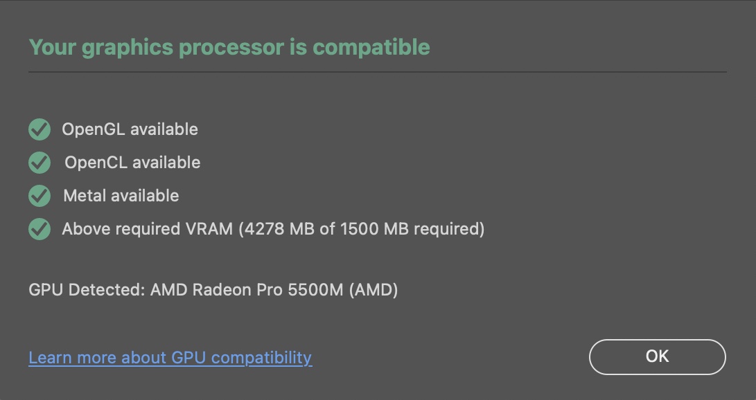

what above picture means, please translate it with google lens

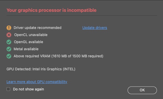

Here is a similar Photoshop GPU compatibility check in English:
… while after the OpenCL fix in the latest nightly alpha, it is similar to this:
(pictures taken from Google).
That's very simple without any Google:
The graphic processor is not compatible
Driver update recommended
OpenGL & Metal available
Higher than VRAM request
GPU detected: NVIDIA GeForce GT 750M (MVIDIA)
hello friend,
Is there a fix for the openCL not compatable/Photoshop message in Monterey 12.6 on a 5,1 cMP w/GTX-680 using oclp 0.4.10?
Thanks!

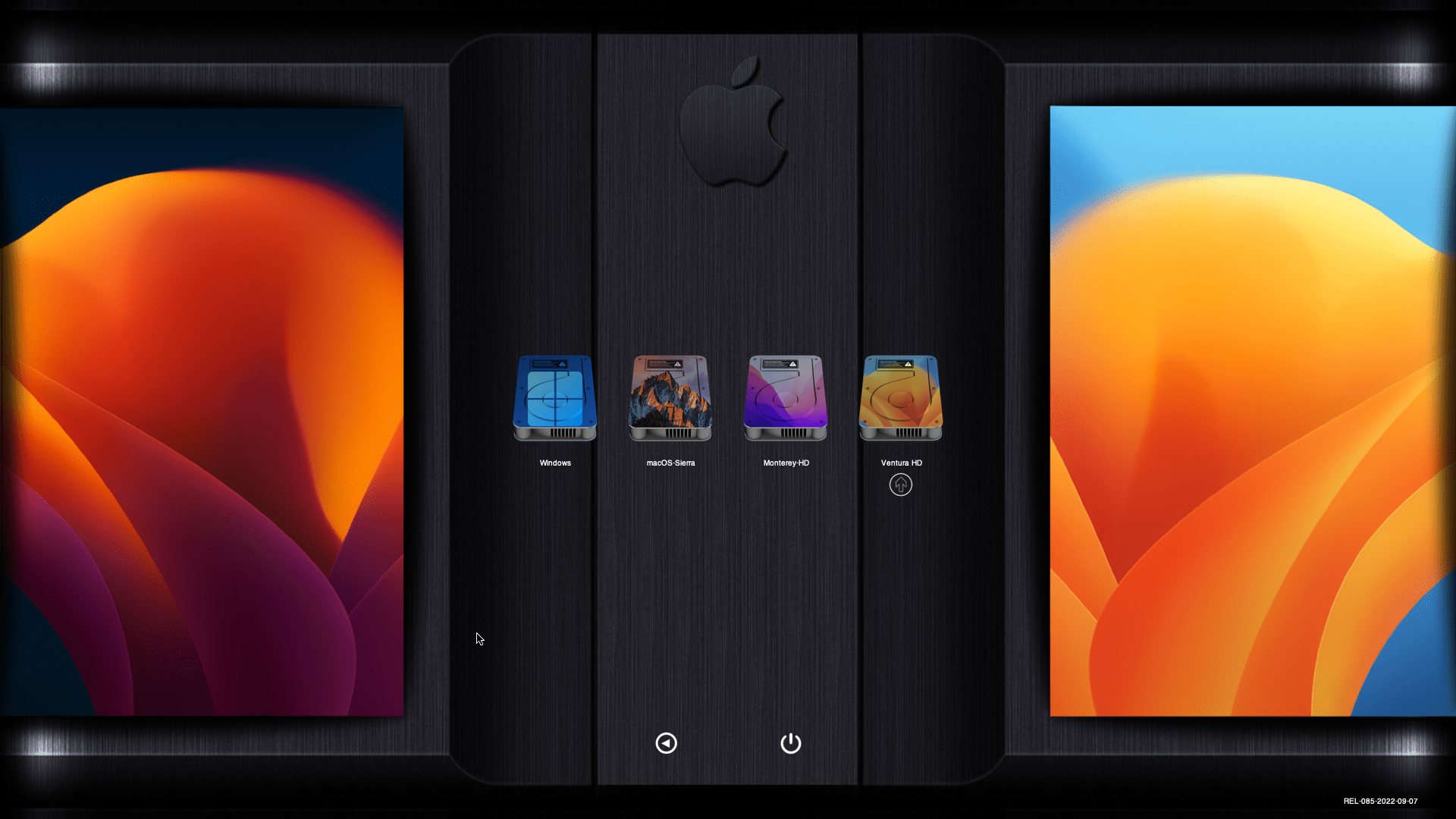

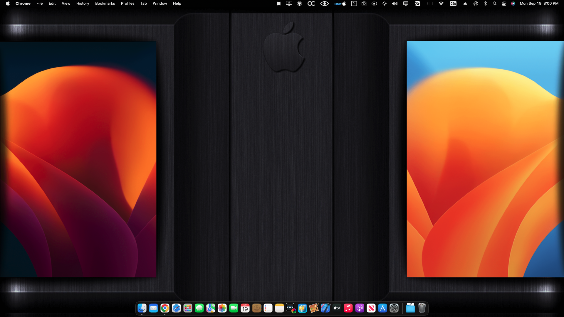

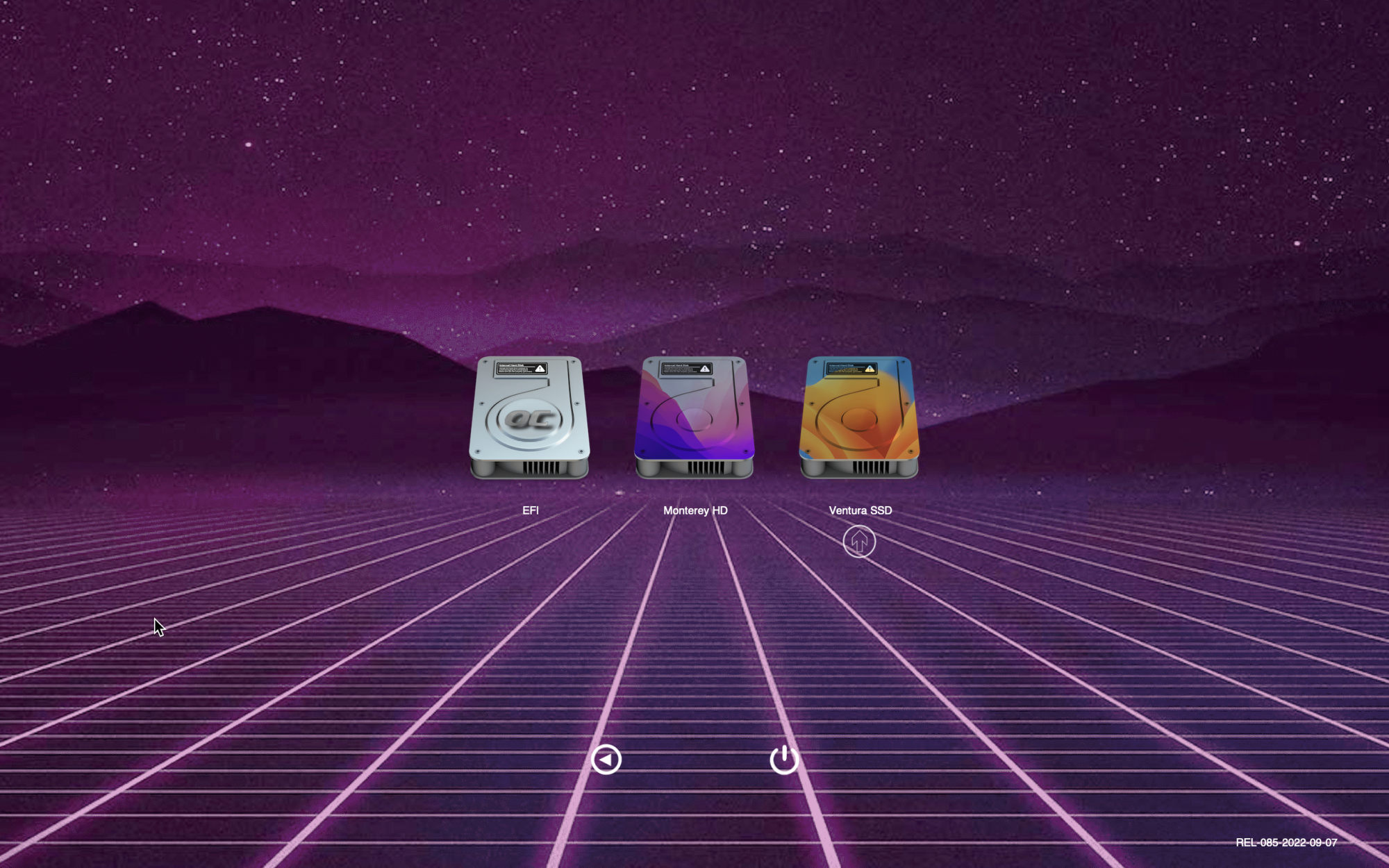

This one is not bad at all in Desktop image and OC boot screen:D
Attaching 5 K image background .ICNS

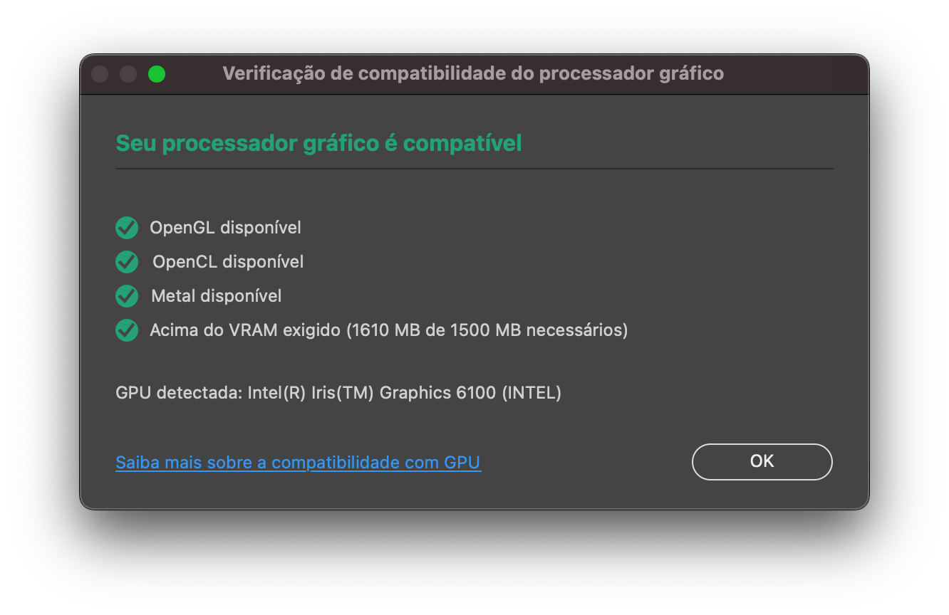

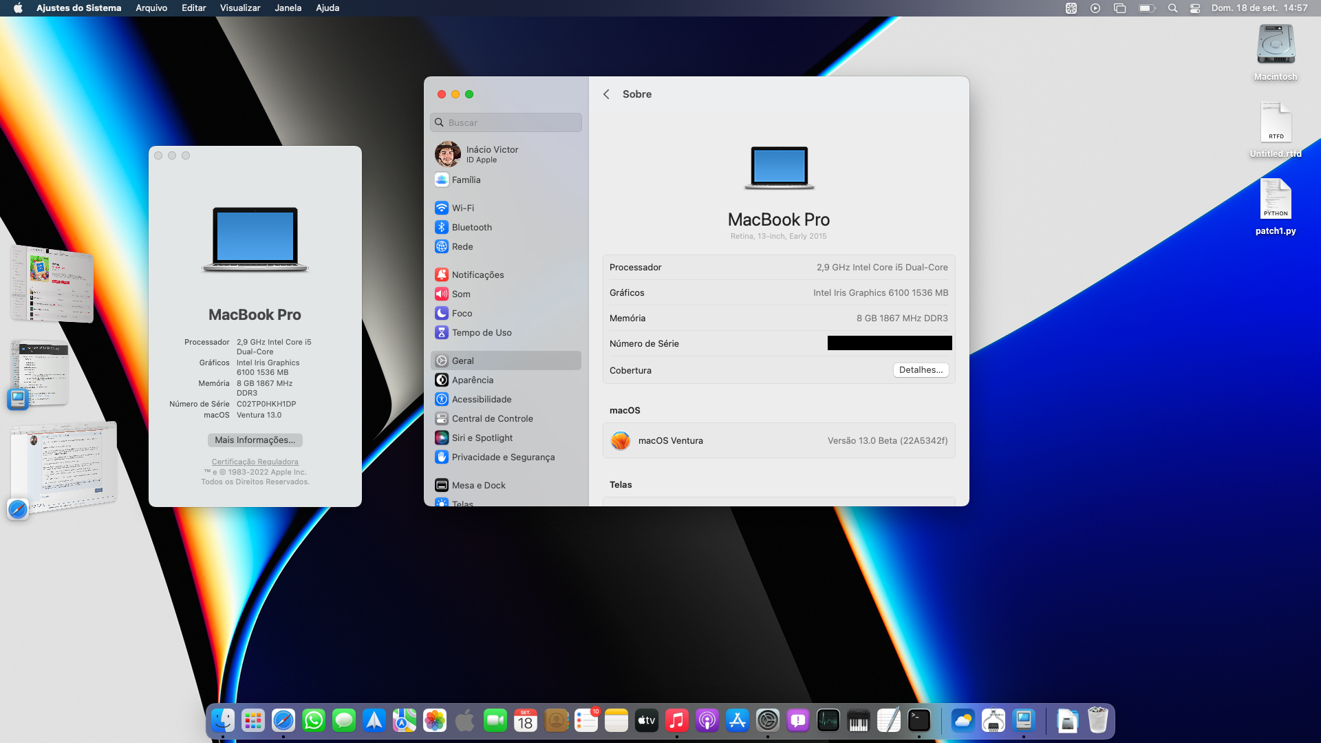

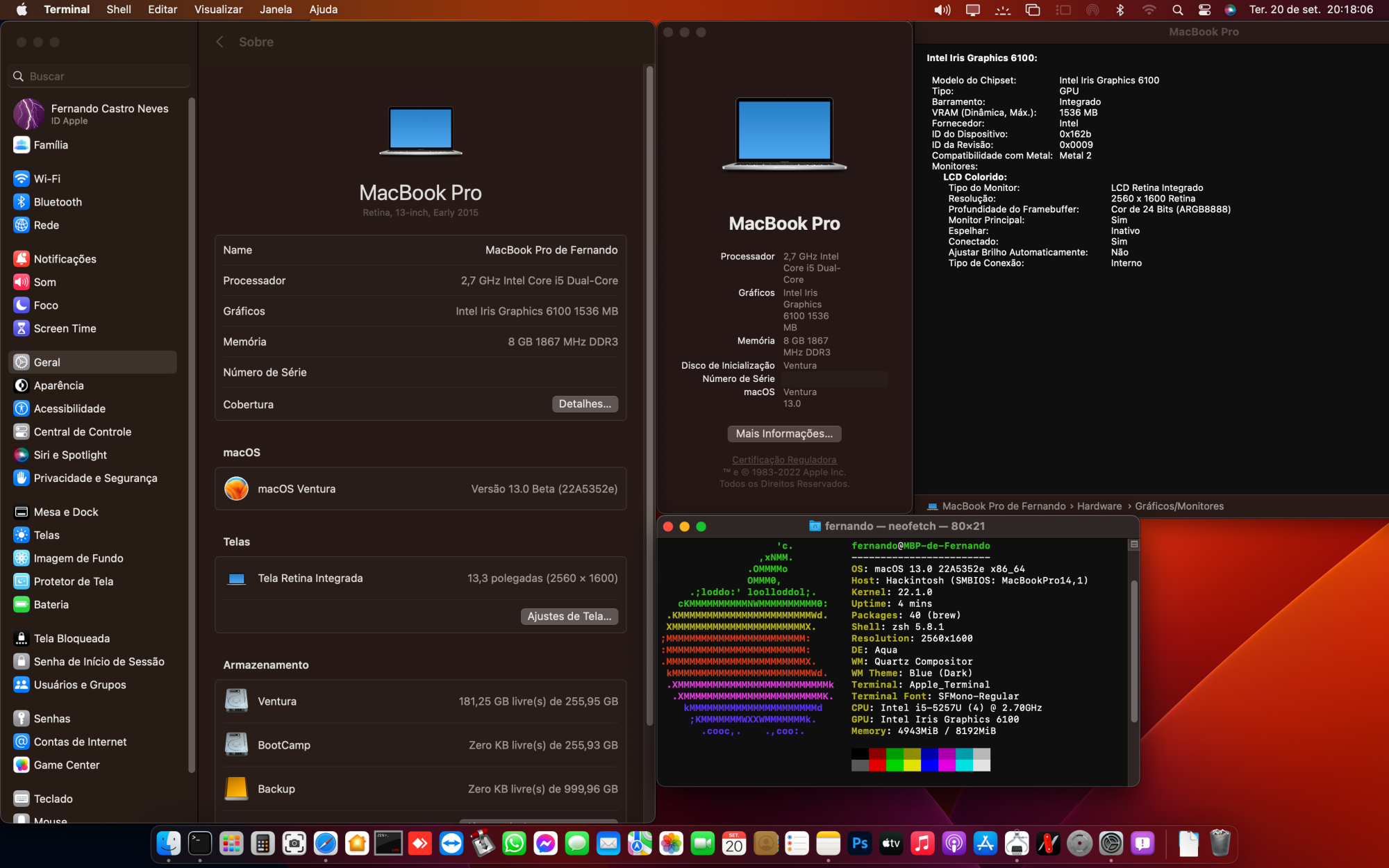

Real Mac (MacBook Pro 13'' Retina Early 2015 (Broadwell) - OCLP 0.5.0 ventura-alpha branch. Ventura 13.0 Beta 8.

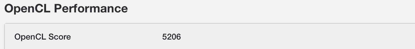

Real Mac (Intel Iris Graphics 6100 - 1536MB) => Working with Photoshop 2022 (Ventura 13.0 Beta 8)

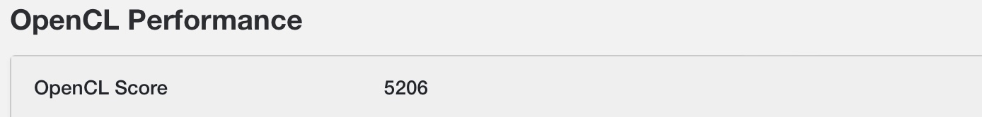

Download GeekBench5 and run the OpenCL benchmark, this is the more interesting test case than simply calling the simple PhotoShop GPU detection. The latter does not even prove OpenCL may work at all.
Run test on MacBook Pro 2014 running beta 8 work on iris pro test crashes on nvidia 750m.
