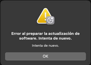

I usually revert root patches to make the download size smaller, then reboot, normally, update OTA, then re-patch.
This time, going from 13.0 to 13.0.1
I receive a message saying “failed to prepare update. Please try again“

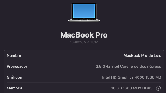

MacBook Pro 9.2 OPCLP 0.5.1 and on 0.5.2
got the same error done with out the re-patch:
and OCLP 0.5.2
Well I just download all 12 GB and works the update !!
its gone take some time so be patience on it
