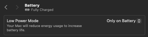

@BuffyzDead Thanks for the tip! Downloaded the free version and am testing now. I have also enabled Low Power mode on battery.

I was mixing up my Macs - I reported in my previous post that I enabled "Low Power Mode" on battery. This option was not available on my MBP6,2 running Sonoma patched with OCLP 1.3.0n. This might be because of something I did and I'm checking this.

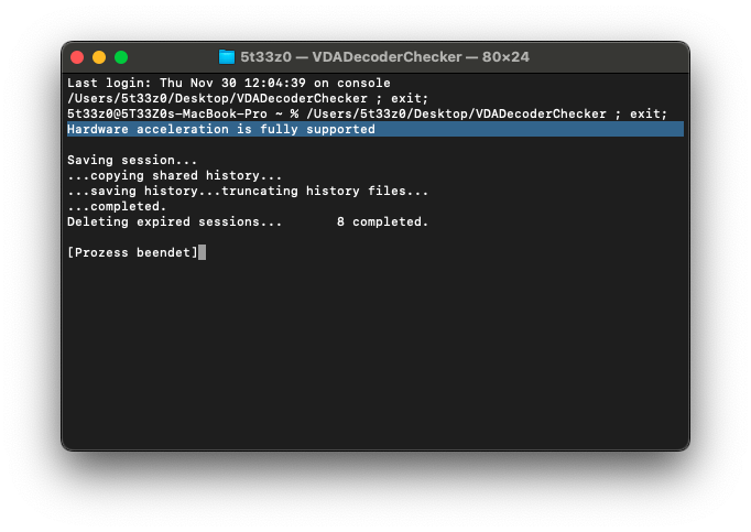

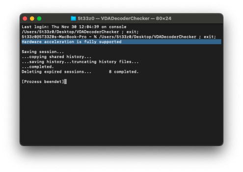

Is there a special reason why you checking it this way?
Initiating Humour-module…
Print: "Only to feel that extra bit more special. ;) "
…End of humor.
Seriously, VDADecoderChecker checks if h264 decoding works on-board graphics. And if it does, iGPU acceleration as a whole is working - beyond all doubt.
