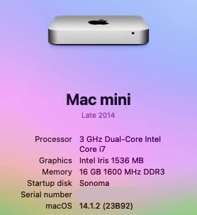

macOS 14.1.2 (23B92) with KDK_14.1.2_23B92.pkg works like a charm with newest 1.3.0n on MP5,1 | RX580 | 990 Pro NVMe - big hug to the OCLP Dev - Team as always ;-) 😍 (MacMini's, iMacs and MBP's 11,X 12,X also OTA from 14.1.1 to 14.1.2 as expected) Great Work OCLP Dev Team love it!
