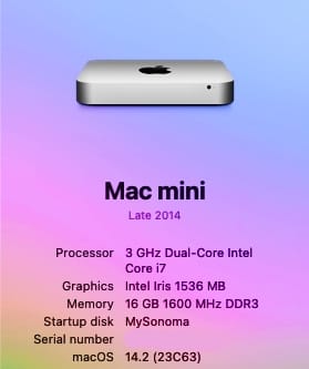

I used OCLP to generate a serial but I could have specifiied it.I'm familiar with serial spoofing with Open Core (happens all the time in the Hackintosh world), but I haven't used the OCLP GUI to do it and am not in a position to test it. Forgive a naive question: When you "spoofed" the serial with OCLP, were you able to specify the serial or did OCLP generate a new one for you? If you specified the serial, did you simply re-use your original serial?
Also, I don't see any way that serial spoofing would brick your Mac.

The advantage of using your old serial is that there's a better chance that the serial is unique. I'm not sure how OCLP ensures a unique serial / a serial that is not already in use and probably won't be investigating that. If someone knows, that would be interesting to learn.I used OCLP to generate a serial but I could have specifiied it.
Not sure if the one on the case is the original board serial as it might be parts from various older computers..
Thanks for your comment. New knowledge as I thought it was a goner when the serial was missing in the settings after the reflow of the GPU. New excellent use of OCLP! It is a known issue that the serial can go missing after "significant hardware changes".
Happy to have it working again regardless!

I mean spoofing as it is used in the SMBIOS settings in OCLP. Maybe to be clearer, I should have written I am using "Serial Spoofing" but no "Model Spoofing". Again just using the terms in the OCLP app on the SMBIOS tab.

So I tried to use the serial from the case and that also appears to work. Thanks for the tip!The advantage of using your old serial is that there's a better chance that the serial is unique. I'm not sure how OCLP ensures a unique serial / a serial that is not already in use and probably won't be investigating that. If someone knows, that would be interesting to learn.

Glad to hear. You might want to search for the way new serials are generated for hackintosh (since this is what you are doing when you change the serial to something other than the original). In the links you find, you'll see ways to confirm that your new serial is not in use by another Mac. I don't see any reason that your original serial should stop working, but if it does, it looks like you did find a backup solution. 👍So I tried to use the serial from the case and that also appears to work. Thanks for the tip!
So it looks like one can change it also if it would stop working? New knowledge here.
