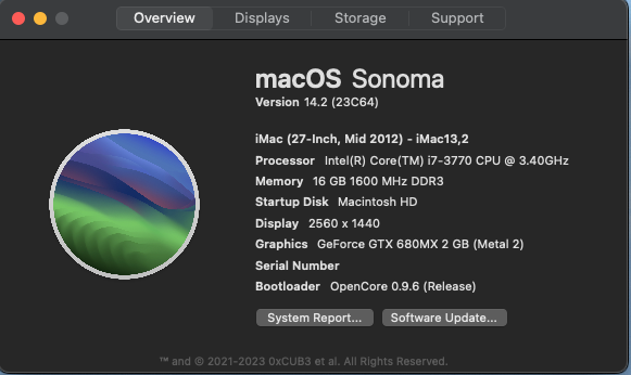

Updated iMac 13,2 from Sonoma 14.2 RC1 23C63 to RC2 23C64 via OTA update. OCLP 1.3.0 N commit f1210de.
Everything running well so far and no glitchy graphics issues this time.

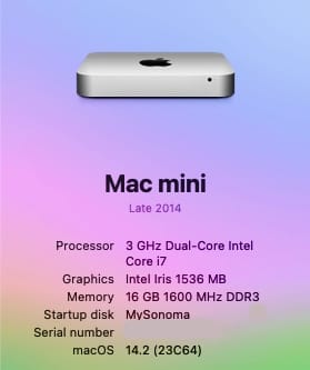

macOS 14.2RC2 (23C64) OTA OCLP v.1.3.0n installed without drama atop (23C63), runs as expected as have all the Sonoma iterations Fear not. :cool:

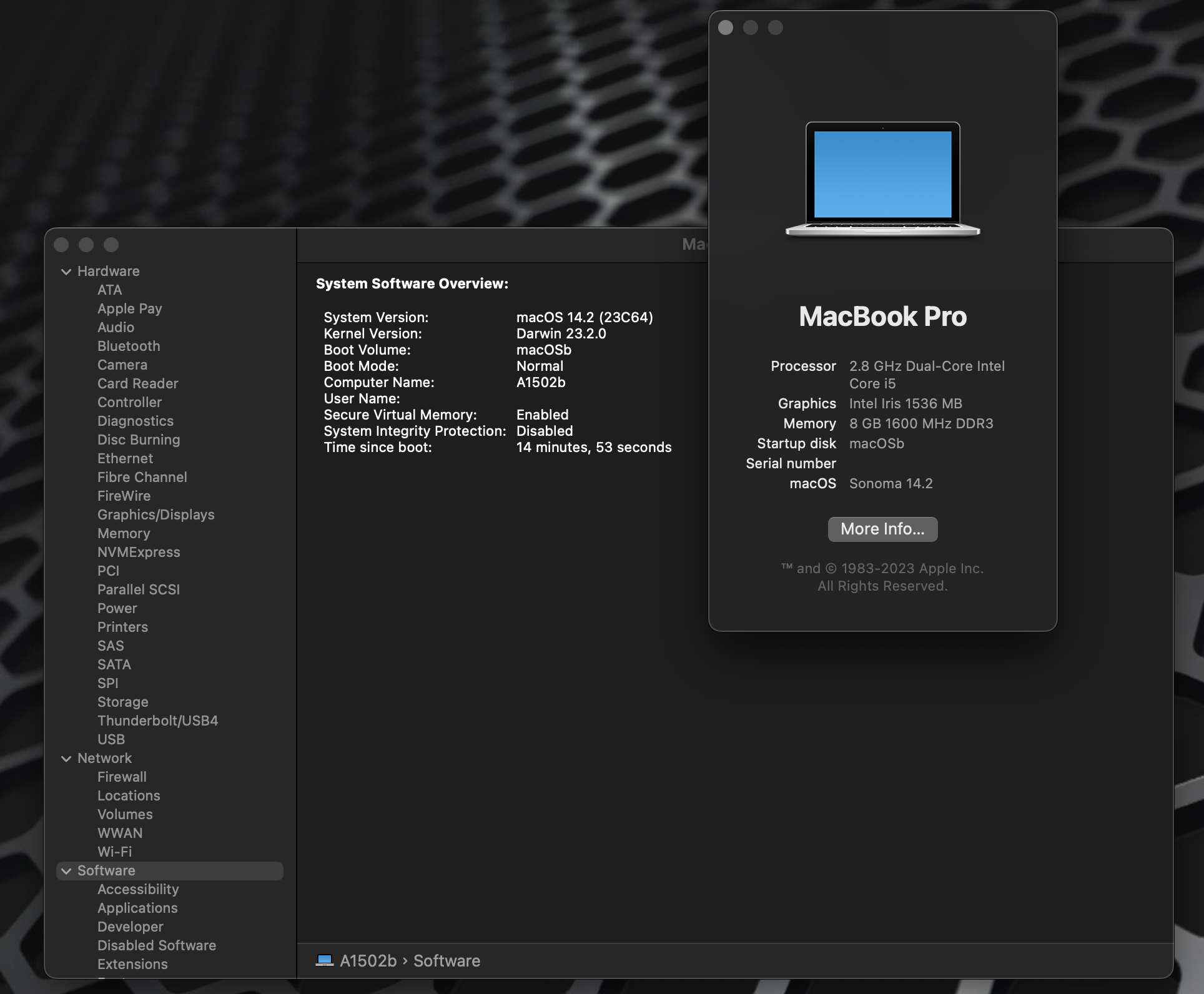

Updated my notoriously finicky MacBookPro14,3 (15" 2017 with TouchBar and T1 Chip) to from 14.1 to 14.1.2 OTA. Things went pretty smoothly. OCLP noticed I was doing the update, so it pre-downloaded a new KDK, but when it finally rebooted back to the OS, the Wifi was being weird again. I downloaded OCLP 1.3.0 Nightly and reinstalled OpenCore, rebooted and that seems to have fixed it (or maybe just another reboot was the key). So far so good!

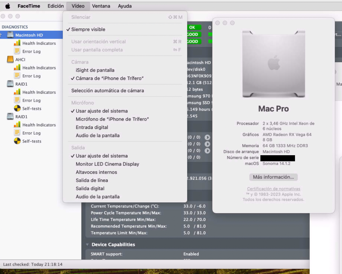

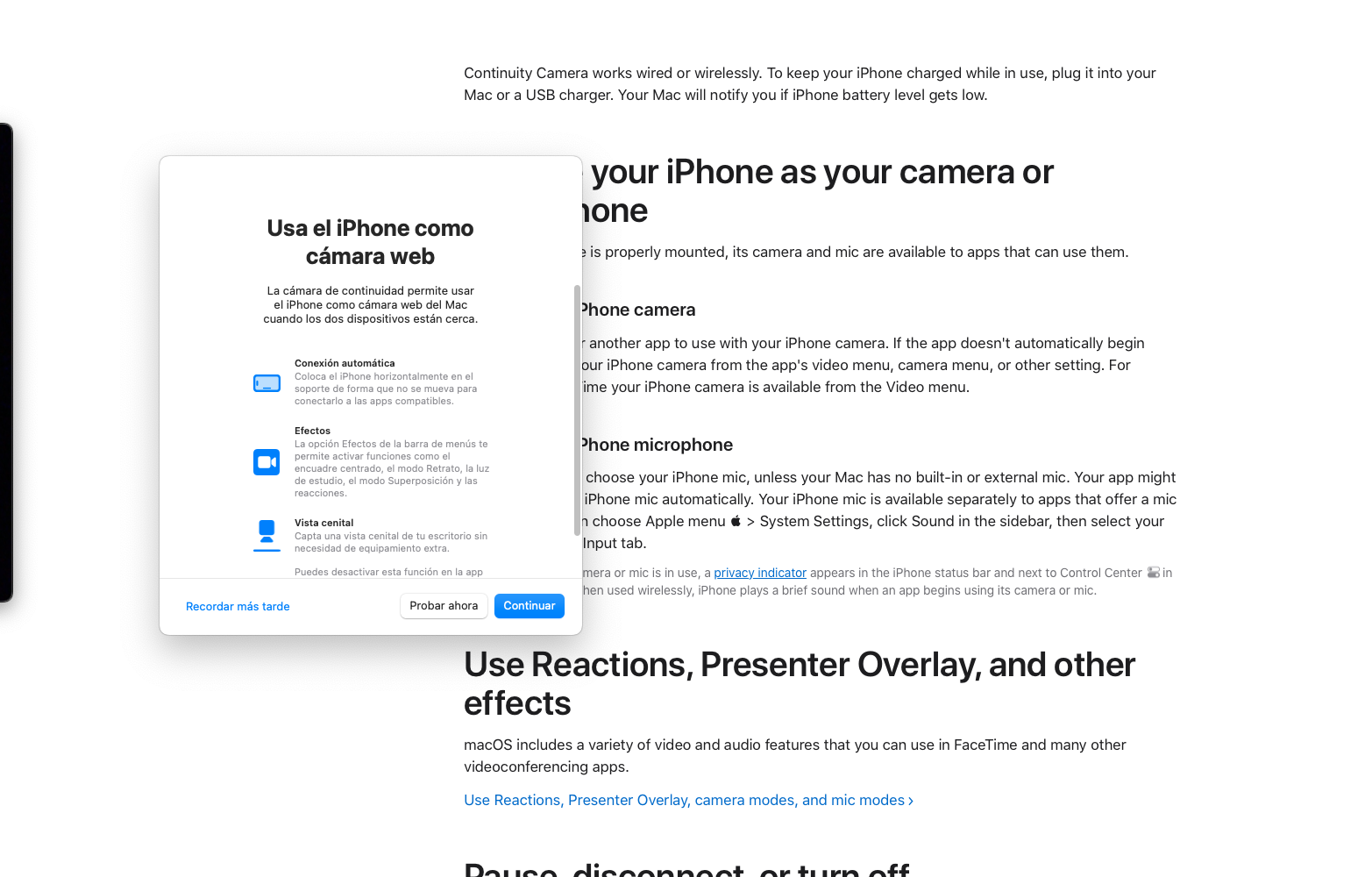

Do you have camera continuity on this machines ? Could you import photos from iPhone in Pages or Notes ?
Absolutely in my Mac Pro 5,1 about importing. Never tried the camera continuity. But I can try.
P.D. :Yes , as soon as I activated the option in the Iphone, a popup appears and you can use it as webcam. Pretty good quality, I must say.
