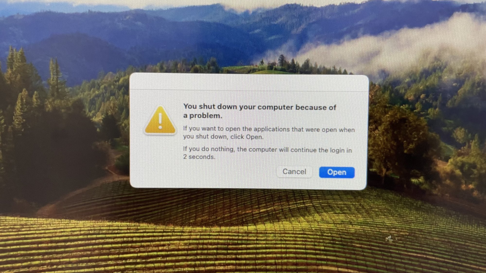

Upgraded to OCLP 1.4.2 and then macOS 14.4. Now I get this message after every boot up?
There is an easy fix for that.
To remove this message do this:
1. On Finder, goto /Library/Logs/DiagnosticReports
2. delete file shutdown_stall*
3. delete file wake*
4. or delete all files here for that matter.
Also here: /private/var/tmp/kernel_panics/staged.
It will clear the pop up message.
Good luck.
