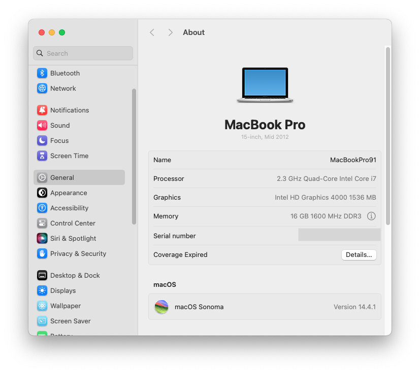

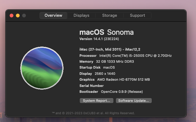

I used OCLP 1.5.0 (which I had installed before it was pulled), upgraded to 14.4.1 using the full package (not the minimal OTA). After booting up and applying OCLP post patches, things are holding good.
Wasn't pulled, 1.5.0n was renamed to 1.4.3n and the newest nightly is newer and supports more hardware than former 1.5.0n - may update for latest hardware support esp. older macs ;-) -> https://github.com/dortania/OpenCore-Legacy-Patcher/blob/main/CHANGELOG.md and OCLP's man pages and documentation always worth a look https://github.com/dortania/OpenCore-Legacy-Patcher/blob/main/SOURCE.md fantastic work.

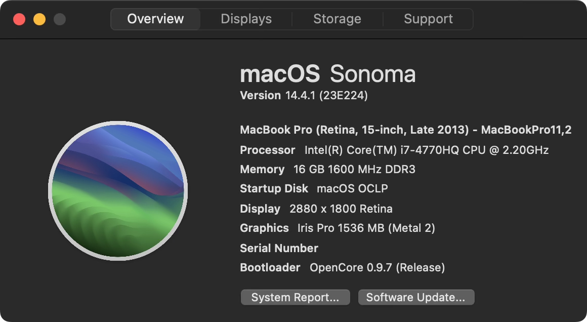

Hi,
My Mac (MBP 15'retina late 2013 with Kepler 11,3 , macOS 14.4, OCLP 1.4.2) had updated 14.4 -> 14.4.1 via OTA.
Then it made lost functionallity of searching and finding WiFi connection.
So I did reboot and post-root-patch in safe mode.
After that MBP reboot, it could get back WiFi and logged in normally.
