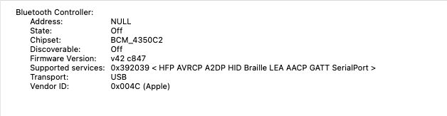

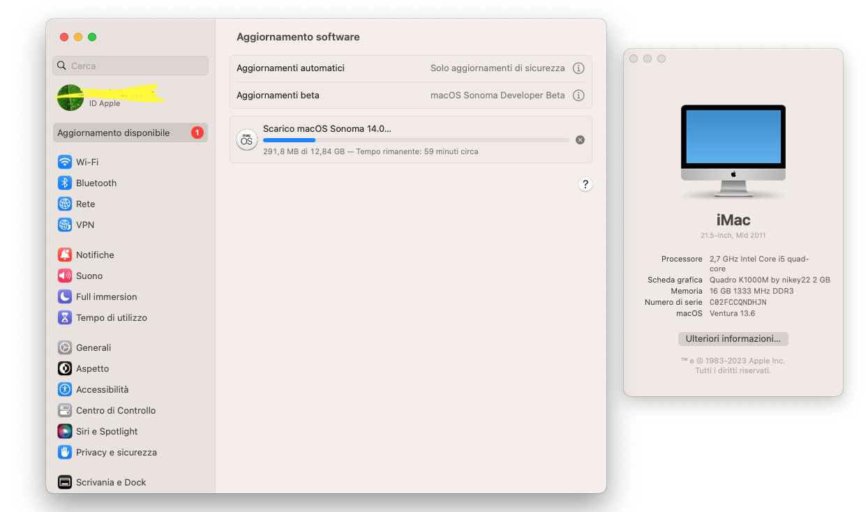

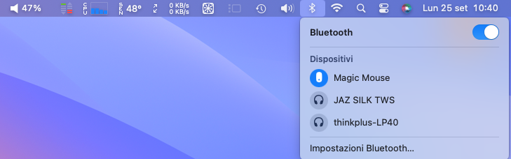

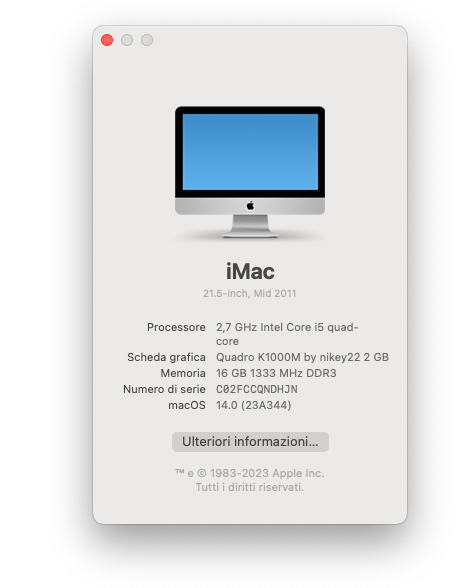

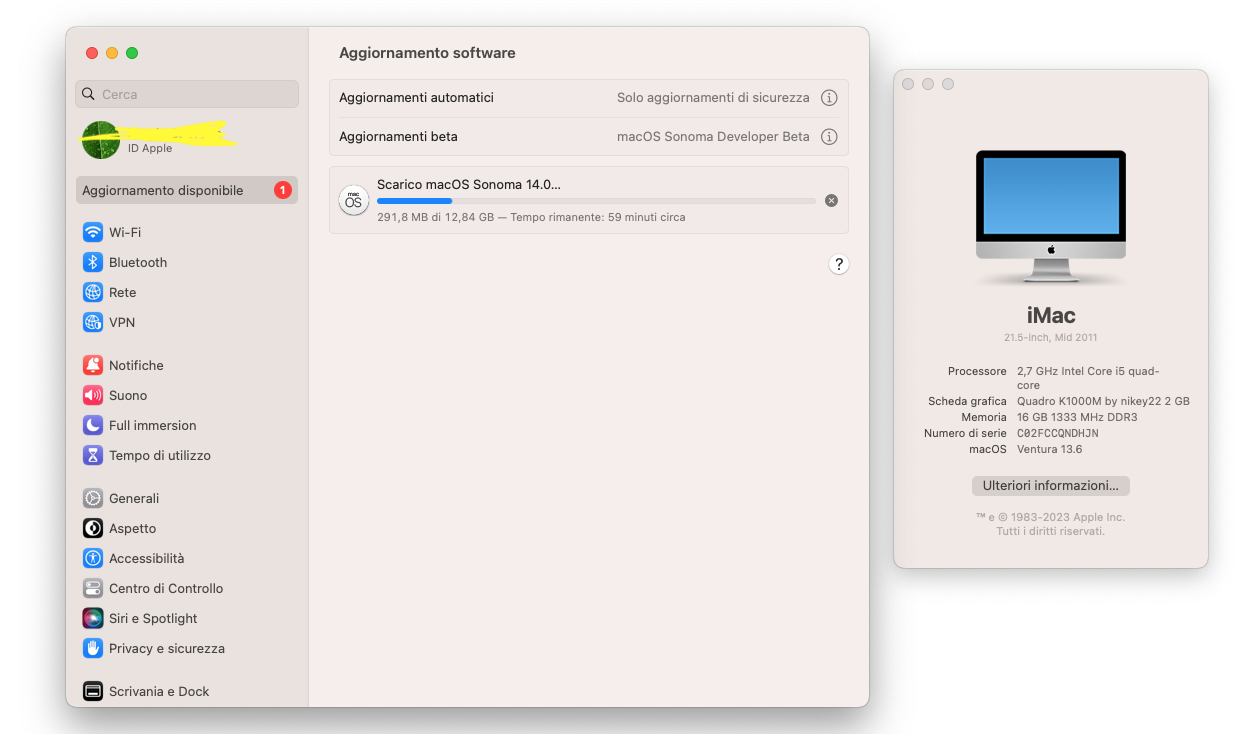

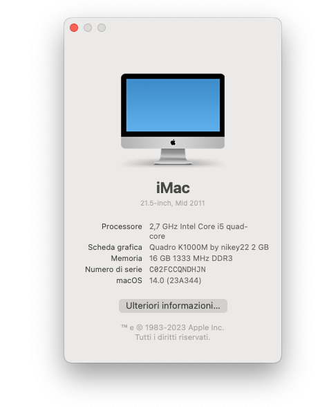

iMac 12.1 just OTA update from 13.6 to 14 RC2 (so final tomorrow), on main HD SSD, with latest OCLP 0.69 sonoma developer...
no problem, update successful without any crashes... once started on Sonoma I didn't encounter any problems, all the apps seem to work, from Photoshop to eyeTV and/or in any case my entire configuration...
only Bluetooth didn't work at the beginning, it didn't detect any device and the activation slide returned to the off position after activation... I reset the PRAM and now Bluetooth is detected and the previous devices I had paired have been loaded in Ventura

iMac 12.1 just OTA update from 13.6 to 14 RC2 (so tonight's final), on main HD SSD, with latest OCLP 0.69 sonoma developer...

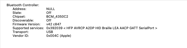

I tried to reset the PRAM as you did, but unlikely the bluetooth on my MBP8,2 is still broken...
I did. No way, maybe in next releases.
probably in the next release of OCLP... I was resigned to the failure to work... in a clean installation of Sonoma on an external USB SSD the Bluetooth doesn't work...
I also had problems when I installed Ventura last year, bluetooth worked partially (no scrolling on magic mouse), basically the hardware was not detected, then after a few weeks either with a new version of OCLP or after injecting an updated version of the kext bluetooth (I don't remember), it started working again

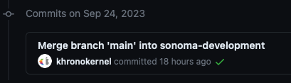

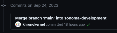

Hey all, I'm looking for the september 25th nightly of 0.6.9, apparently according to the root patcher, that's the latest version. However, when I download the nightly, the get info says it's the 24th, can someone point me to a link that will get me the Sept 25 binary ? thanks.
@MacinMan I wonder if we're running into time zone differences as witnessed earlier in this thread? The last commit to OCLP 0.6.9 Sonoma-development appears in GitHub as 9/24.
It's probably a better idea to look in GitHub to examine the commits than it is to rely on dates. At least with the commits, you can see whether a change is relevant to your Mac.
Yeah, I will, I got the download from github directly so I'll just use what I got as it works until they release the official.

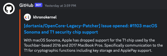

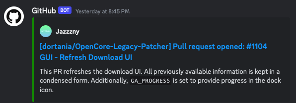

There is an OCLP discord channel that I find very helpful called "github". This channel is used by an OCLP GitHub bot to automatically record OCLP GitHub activity. If you want to see Dev activity on OCLP, this is a great place to look.
For example, the OCLP GitHub bot last recorded these:
You'll need to sort through the posts to find things relevant to your Mac and filter out activity that is specific to the OCLP UI vs. macOS patching.
