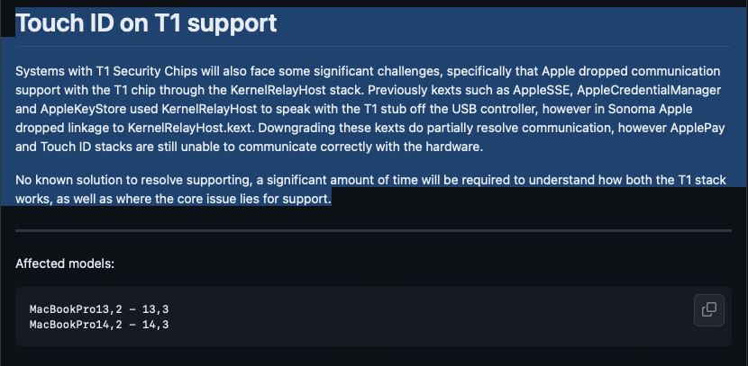

Hello Dev Team, I found a few bugs with mbp 14.3 with the latest oclp 0.6.9 nightly for sonoma. With a clean install, the touch bar and Touch ID do not work after installation. When updating from macOS 13.5.2 to Macos 14.0 RC2, the touch bar still works but Touch ID still doesn't work. Not that it's important or necessary, but it would be nice if the problem could be solved before the public version will be Released. Thank you in advance! A perfect job so far dev's....
Touch bar works normally on my MacBookPro14,3. It has worked since the first nightly version that I installed (before they filled the Radeon problems).
Maybe your problem is related to something else (hardware)?

Thank you for this update. Tried on my MBP14,3 as well and it’s working great (except for Touch ID, which I knew wouldn’t work…) thank you again OCLP team!
