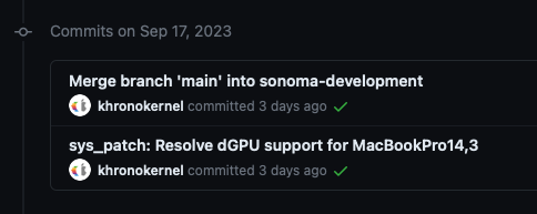

Any update on the Sonoma patch for the MBP14,x hardware please @dhinakg ?
Not sure if any of the Nightly builds support it, or if it is looking likely?
I have a MBP14,1 sat on my desk if any testing needs carrying out.
Pinging the Devs is a great way to incur their wrath (or to just be ignored). Did you mean this?

Best to know the link to the github repo and monitor yourself for desired changes and revisions.
Reactions: stiggyt and K two

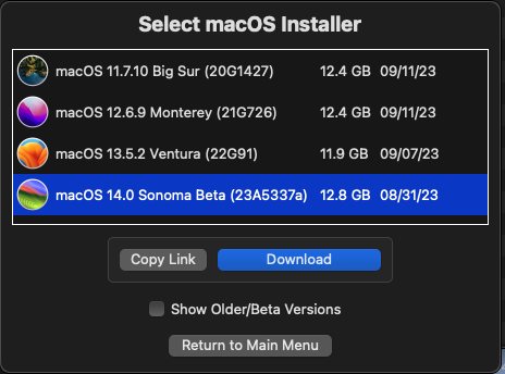

MrMacintosh has installer links through the last beta. It is the only way I could bring up and update Ventura & Sonoma. Incremental updates never worked for me on any version.
