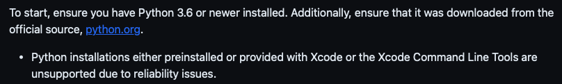

@deeveedee : the instructions on the site say to make sure it's Python from Python.org. I use Homebrew to manage Python, from what I gather they use the source from python.org, should I be ok? I have 3.11.5 instaled.
At the risk of incurring wrath, here are the OCLP 0.6.9 build steps that I use:
  • Download and install Python 3.11.5 from python.org. Do not use Homebrew.
  • In terminal, execute git clone https://github.com/dortania/OpenCore-Legacy-Patcher -b sonoma-development
  • In terminal, cd OpenCore-Legacy-Patcher
  • In terminal, pip3 install -r requirements.txt
  • In terminal, pip3 install pyinstaller
  • In terminal, python3 Build-Binary.command
The resulting OCLP binary is in OpenCore-Legacy-Patcher/dist
I think it's important to say that for anyone who finds these steps to be too complicated to follow, then you probably shouldn't be building your own OCLP.

@deeveedee Just a FYI, i got the python installer directly from python.org installed 3.11.5 followed instructions, got the same build errors that I got with the Python 3.11.5 installed by homebrew. I made sure that I was using the python from python.org and yes, that was what was in the path. So, not sure. Just thought I would share
Only thing I can think is that you need to completely remove/uninstall all traces of your old python and start clean. I haven't seen your issue reported, so its rare.
headlessmike
macrumors 65816
May 16, 2017
1,450
2,861
Or at least make sure to use the right version. I’ve built OCLP many times using Python from MacPorts without any issues. But just running “python” from the command line will usually default to the system Python unless one actively sets it up to find the new version.
