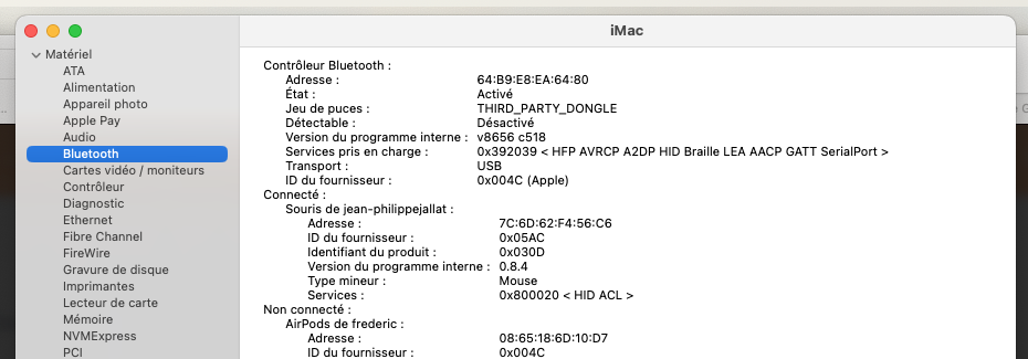

Many thanks, your idea works perfect now. The bluetooth device is now recognized as Apple device.See Post #2024 😉😊
Great solution!
That has been a very valuable hint.
Thanks again for the quick cross reference to #2024

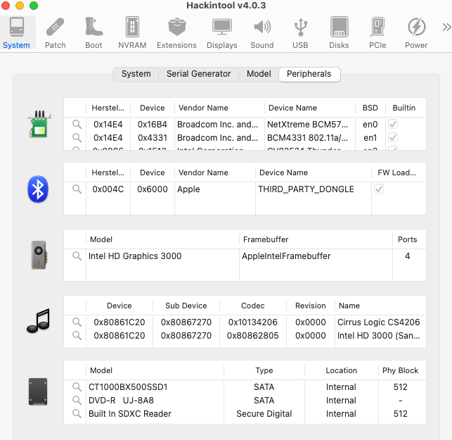

thank you very much, it worked on my imac 2009I had similar bluetooth problems when I upgraded to Sonoma from Ventura on both a 2011 and 2010 iMac.
This is what I did to get bluetooth back.
Download Ben Baker's Hackintool.app. Use the app to edit NVRam directly. Look for the entries:
bluetoothExternalDongleFailed
bluetoothActiveControllerInfo
bluetoothInternalControllerinfo
Delete all the entries, and wait for the NVRam to refresh itself. At least one of the entries (bluetoothExternalDongleFailed) should come back with value of <00>. If not, repeat deleting the entries.
For me bluetooth worked again when I performed the above steps, bluetooth settings will show all previously paired devices, and auto connect to them just as before the update.

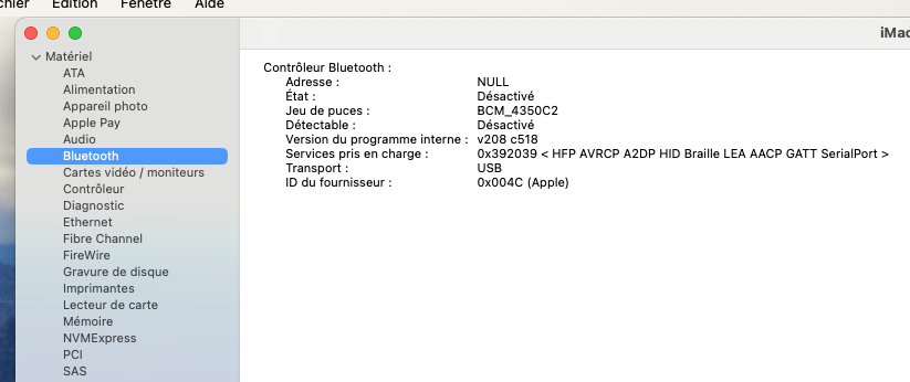

Can you please describe your exact Bluetooth problem on your 2009 Imac and did you use the exact steps in post 2024? Thanksthank you very much, it worked on my imac 2009

Hello, I am French I will try to explain this to you:Can you please describe your exact Bluetooth problem on your 2009 Imac and did you use the exact steps in post 2024? Thanks
