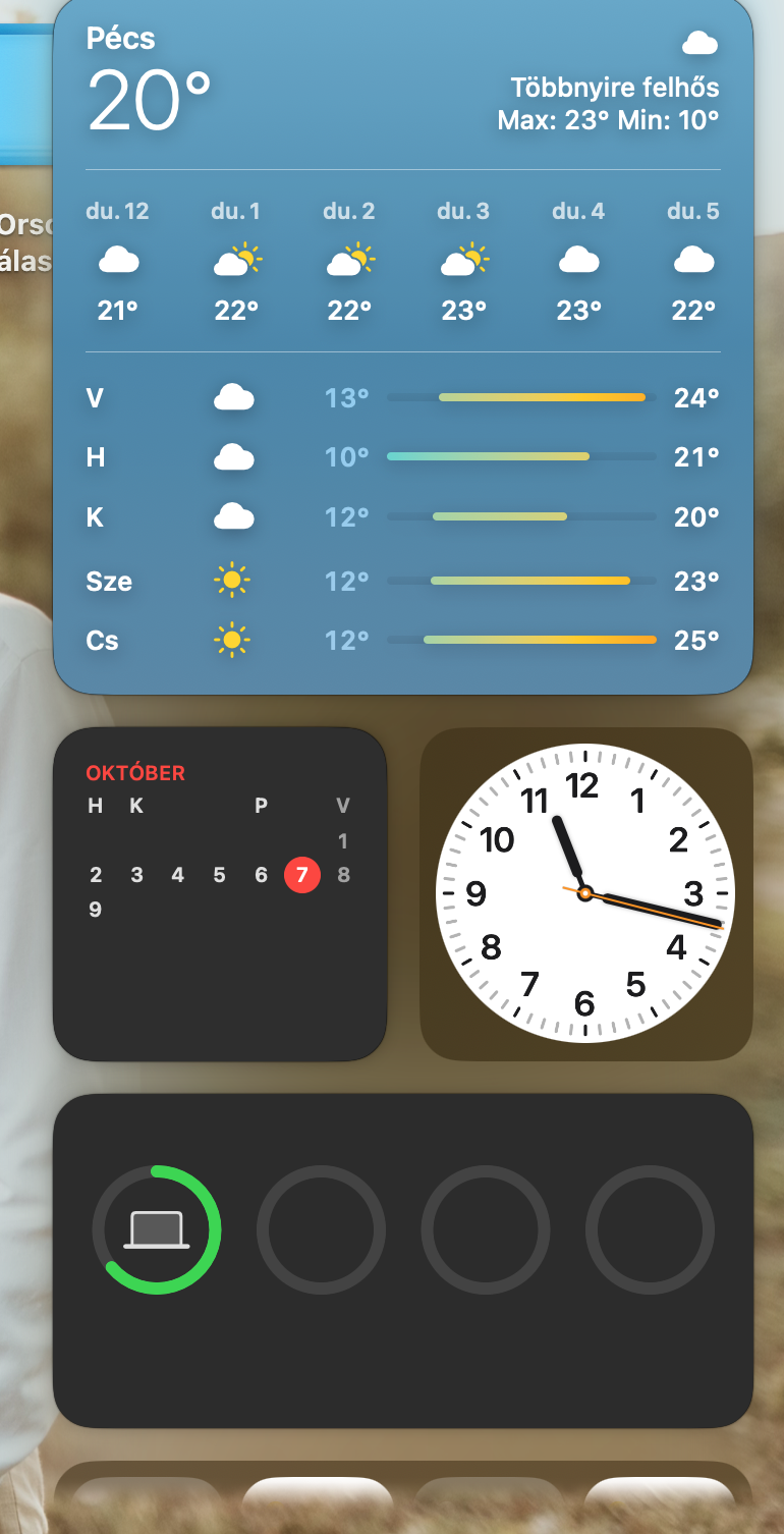

I am running MacOS Sonoma on my MacBook Pro 2015 13" and everything seems to be fine except for widgets. They seem to only draw out halfway. Is there a solution for this?
Also does anybody know how to turn off featureunlock? Whenever I choose disable it turns back on after every reboot. I alos tried building opencore again after choosing disabled but that didn't seem to help either.

HI everyone!

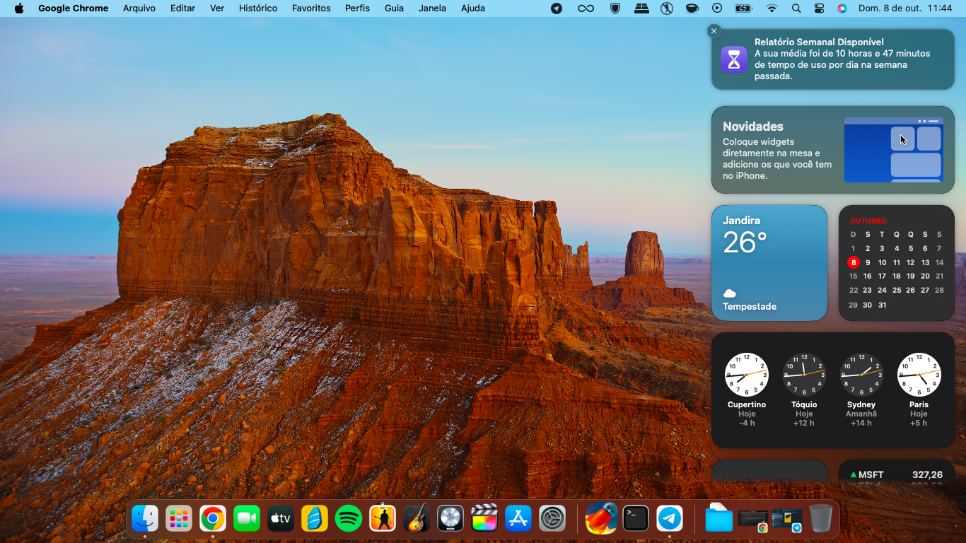

Fix OCLP 1.0.1 Build and Post-Install (Patches)

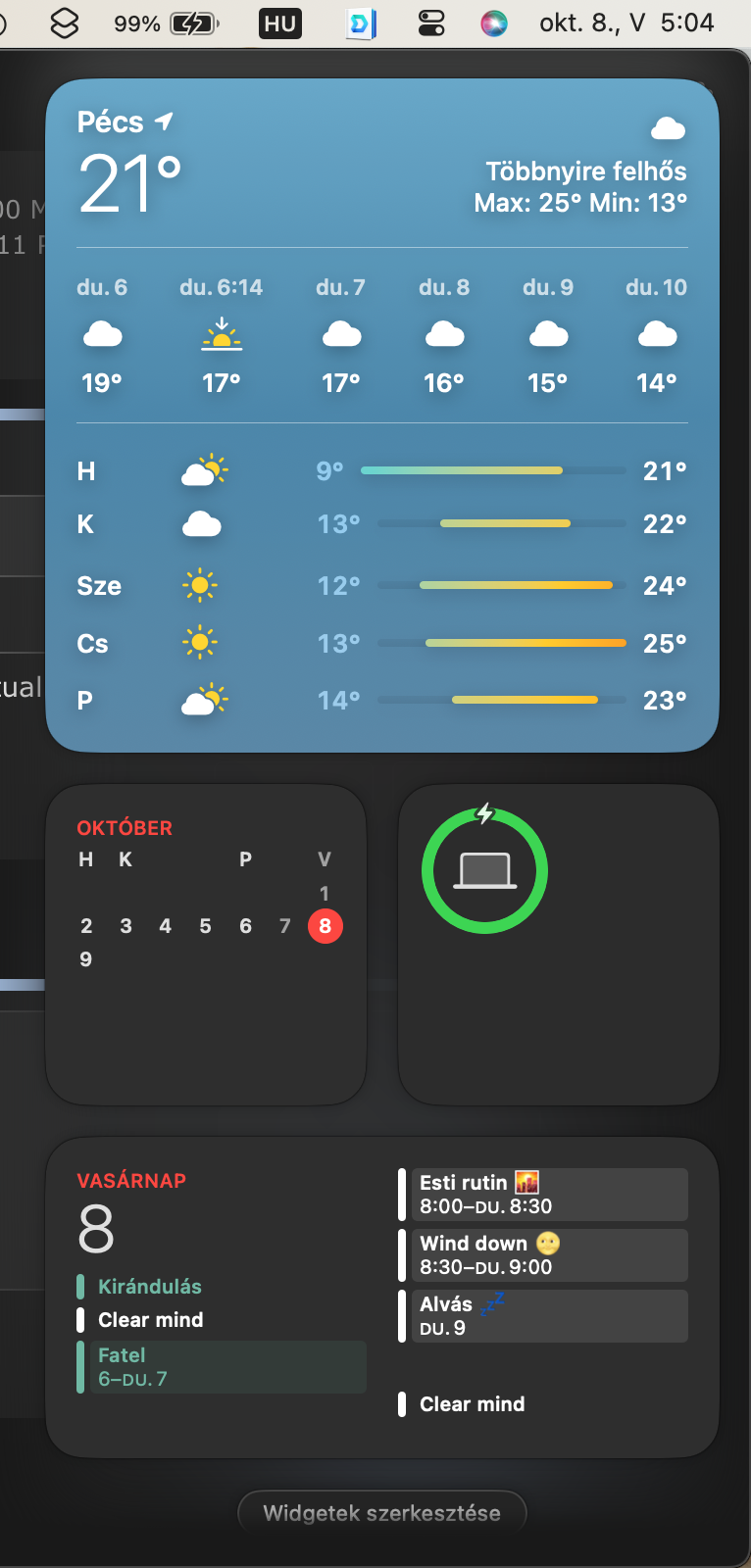

I am runnung 1.0.1 with the latest post install patches but it didn't solve it for me. I actually have this issue since Ventura came out but this one is a fresh install.
