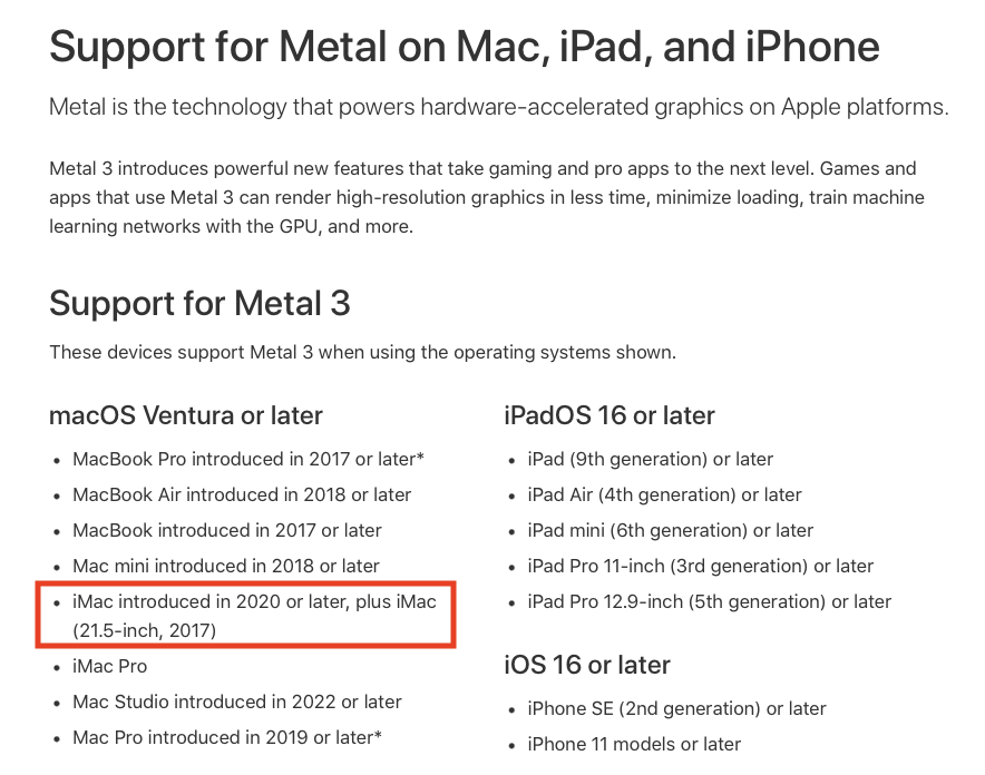

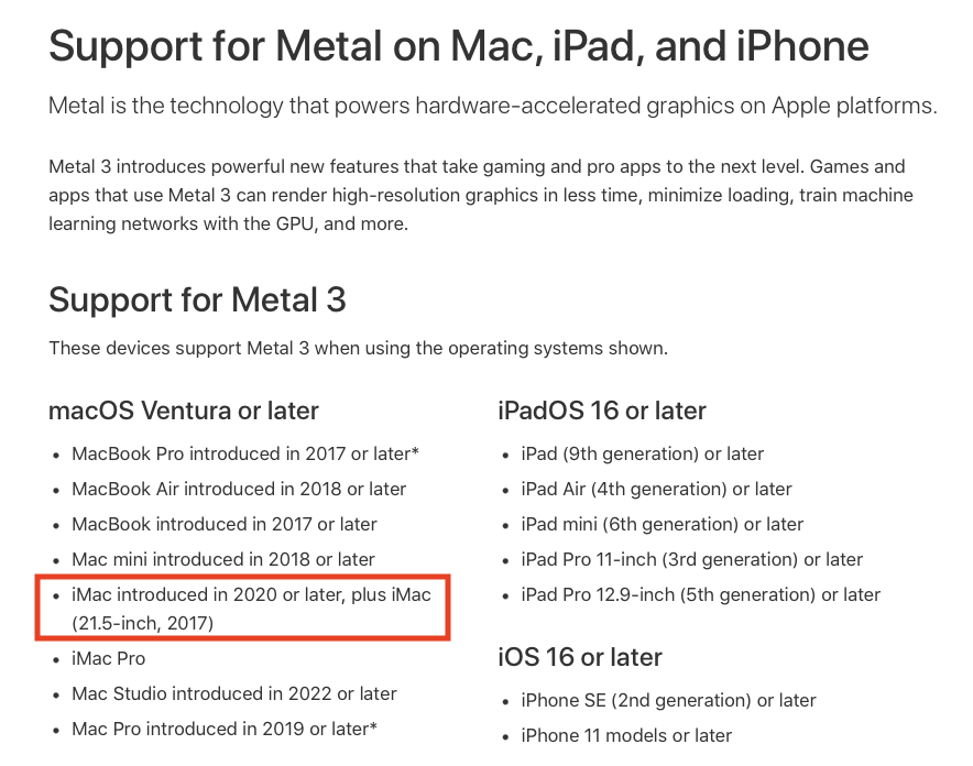

Another interesting change, the Radeon Pro 555 in Ventura runs in Metal 3 , but in Sonoma it runs in Metal 2... performance drop possible ?
Polaris/GCN4 was never Metal 3 - this is a bug in Ventura. So there is no feature or performance loss other than dropped support.
Edit: You can also check this list from the Apple developer pages.

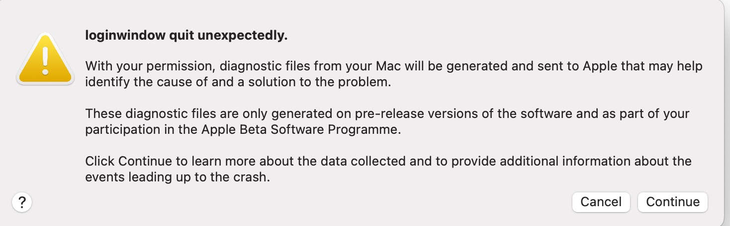

On my Lock Screen is active some crash is happened. My MacBook Pro 2014 with OCLL 1.0.1 capture the screen. After crashing. No complaint, I can stop the screen lock to prevent the crash

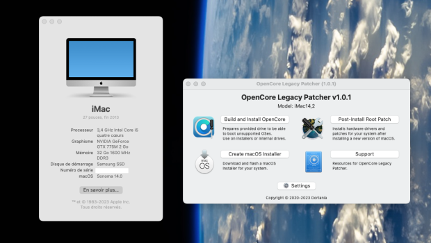

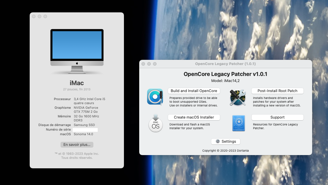

Easy OTA update from OCLP Ventura with OCLP 1.0.1 to Sonoma, on iMac 21 and 27 inch late 2013 both.
Root Patch applied after update, and it's a deal !👍🏻
Lot off Thanks to the OCLP Team 🙏🏻
