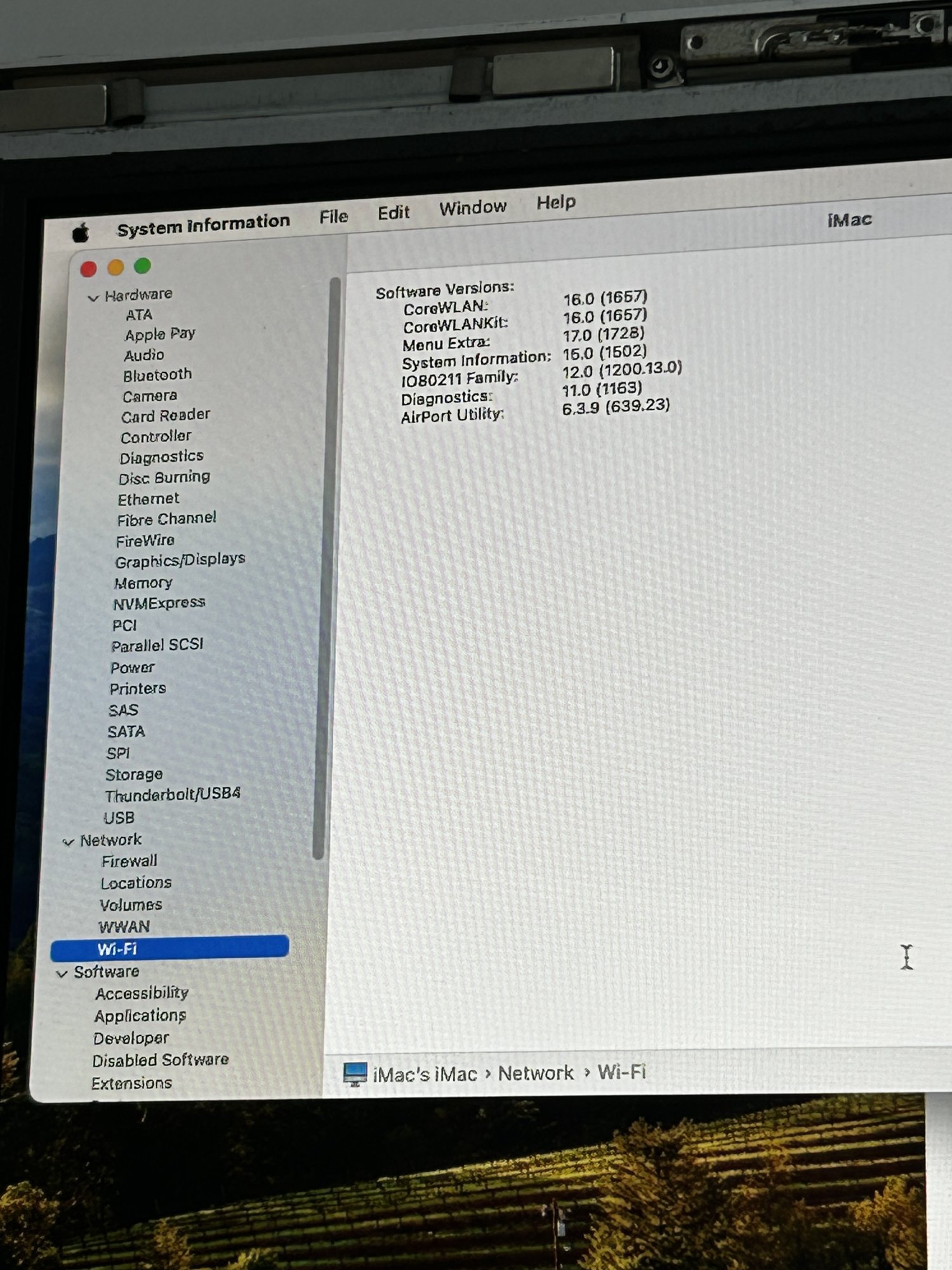

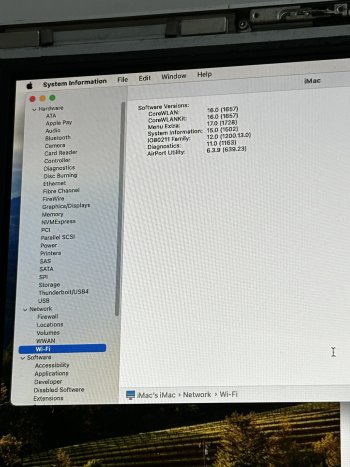

FYI, it runs fine before I changed GPU with radeon wx4150 and replace the logicboard. original logicboard and gpu is damaged. and now I only see Software Versions in System information (Wifi section). do you think it's hardware problem?
Usually an exclamation mark in the Wi-Fi icon points to issues with connecting to the existing Wi-Fi.
Do you have the same issue in trying to connect to your hotspot on your iPhone?
Did you ever check the system information/network/Wi-Fi?
Is the hardware recognised properly?
From what you’re saying, I’m assuming it’s an issue with the router you’ve got there. However you can’t exclude hardware compatibility issues after swapping so many internal components.

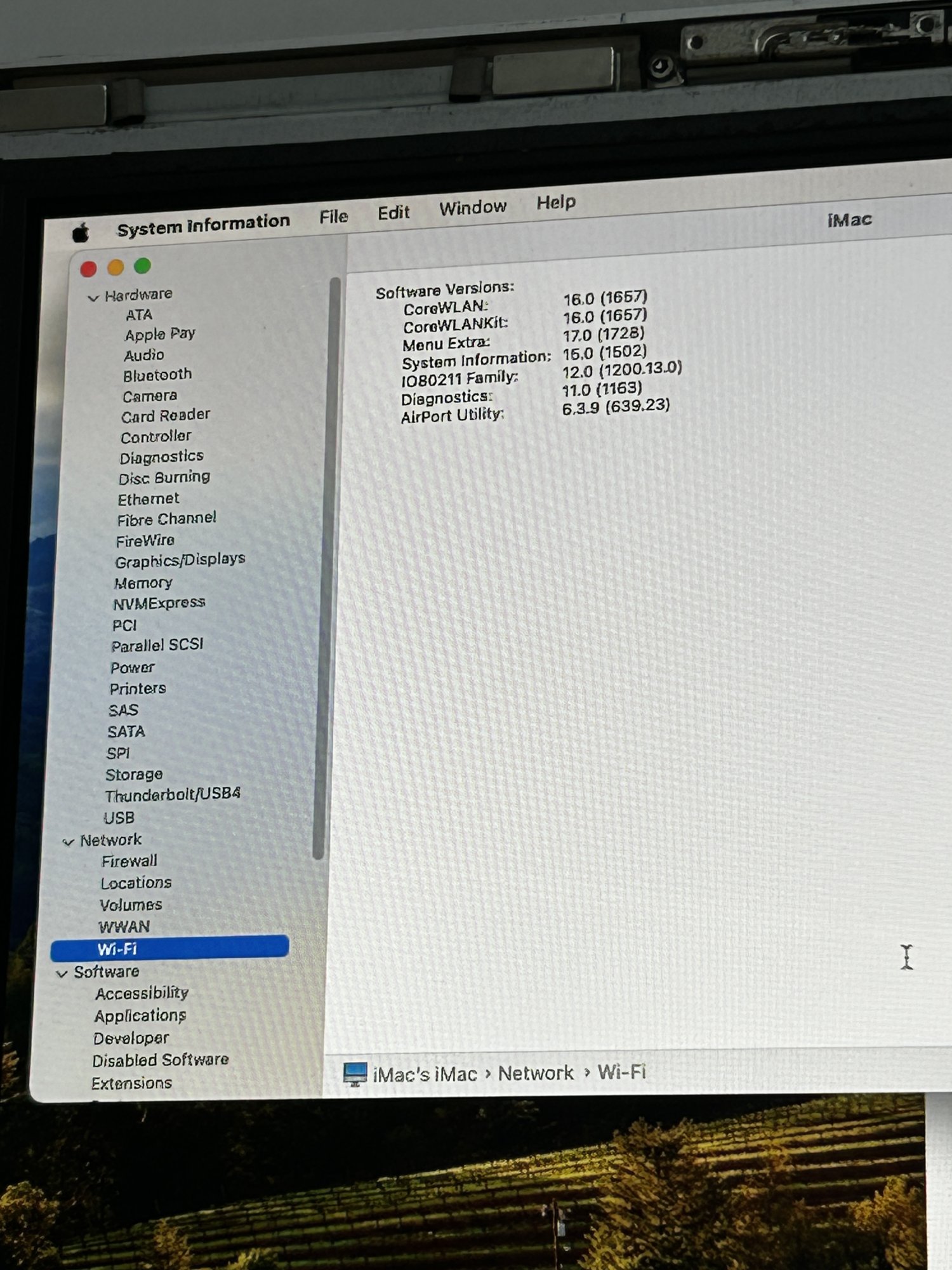

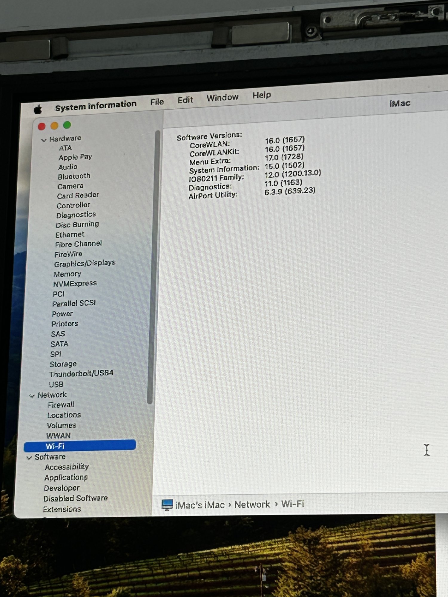

My wifi is ok. I think it's hardware issue. I don't know from the card or wifi slot or opencore. here's system information on wifi section. only Software version appears, no interface detected.
Just checking: The wifi card was swapped as well? Is it seated properly? How was the previous main logic board damaged? Same issue with a good known wifi card? Is compatibility given i.e. firmware up to date? Does the same card work in another iMac?
Just by looking at the questions, as some suggested here before an external wifi adapter seems to be the most economic solution to go for. If thats what you want.
I have 3 cards from another imac. I tried all of them and no luck. yes it seated properly with screw. previous logic board only fans running, 2 diagnostic led on. I can't fix it so I buy used board. I don't know about firmware, what firmware?

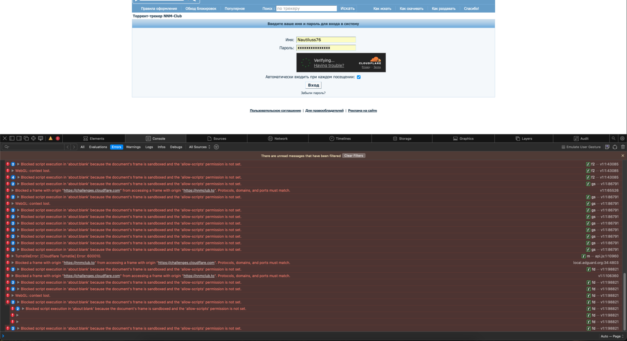

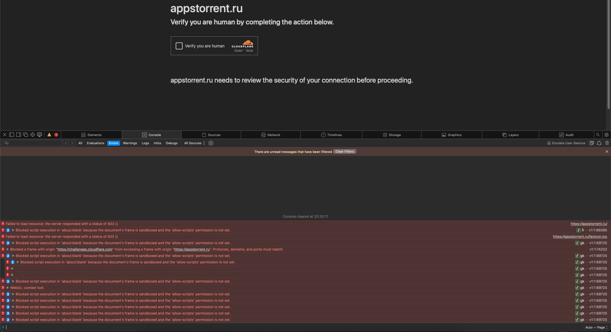

(MacMini 6.2 Sequoia 15.3.1) Since upgrading to Sequoia 15.2, I have encountered a problem: I cannot access any websites that have a Cloudflare verification (are you a human?). I either get an endlessly spinning circle or simply an error if I need to check a checkbox. The same issue occurs when using the Orion browser (also WebKit). I held out a faint hope that this was a temporary bug and would be fixed, but unfortunately, the problem persisted in all subsequent beta versions. Meanwhile, Google Chrome and Firefox work without any issues.
What I have tried: I reset the router to factory settings, experimented with different DNS settings, disabled/uninstalled AdGuard, turned off/deleted all the few Safari extensions, tested both wired and Wi-Fi connections, toggled the firewall on and off, disabled "Prevent Cross-Site Tracking" and "Hide IP Address from Trackers" in the browser settings, and turned off "Limit IP Address Tracking" in system preferences—nothing helped.
I installed Sequoia 15.3 cleanly from a USB drive. I only patched it (OCLP 2.2.0) and did not change anything else. Still, nothing changed; the issue remained.
I reverted to 15.1.1 and Safari once again passes all Cloudflare checks with ease, unaffected by any DNS settings, AdGuard, firewall, or extensions.
I like Safari, but constantly switching between two browsers is nonsensical. Has anyone else encountered something similar or have any suggestions?
Yes, the newer Safari has issues as you've found. I believe 15.1.1 is the last OS before the changes that broke webgl and cloudflare, as least for my machine (MBP 9,1). I don't have any newer natively supported Mac to check if it's broken elsewhere.
Reverting to Safari 18.1.1 (for now) may be an option. See the Ventura conversation starting here.
EDIT: It appears that reverting Safari in Sequoia is not an option. See here.
Thanks a lot for the links! I'm reading them now, and it's all falling into place. It's good to know I'm not the only one dealing with this issue.
