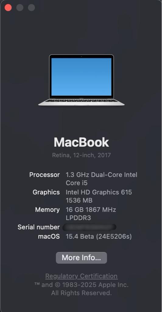

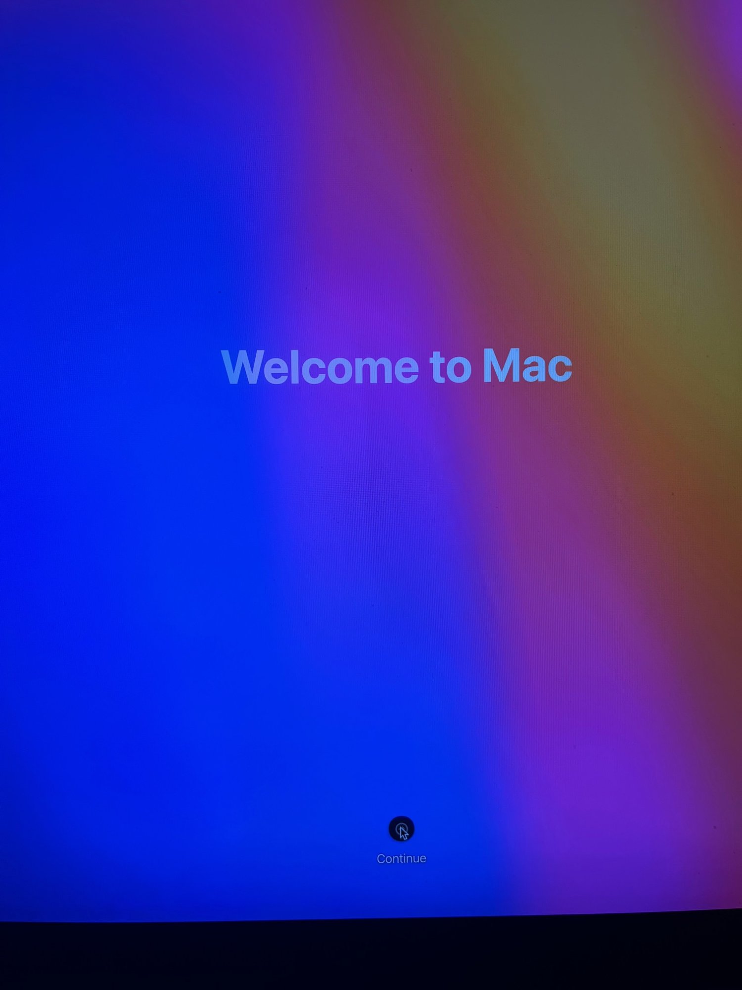

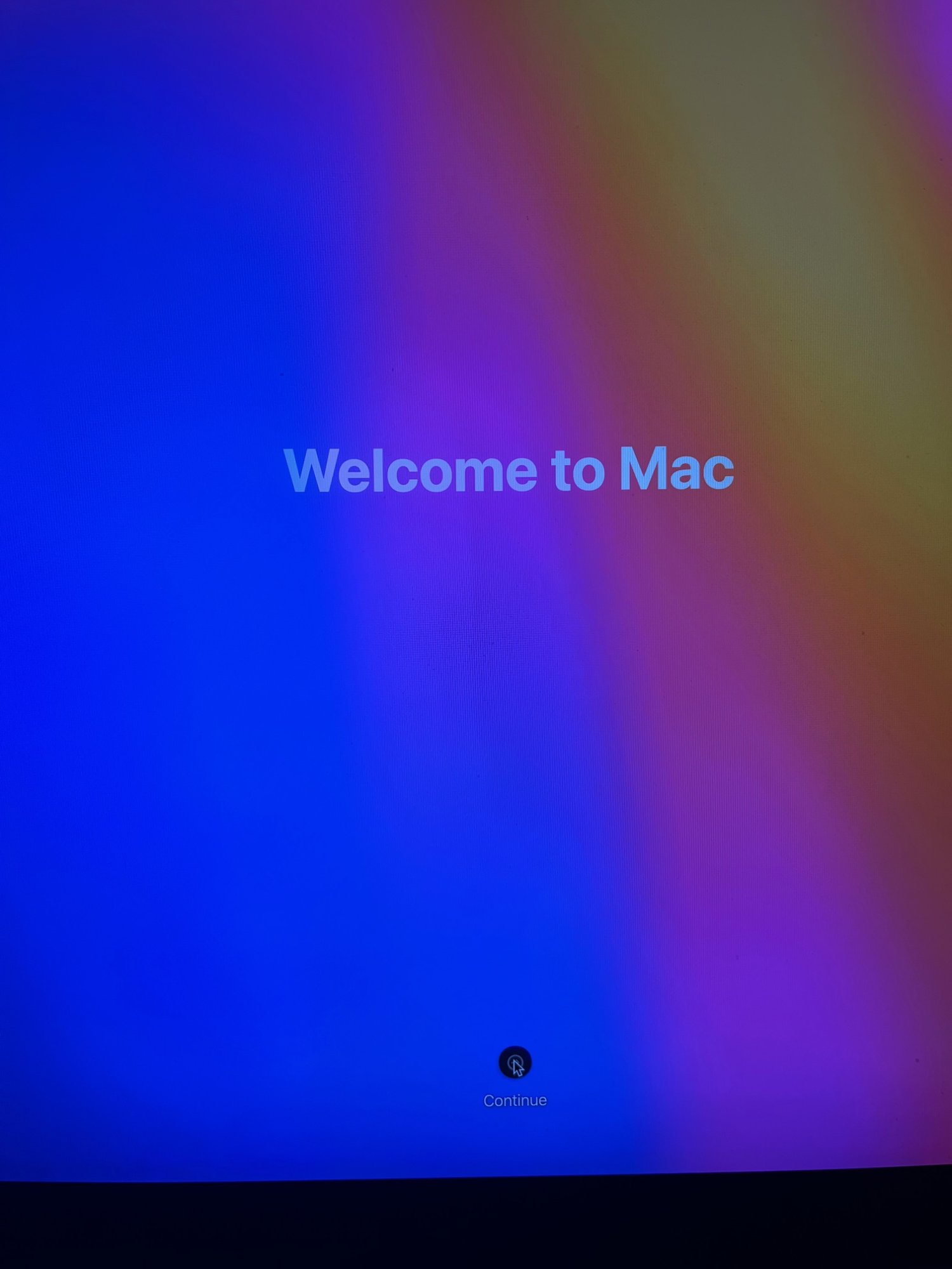

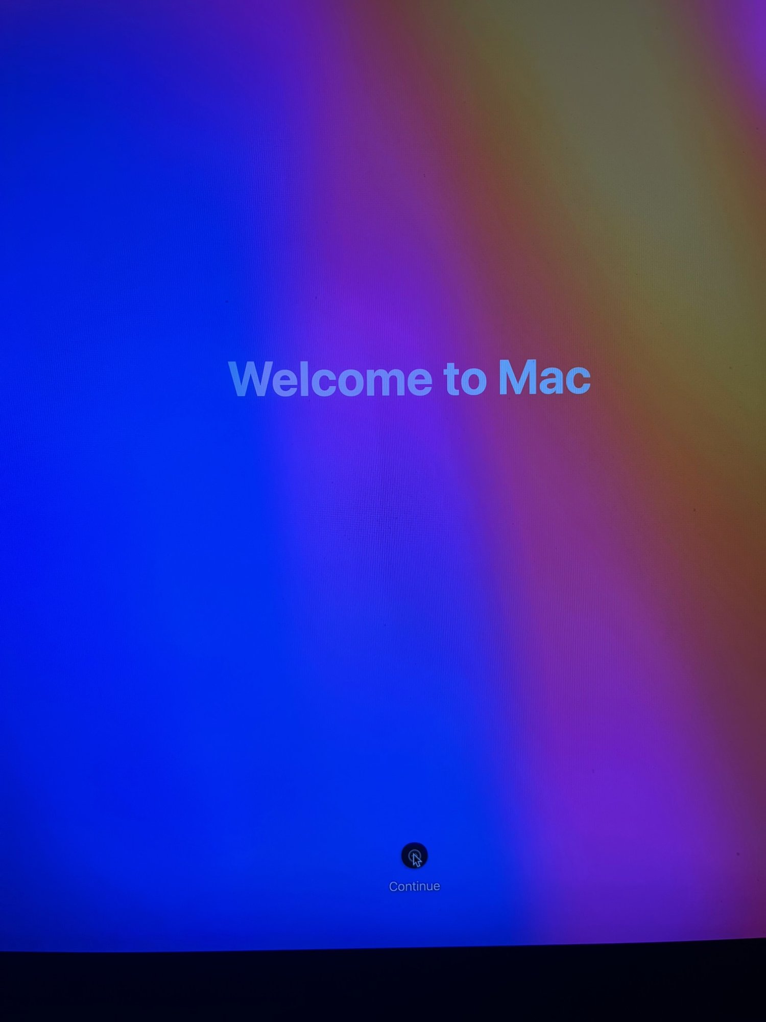

After the 15.4 debug kit appeared I downloaded the latest nightly, and updated to 15.4, OCLP as ususal downloaded the kit during the process, it seems to be doing just fine, a couple of new things I think, the welcome to Mac opening window and before that a message that updates will be downloaded automatically, which you can change in settings, that window is different also. Things seem to be much better in general.
Thanks Devs for a very rapid response.

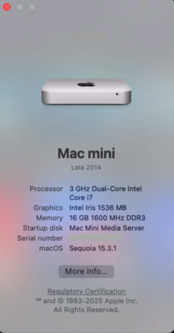

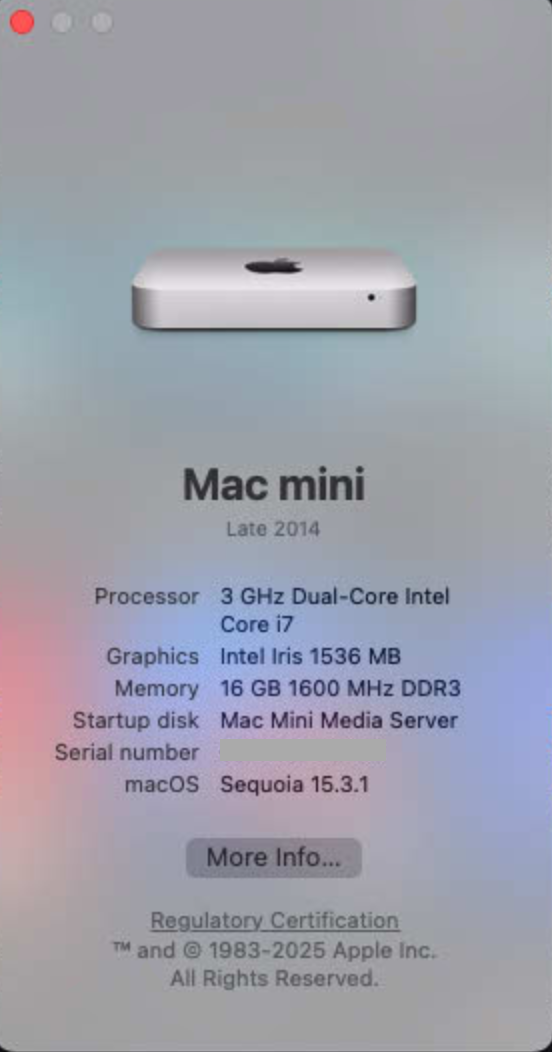

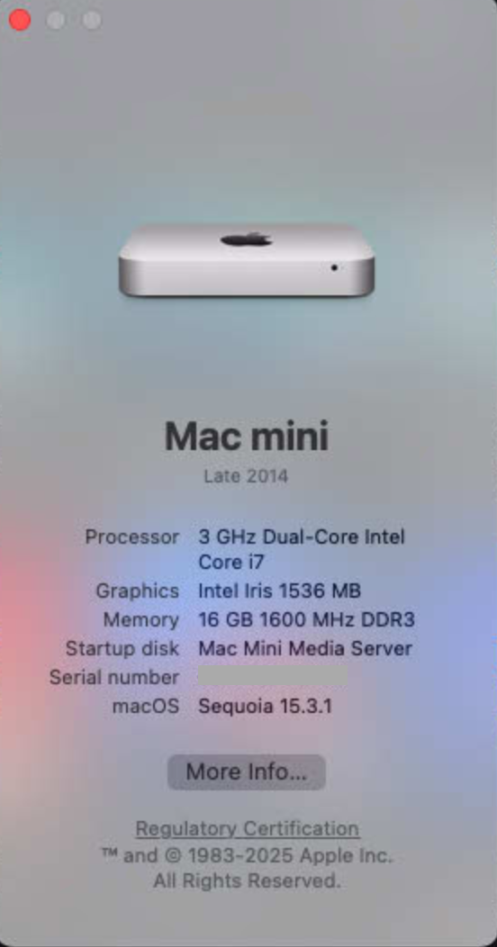

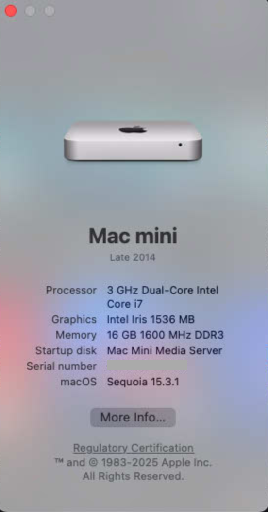

I commend your bravery testing Sequoia 15.4 Beta on an OCLP'd Mac. I was able to upgrade my last running OCLP Mac a 2014 Mac mini 7,1 to 15.3.1 but had to do a clean install (reformatting the drive) from an OCLP USB stick. Seems to run pretty well for a 10+ yr old mini. I am awed with amazement at what the developers have accomplished with OCLP. Cheers to them and all the helpful folks here on MR.
