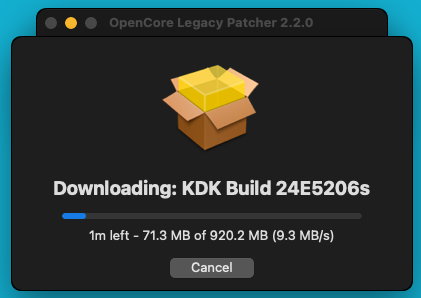

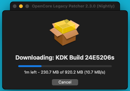

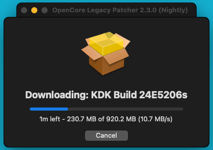

Haven’t seen anything listed in the nightly that effects 15.4 submitted also haven’t seen any success stories on discord either but could depend on how old the model is or maybe luck.

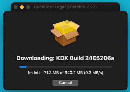

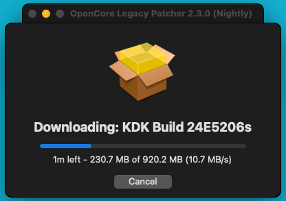

Did you see the link I posted on #2722, that appears with the nightly.
I think all he was saying (don't want to put words in any mouths) is that there were no post-2.2.0 commits to OCLP that would fix the 15.4 issue that some have reported. The most recent KDK is downloaded by both OCLP 2.2.0 and OCLP 2.3.0nightly.
Thank you for the clarification, I am not a software expert, I may have gotten lucky and thought it was progress. I do have 15.4 working well on internalHD and externalSSD. I may have misunderstood when I saw the message that a new KDK was just released. Sorry for the confusion.

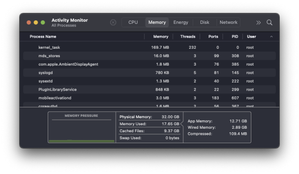

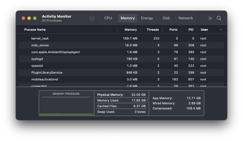

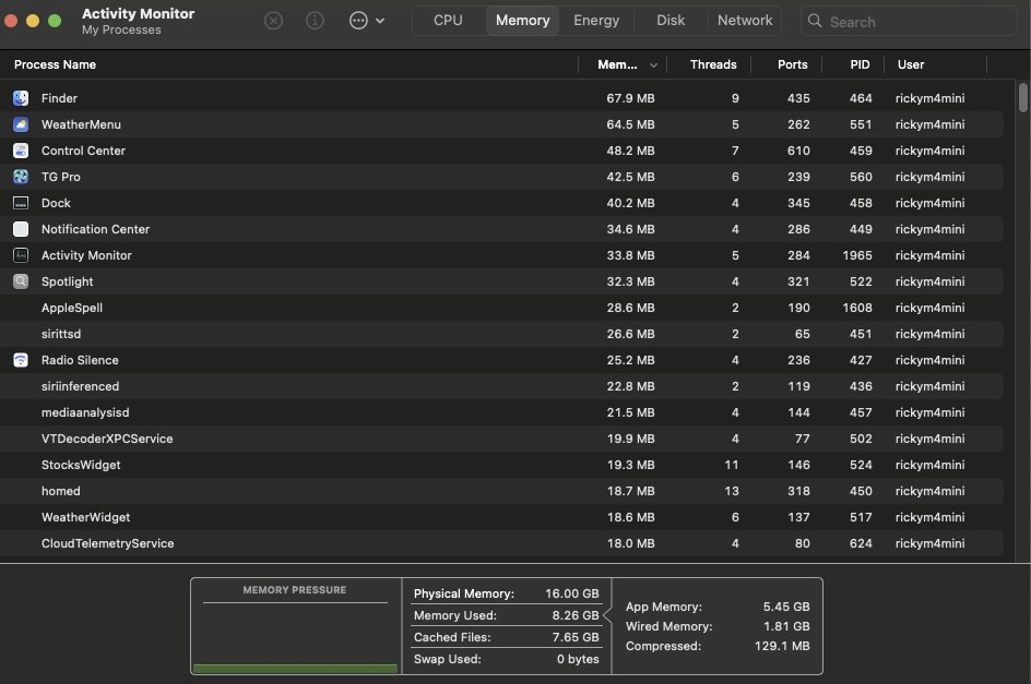

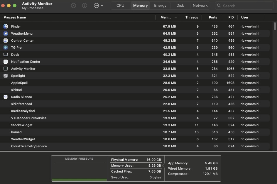

I'm not noticing high RAM utilization on this one, 32GB on board. Not booting from an external drive though, maybe could be the difference?

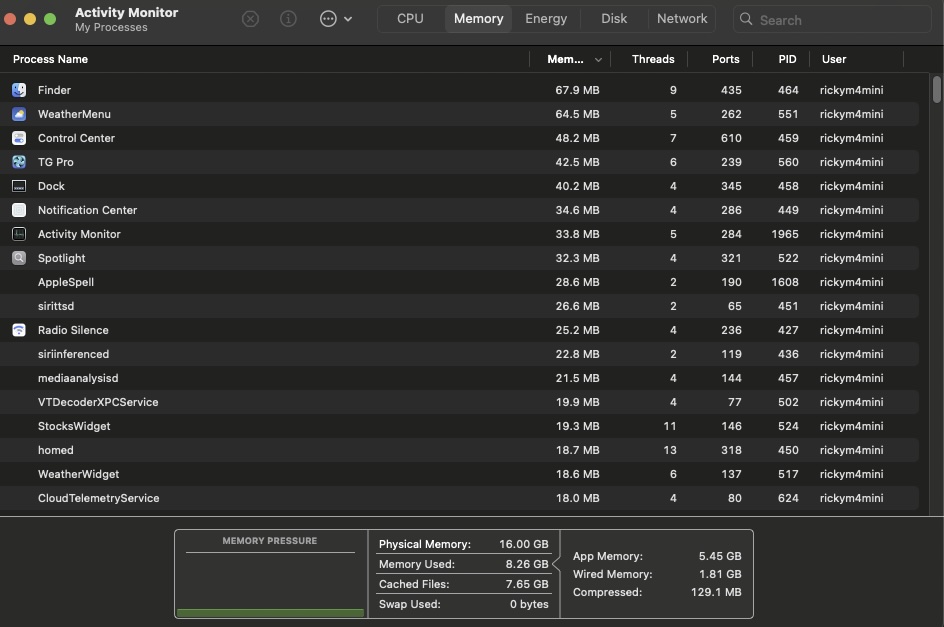

15.4 beta 1, booting internal 256gb , 16gb ram utilization mac mini 4 with 2TB external drive as active home folder.
