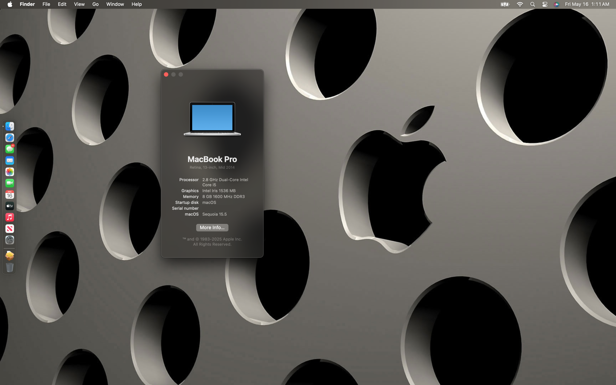

Used OCLP 2.4.0 to create the latest Sequoia install USB for my MBP 11,5.
Booted the USB, erased the existing internal 512GB SSD (using Disk Utility) and ran the install for a fresh copy of 15.5.
Went smoothly, with the usual steps working in sequence. Rebooted and so far, so good.

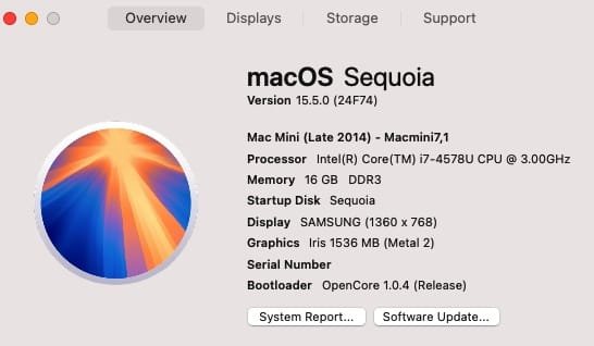

macOS 15.5 installed atop 15.5b2 OTA, OCLP v.2.4.0, runs as expected. Safari intact. 15.5.jpg:apple:👏
