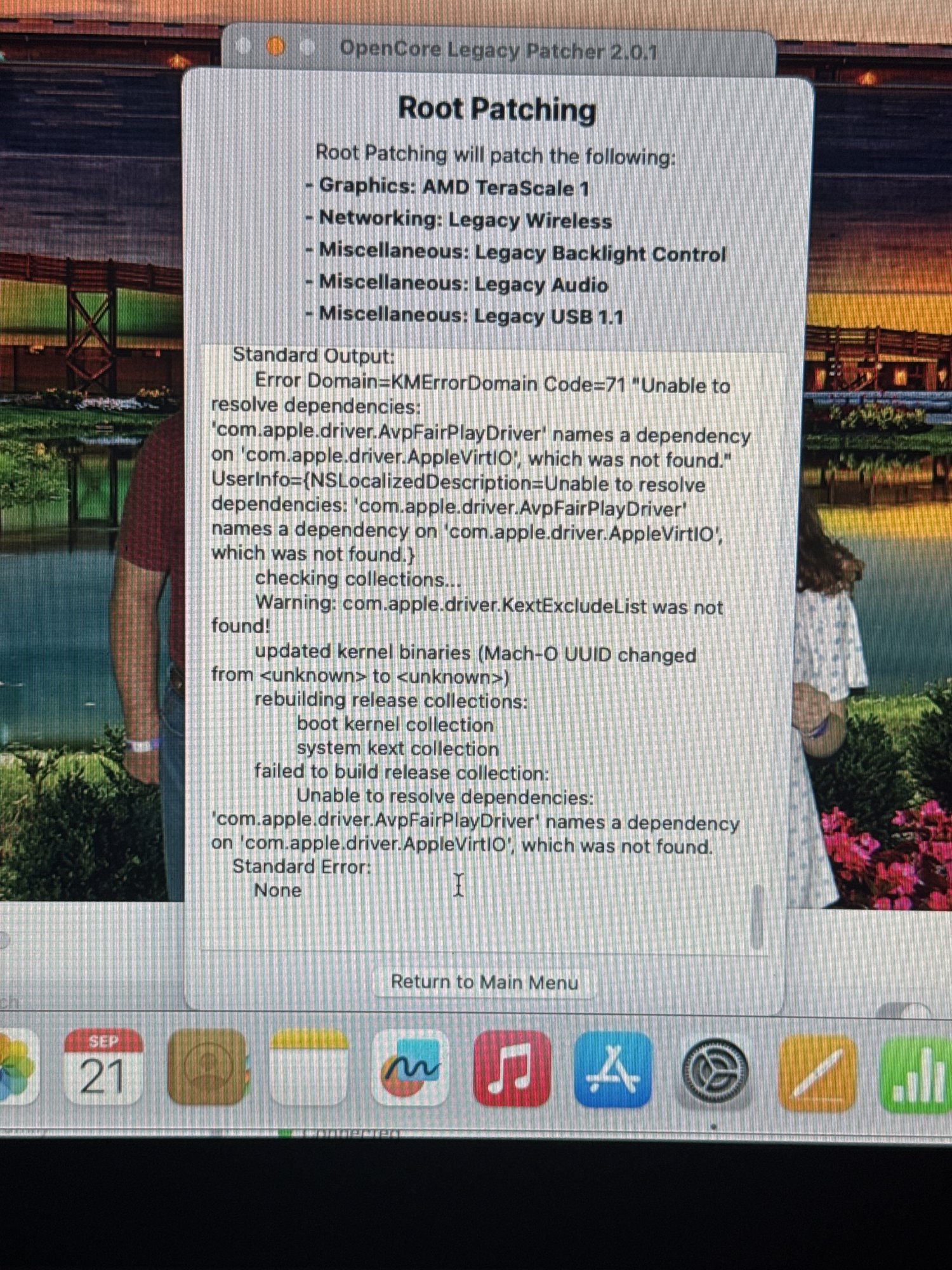

Update: I successfully installed Sequoia, but I can’t apply root patches.. I got error 71 (unable to resolve dependencies), I tryed every hint listed in the dortania troubleshooting but no one works. I really don’t know what to do.. any advice?

Did you try applying the patches from Safe Mode?
I having this problem patching a 8,1 imac gets to this spot and it wont patch
