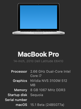

Flawless upgrade via OTA from Sequoia 15.1 Beta 6 -> Beta 7 on my HackBookPro6,2. Patching with OCLP 2.0.2. Well done, Devs!
EDIT: Sequoia 15.1 Beta 7 is incredibly responsive on this very old hack.
