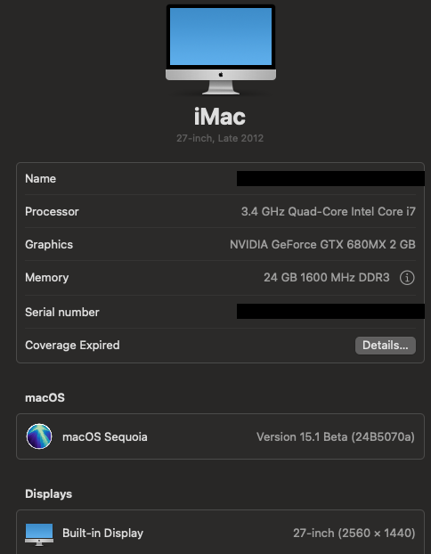

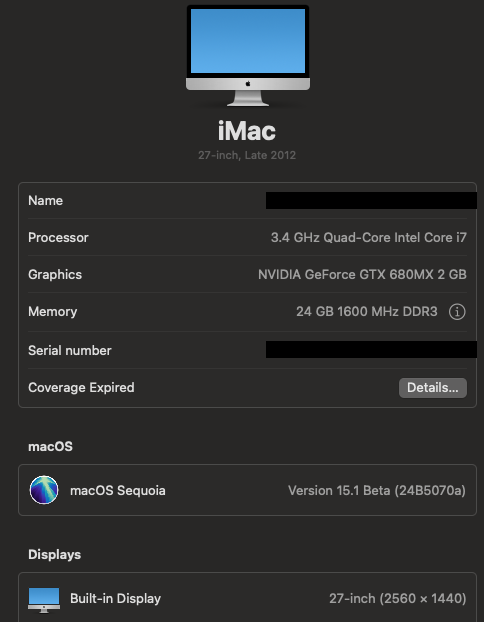

Hello to all,
Did not have chance to install 15.01 or 15.1 beta6 until now (vacation).

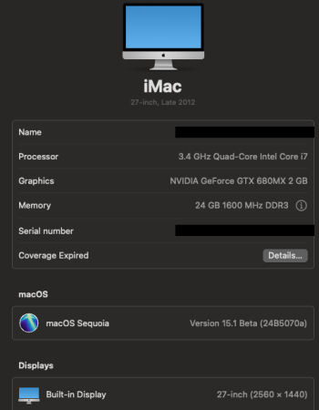

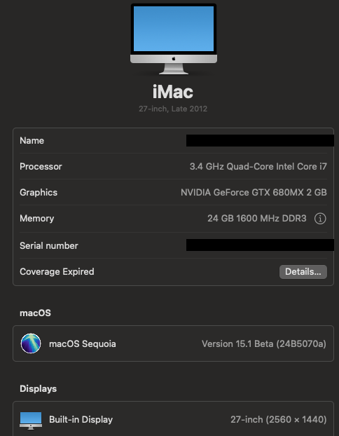

iMac 13,2 late 2012, 27” with original internal fusion 1T HDD and an external Evo SSD 1TB.
Used OCLP 2.1 nightly (10.5.24 version). I did enable “all feature-unlock” in OCLP settings, and made sure to select appropriate Mac model (13,2) in Host Machine settings. Default heading read “Host Machine”, but when changed to actual machine code (iMac 13,2) the choices in other OCLP selections were different.
Installed OCLP onto the disk before initiating OS update.
There was difficulty in initiating updates OTA; it required multiple attempts to finally succeed (seems “update function” kept crashing [a supposition]). Eventually OTA update to 15.1 Beta 6 (fover resident 15.0) did complete.
A possible other solution to OTA update problems is to boot into Safe Mode and then initiate update(?)
After multiple automatic restarts, machine booted into functional desktop. Applied OCLP 2.1 patches and graphics were fully accelerated. Continuity functions, including iPhone-as-webcam and mirroring, were fully available. No problems with handoff or iMessage functionality.

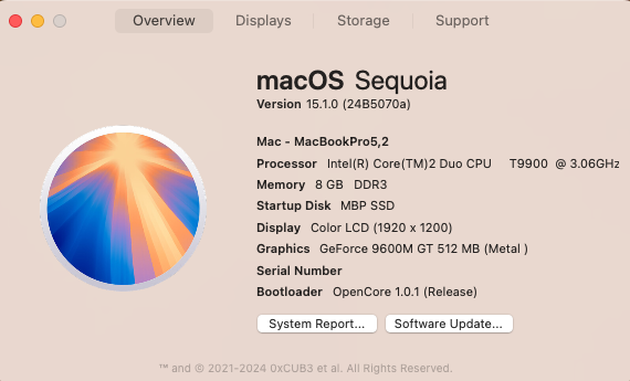

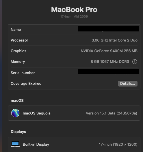

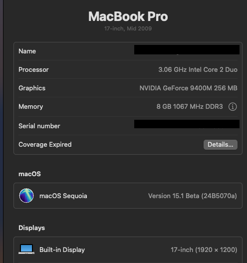

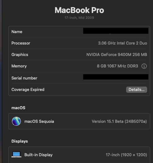

MacBook Pro 5,2 2009 17” with SSD (Evo). (Non-metal). [used mostly for experimental “endeavors”]
Updated to 15.1 beta 6 OTA. Used OCLP 2.1 nightly to install open core, before updating the OS.
Again, changed the heading in the OCLP (via “settings” section) to MacBook Pro 5,2, since default heading was “Host Machine”. When changed to MacBook Pro 5,2 heading, choices available for modification were different than under Host Machine” heading. I further did select full feature-unlock option and Firewire booting. Installation proceeded as described above for iMac. Once the post-install patches were applied there was graphics acceleration. Hand-off, screen mirroring and iMessage were fully functional.
It took some time for machine to become fully responsive after system installation; stem activity showed a great deal of “clean-up” activity along with XprotectRemediator scans.
Once above was completed system became very responsive and fully usable.
Great work by developer teams.

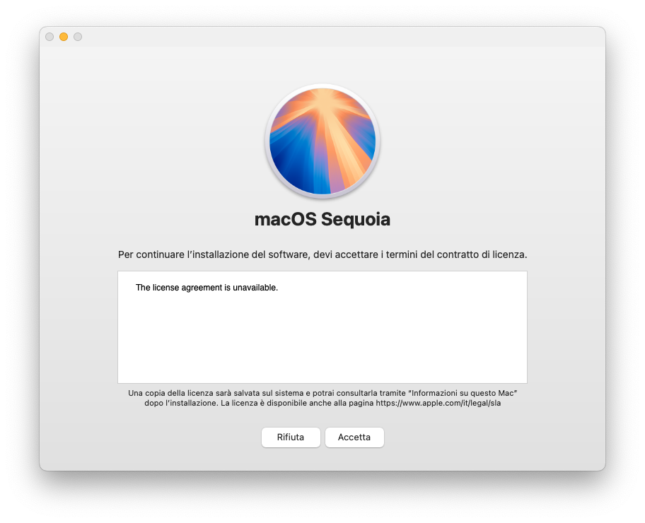

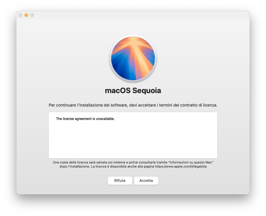

On my MBP11,3, license agreements are not displayed, whether from full installers or software updates; while on my MBP11,1 (without discrete graphics), they are displayed: anyone else has this problem…? Here’s a screenshot of the full macOS 15.0.1 installer: as can be seen, no license agreement is displayed. Maybe something to do with the Nvidia Kepler card (even if the same happens also forcing Intel Haswell)…?
It works well installing by USB Key and not by macOS 😉
