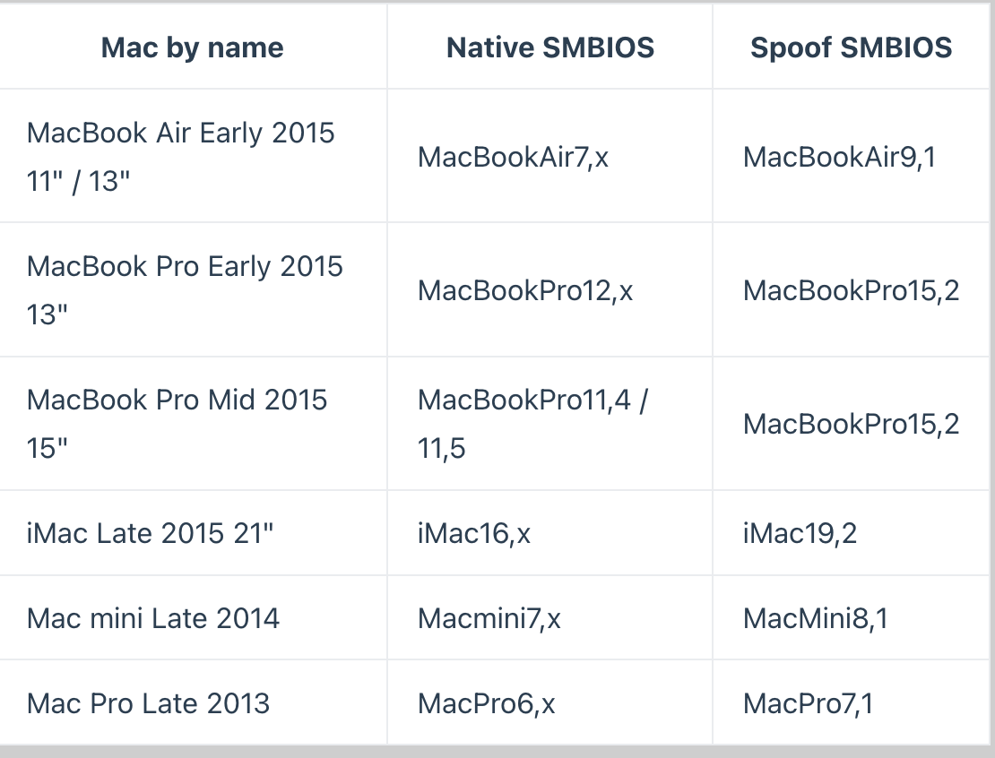

Is there an issue with OCLP and spoofing?

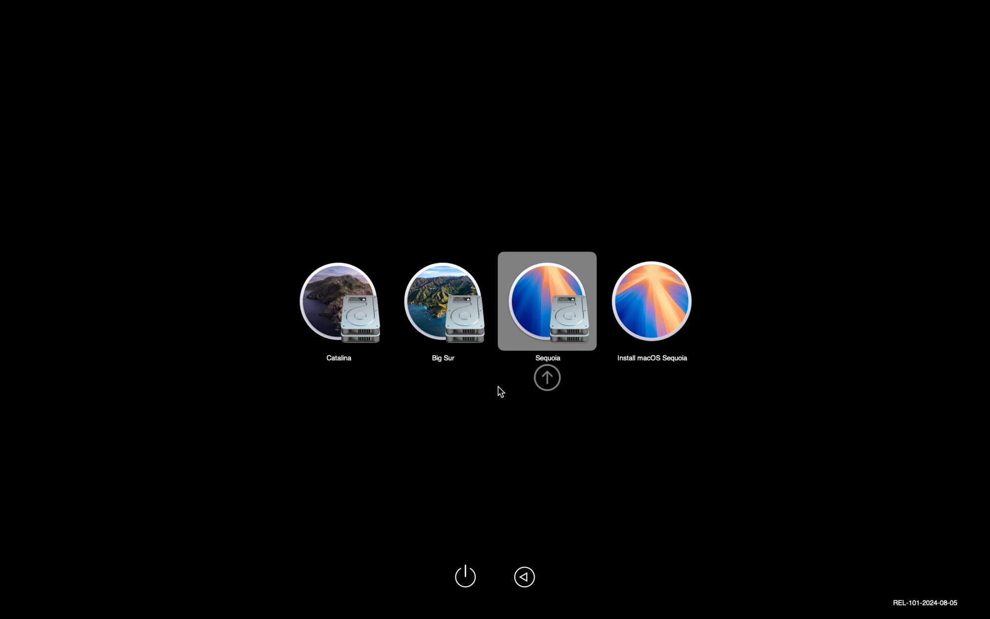

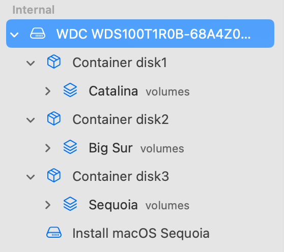

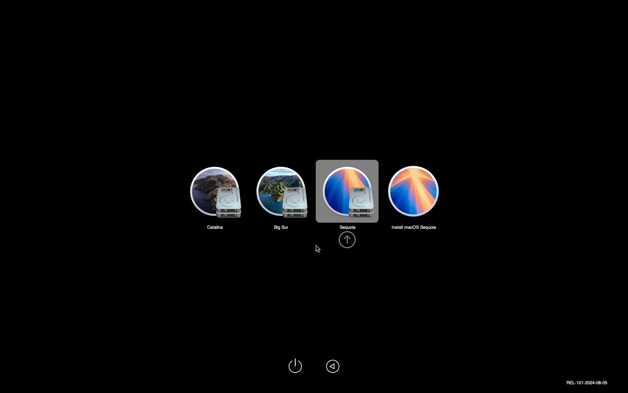

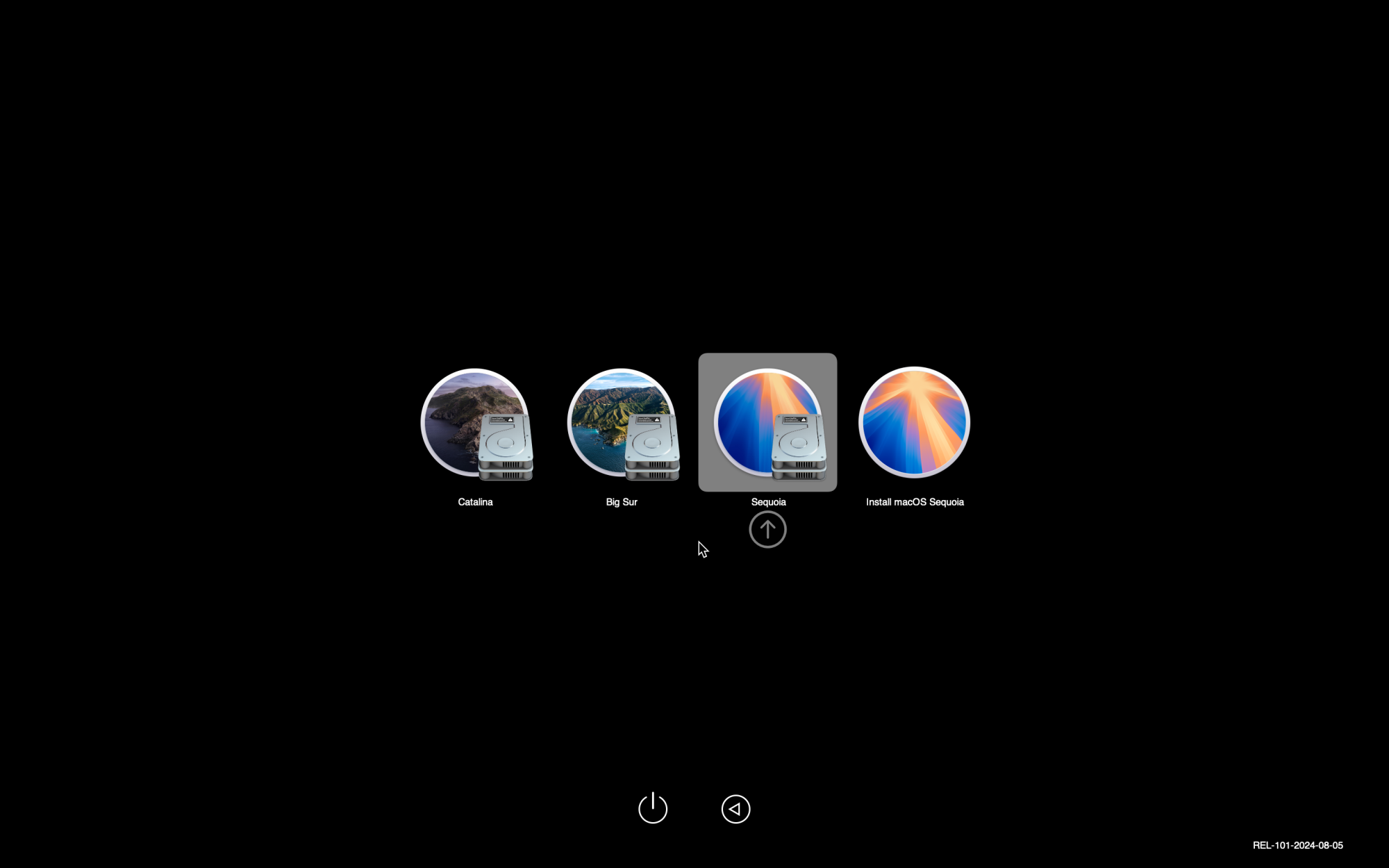

On my rMBP10,1 I have a 1TB SSD and keep Catalina, Big Sur partitions together with Sequoia. That way I can boot say Catalina if Sequoia screws up. I also added a small 20GB HFS partition that I use as an "Installer" Drive instead of using USB.
I use Apple's instructions to download and create the bootable Installer (hint createinstallmedia method) on that 20GB drive. Once completed I see this in OpenCore bootpicker:
Then simply select and boot the "Install macOS Sequoia" partition to install over the existing Sequoia.
The install process is much quicker than installing using USB.
When there's a new update just overwrite the Installer partition with the new update by downloading the full OS and running the createinstallmedia command.
You can use OCLP to download the OS.
But OCLP will not allow you to create an Installer on anything other than a USB (shame...a big omission IMHO).
